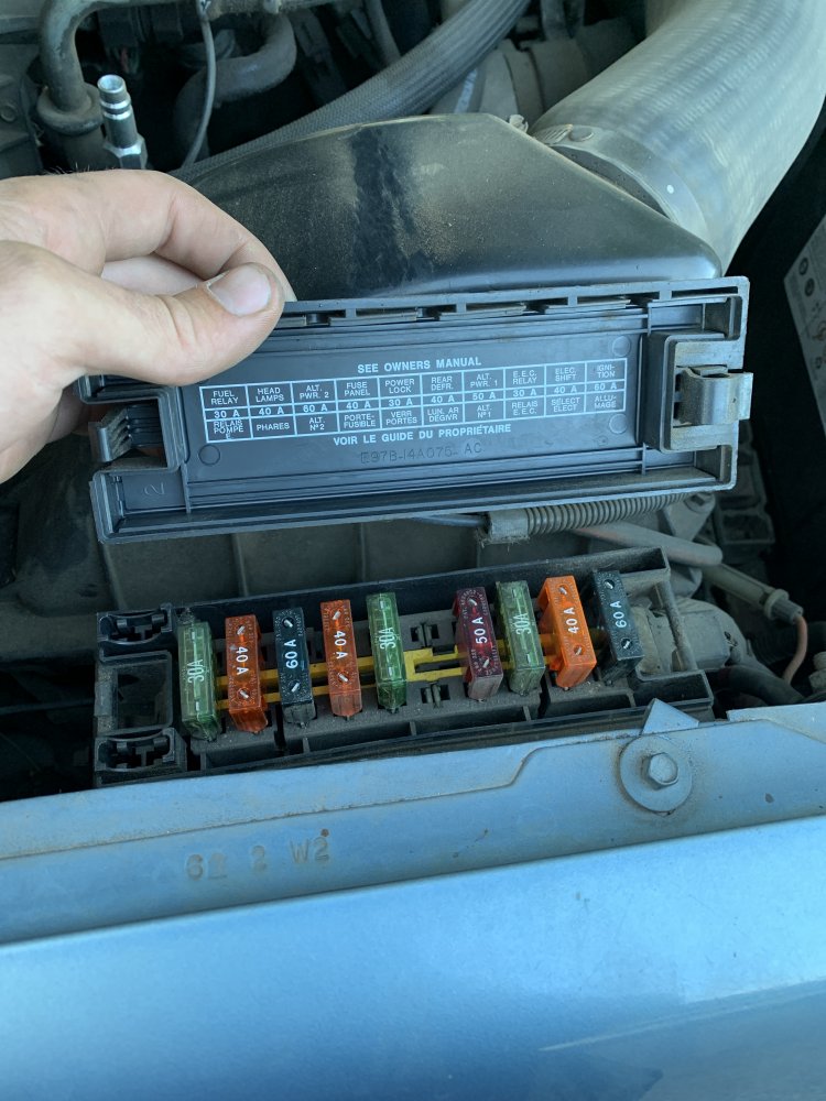

I’m missing a fuse in the engine bay. No 20 amp. Could that be it?
  • 89 2.9 auto trans 4x4 won’t do anything. No lights no clicking, no anything
No, it looks like the 40 amp fuse is for ELEC SHIFT, test it
2nd from right
