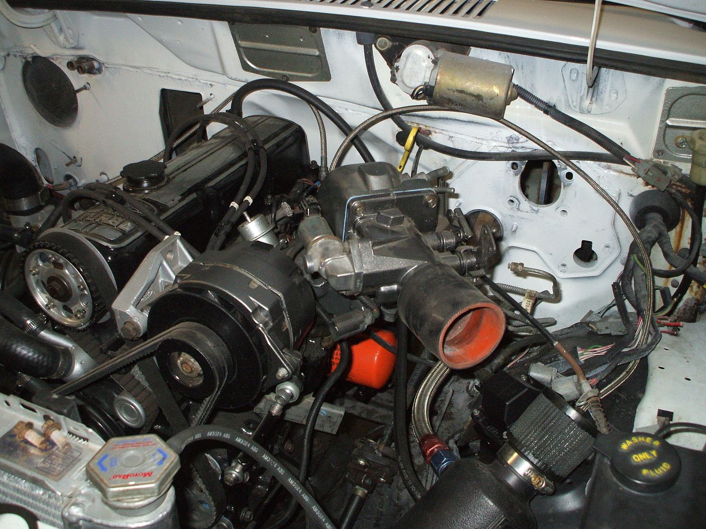

I was really hating the red MSD wires and coil so I replaced them with some black Ford Motorsport wires and blacked out the MSD coil. I pulled the heaterbox back off to make more clearance for my downpipe and laid some reflective heat tape on firewall near the exhaust.

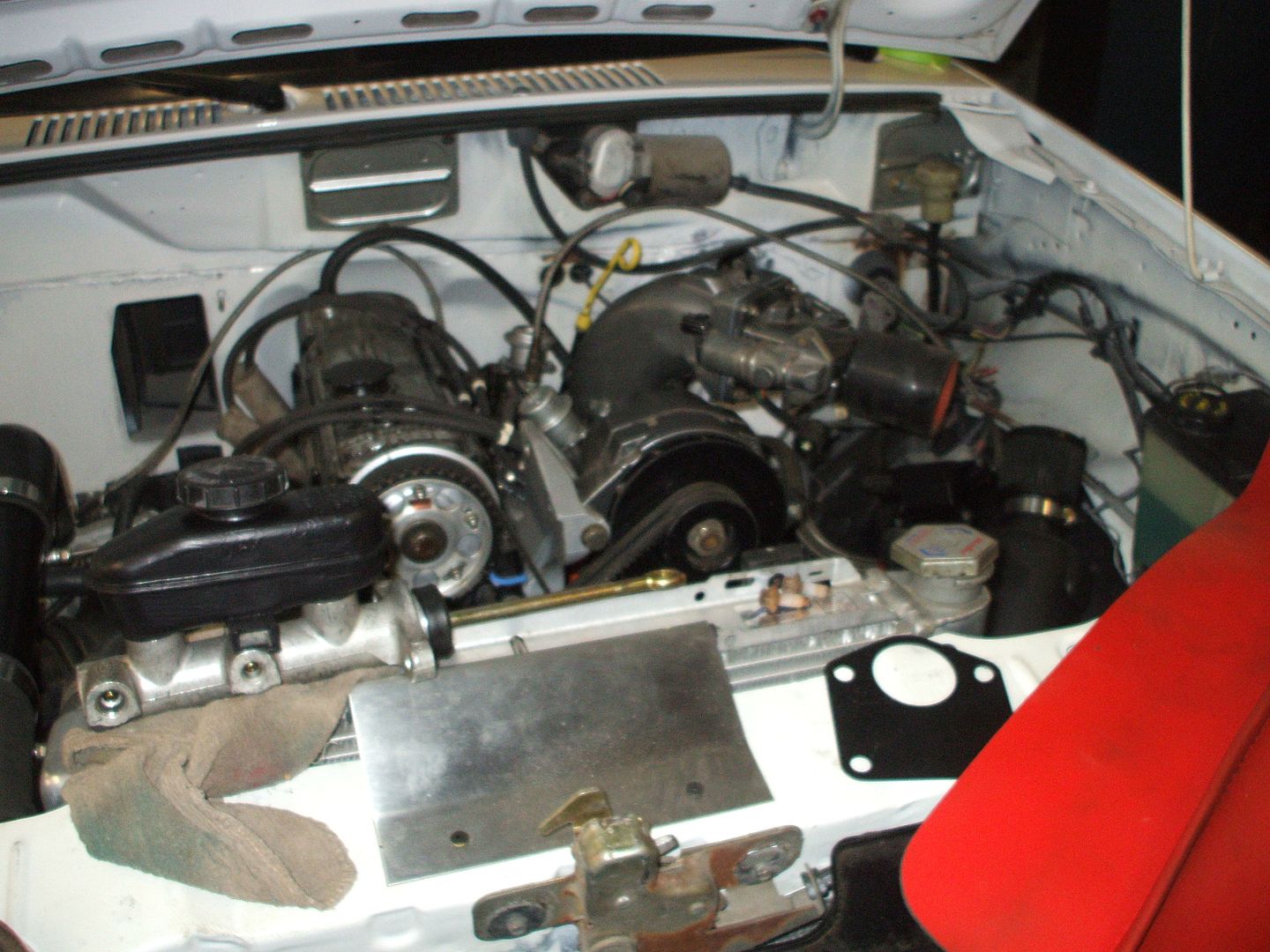

Got all the power brake crap off and almost finished the manual swap tonite. I found out the TurboCoupe clutch master wont bolt to the Ranger firewall so I need to go buy a Ranger master tomorrow then I can finish plumbing the clutch.

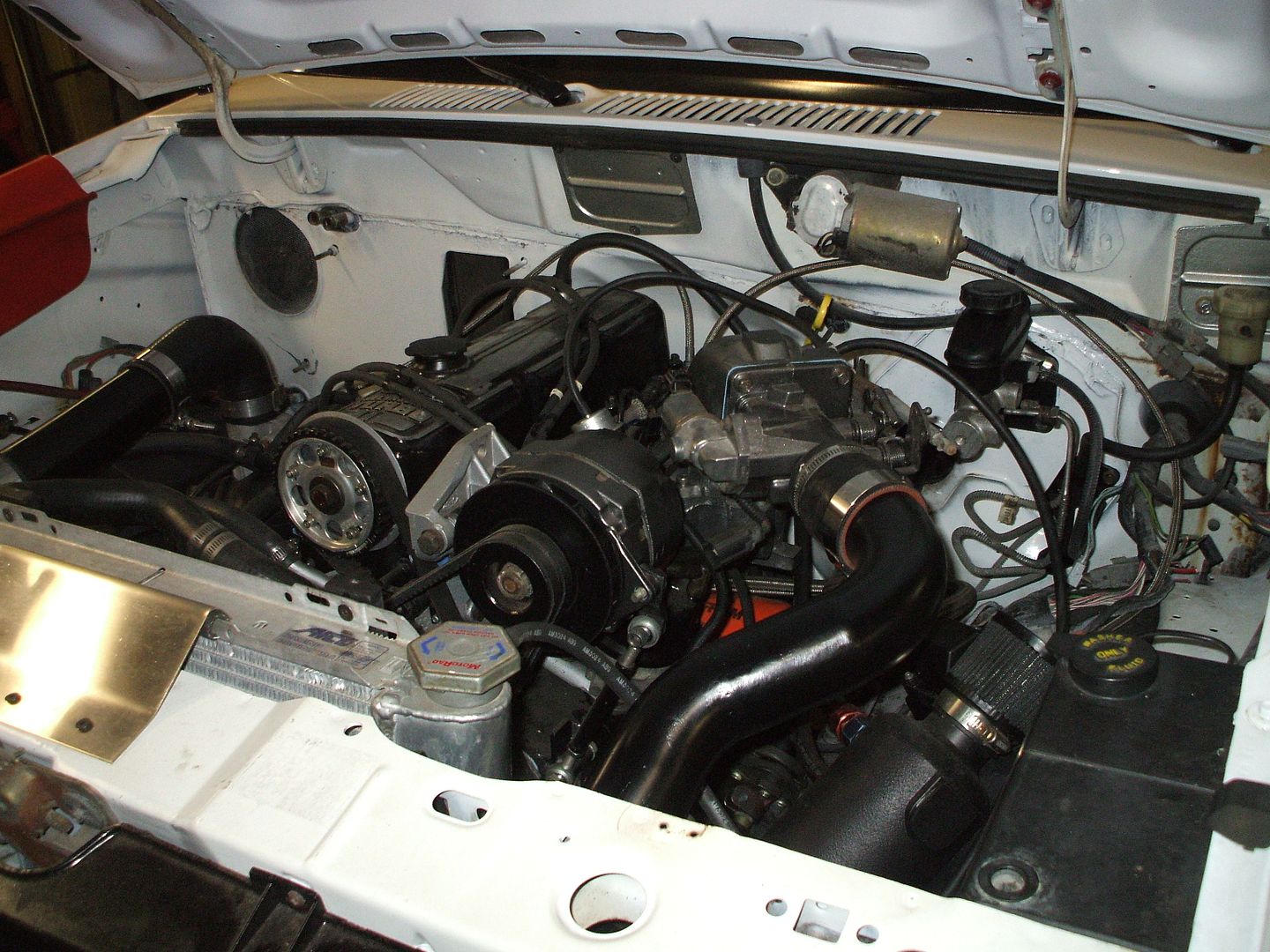

I finished the intercooler pipes and BOV. Turned out pretty good I think. BOV outa sight and out of the way. I really like how it almost looks like it could of came from Ford looking like this.

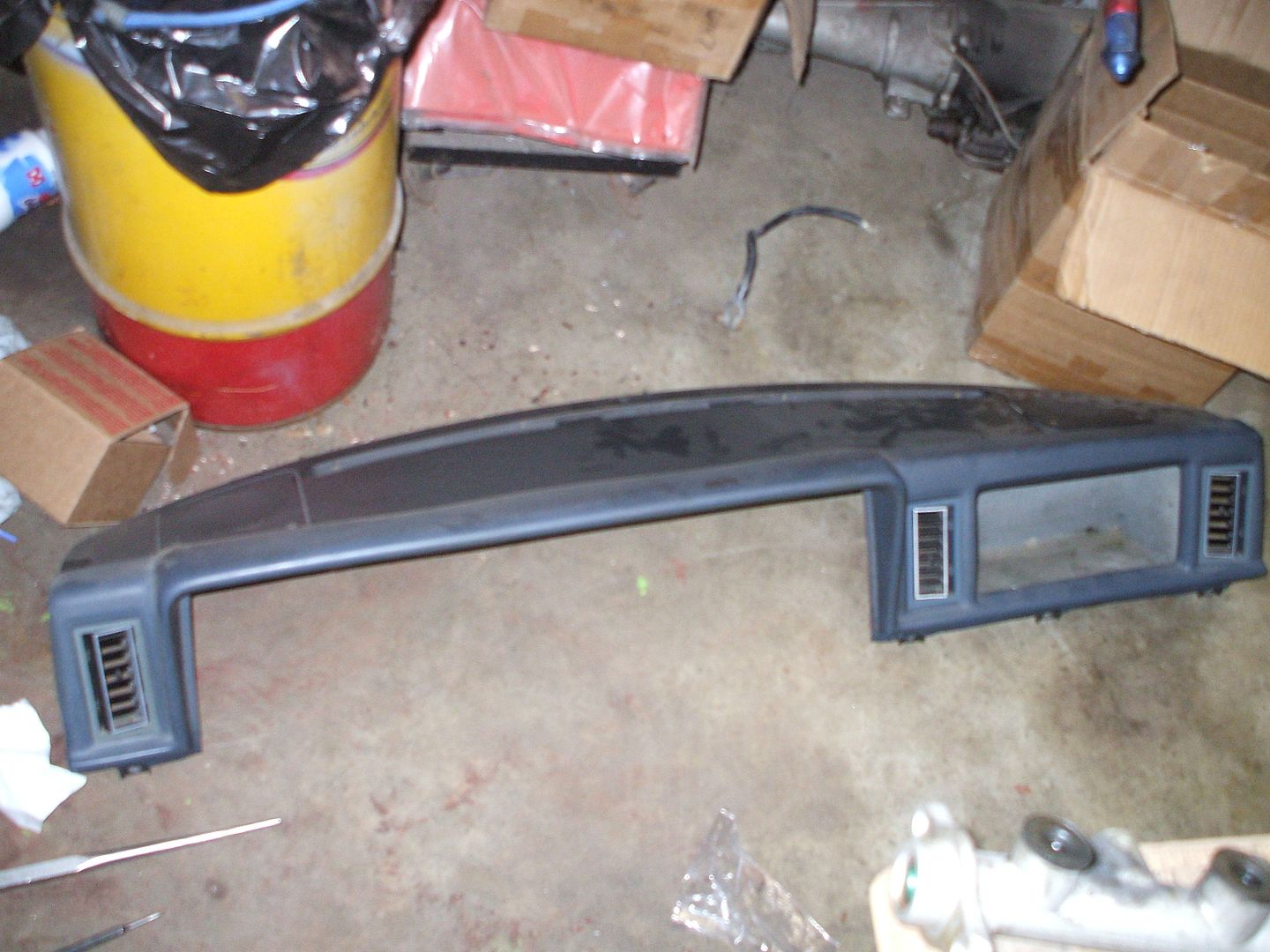

Here is my junkyard fresh mint dashpad.

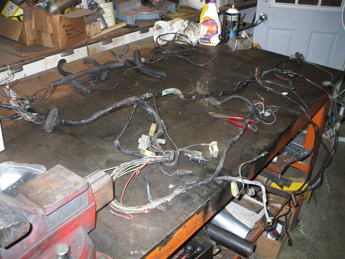

Now todays project.....wiring!
