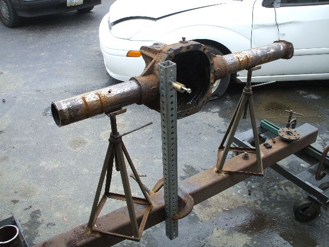

8.8 housing is cut,welded and all cleaned up ready for essembly now too.

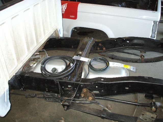

Fuel system is in.Anti-wrap bars are on.

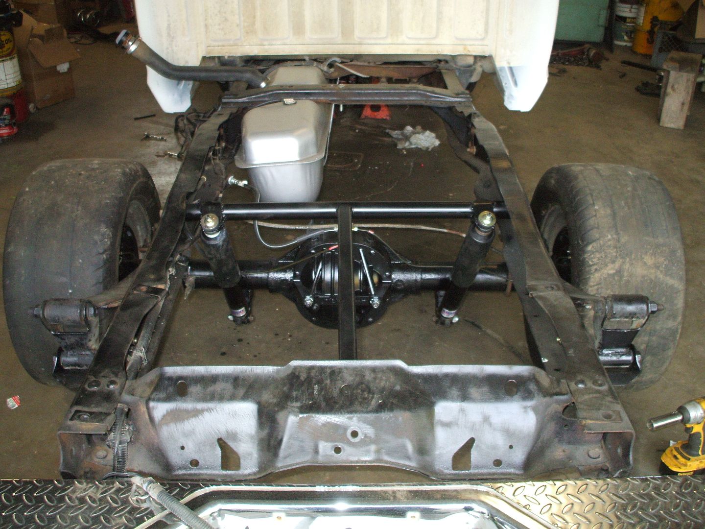

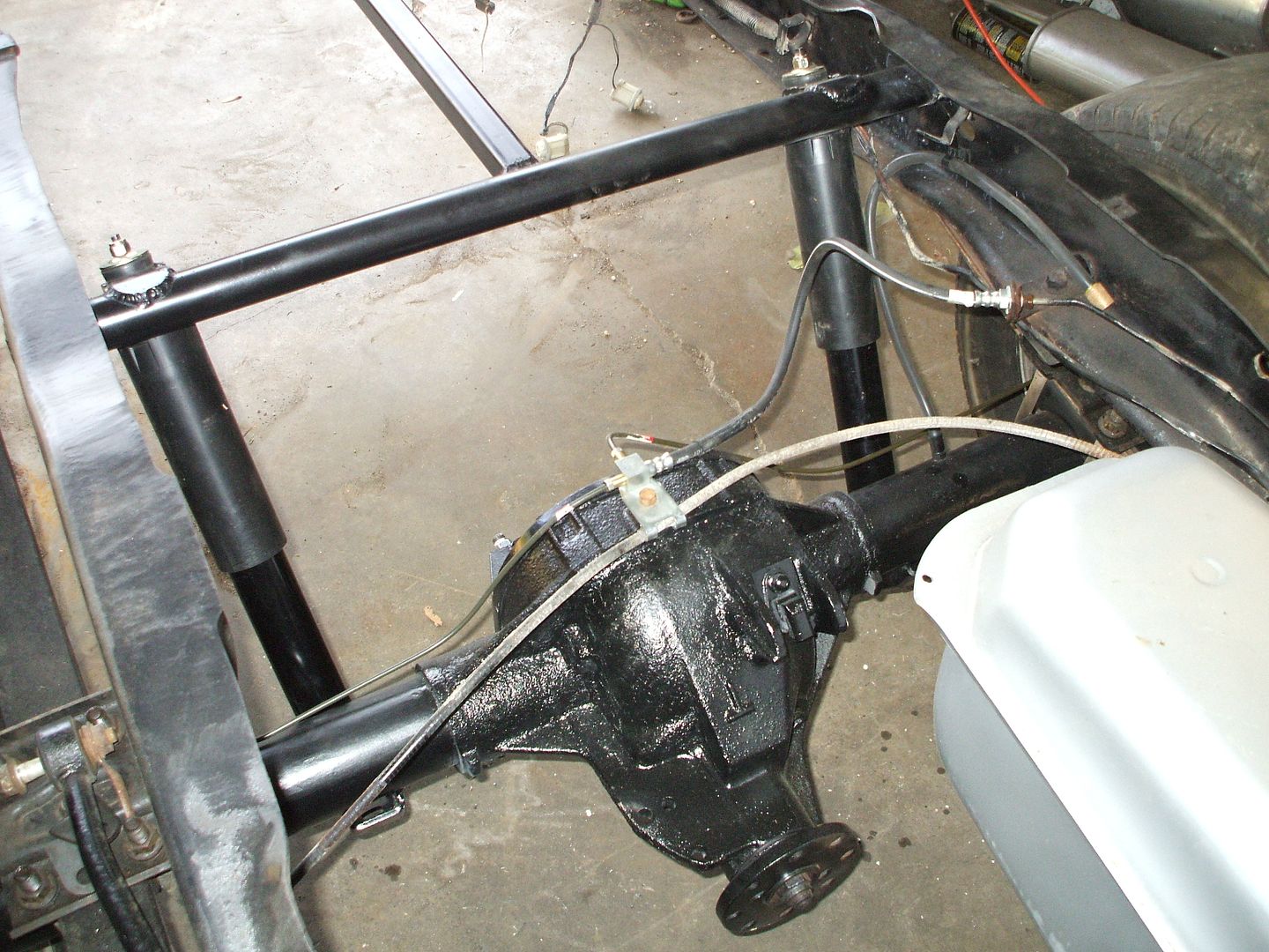

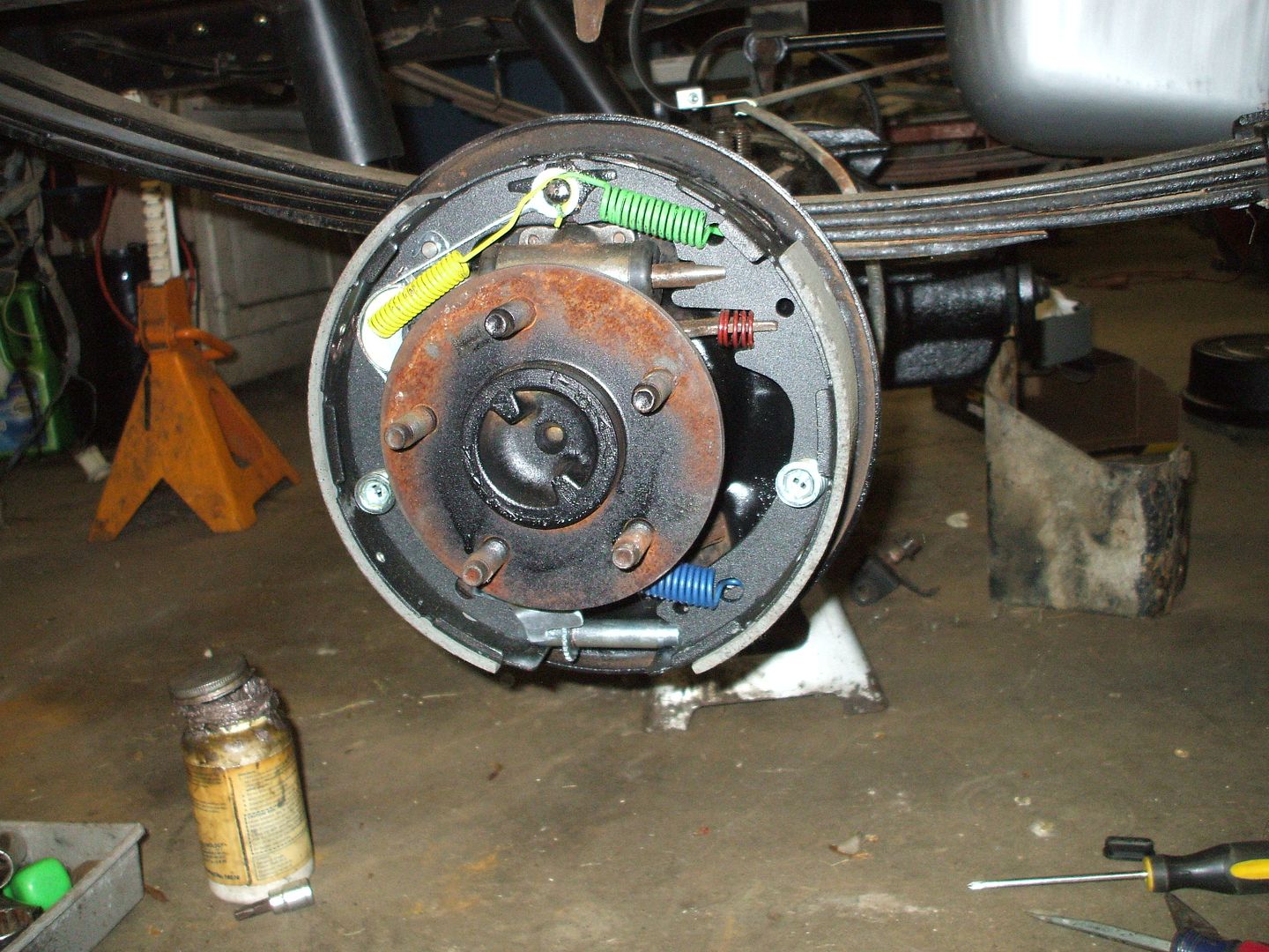

OK....rear axle is finished an under truck now. Here is the break down. Explorer 8.8 with 3" taken out of drivers side tube,using two passenger side stock 31 spline axles. 3.55 gears and a Auburn Pro. All new bearings and races through out and a TFS girdle. Only original brake part is the backing plates. New drums,shoes,wheel cylinders,hardware,adjusters,lines and hose. Even have the stock parking brake cables hooked up and working. Big milestone for me and project cuz now the wheels and bed can go on.
I also made some nice upper and lower shock mounts/tabs to work with my foxbody Strange 10way adjustable drag shocks.
88 Turbo Ranger resto
Ended up with a perfect patteren and .005 backlash.

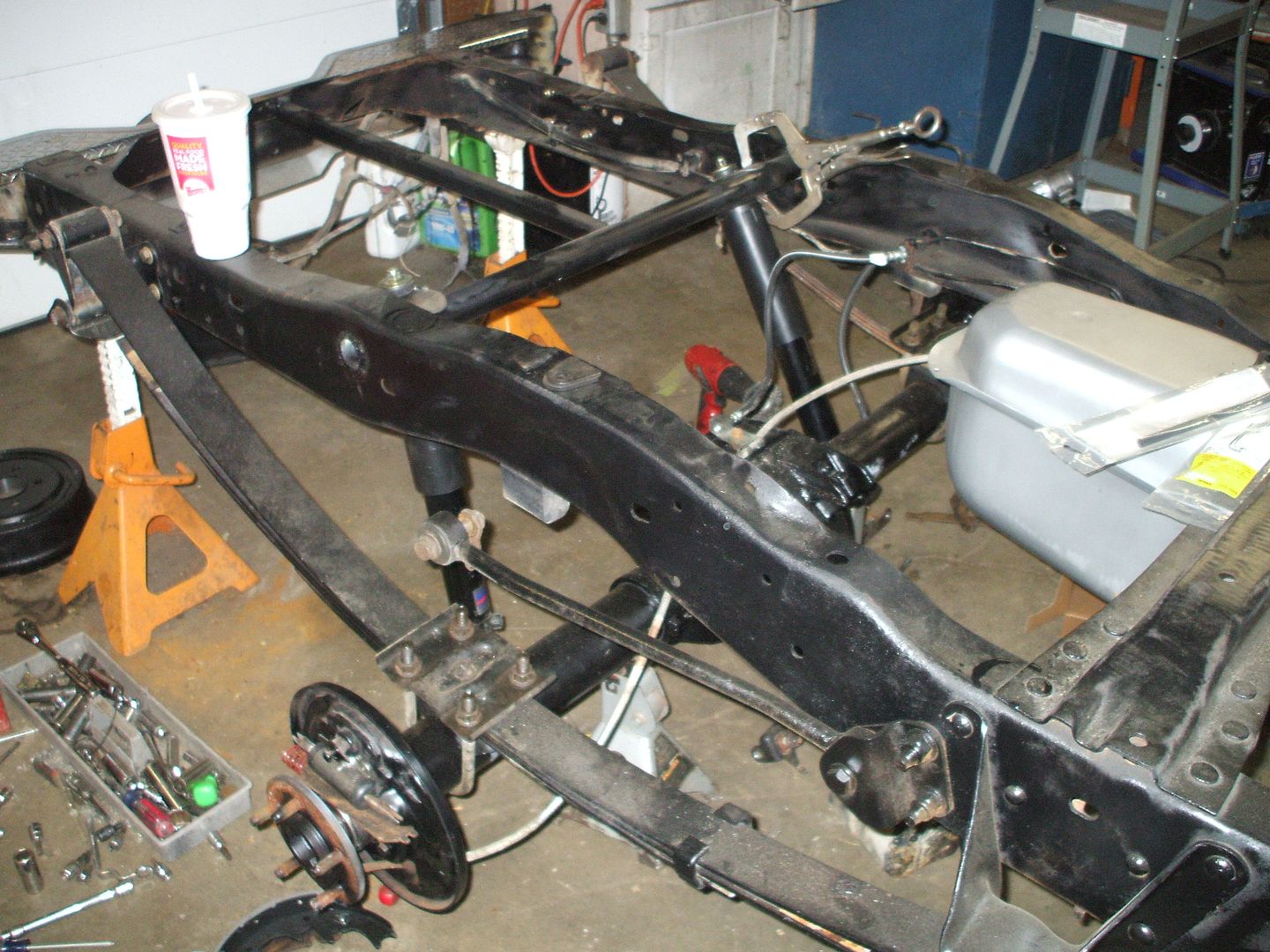

Finishing off chassis today. All new brakes and made all my shock mounts.

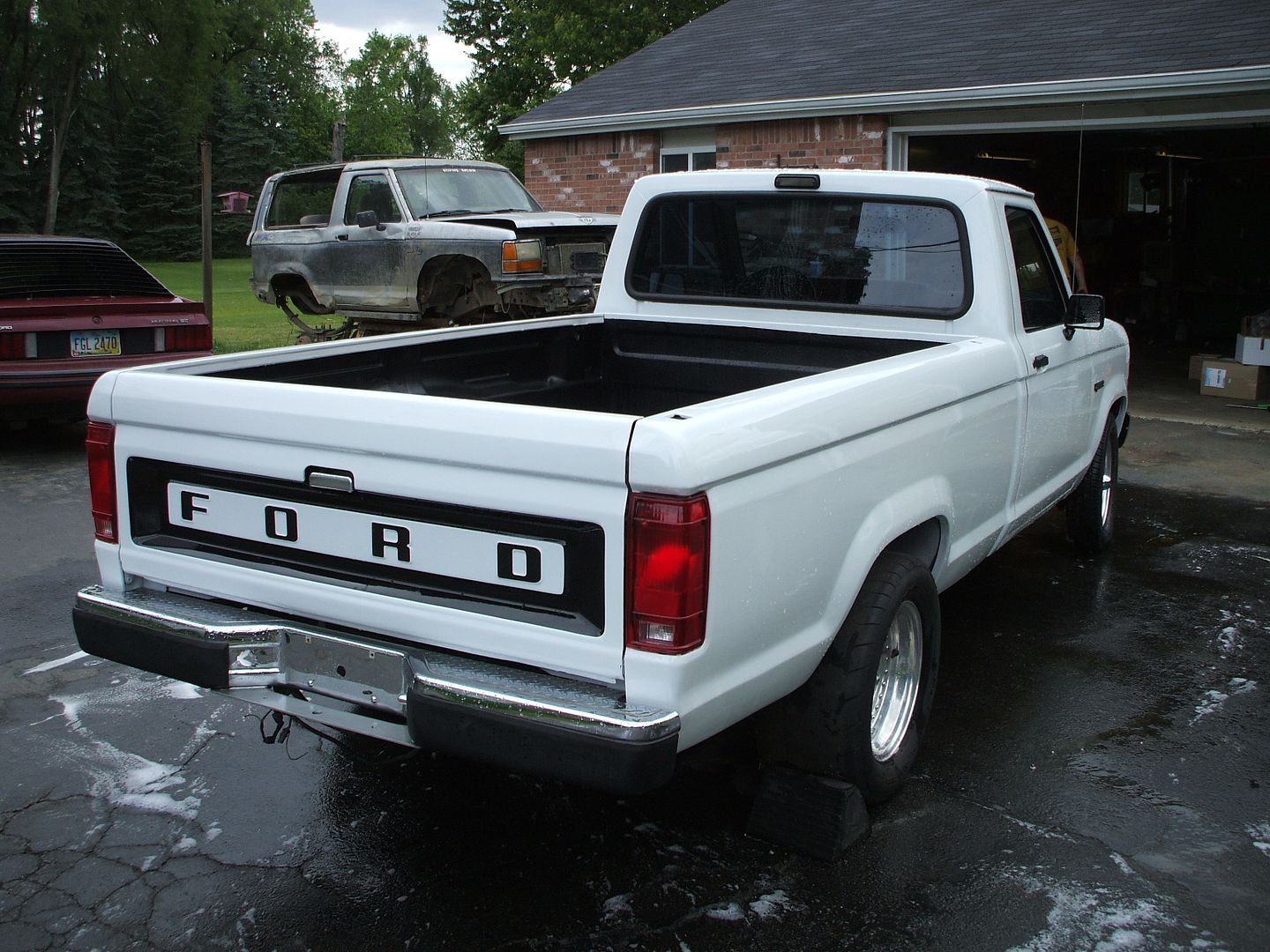

Well rear suspension and brakes are finished. Fuel system done. Bed installed. Pushed it outside to wash it off for the first time. I got wood.
