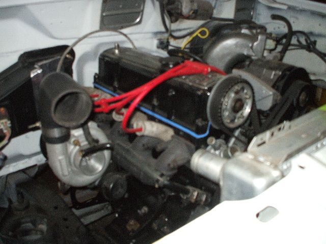

More progress...
Motor is in for the final time. Everything looks good except I didnt cut back my heater box enough so I have to pull that out and re-cut it and my throttle linkage hits the mastercylinder so I may be lookin at converting to manual brakes as well now.

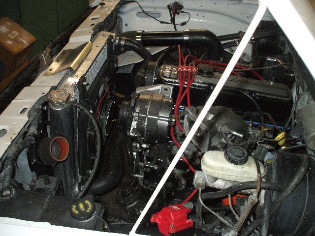

Mocking up the radiator and even found a hose in my pile of parts that fit like it was made for it.

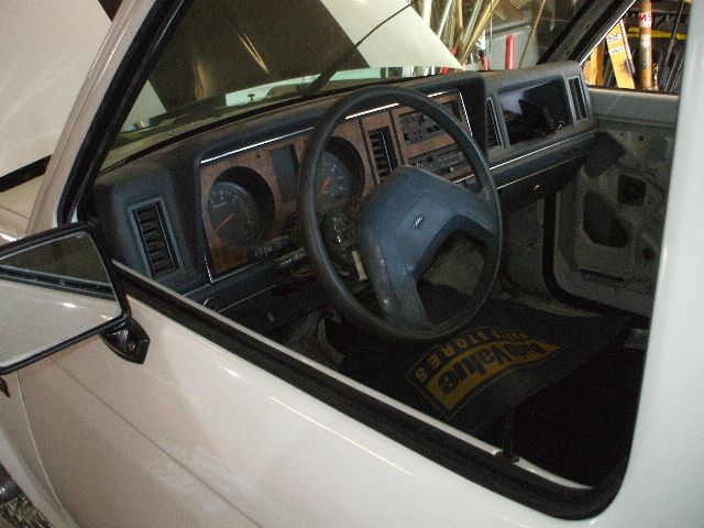

Got all the door and window seals in. Not real happy with the fit in a few places but thats as good as it gets.

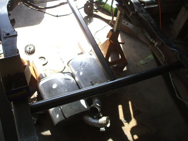

Got the rear frame done and the shackle flip is done so its now dropped 2". yay. I also added the other bar for mounting the mufflers to. You can kinda see in the pix how I plan to hang the exhaust by the way they layin on the floor.

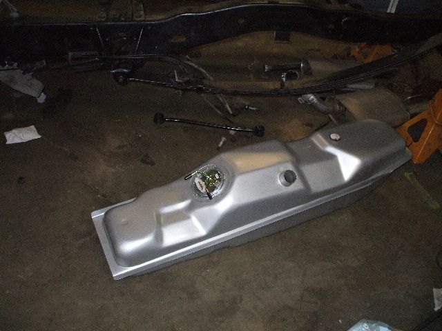

Finish making/routing all my coolant hoses tonite,hooked up boost control, made my own upper and lower radiator mounts,mounted a Flexalite fan,mounted VAM and I got my new gas tank,straps and sending unit ready to install. Waiting on fuel lines to show up then I can hook up the Walbro 255 frame mount and finish the fuel system.
