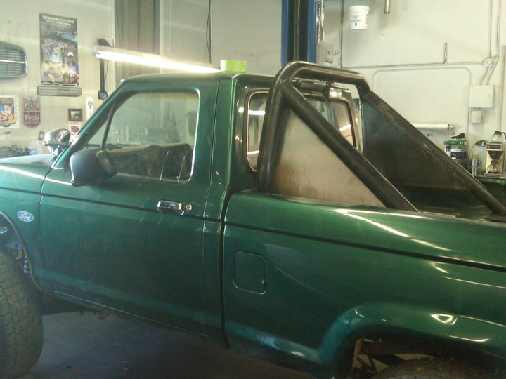

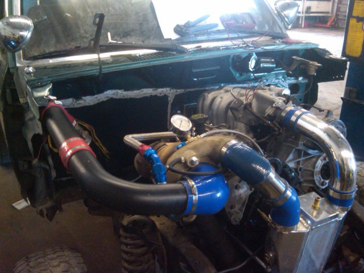

Hello All, 2010 since I last posted my ranger project! so here you go!
Sum It up... 1988 Ranger STX 4.0L Swap from explorer, Coil on plug conversion, 5 speed, custom wiring, explorer eec, T3T4 turbo inter-cooled, 10inch 6 puck clutch, 9inch ford diff 3.73 spool, rear mounted radiator, battery, and fuel cell.

I seen some where here someone had asked if anyone had put a Cummins turbo on a 4.0l. Well I had one on for a bit when my first turbo lost the seals. It was lots of boost at the top end of the RPM range. I needed it a bit closer to the ground. lol

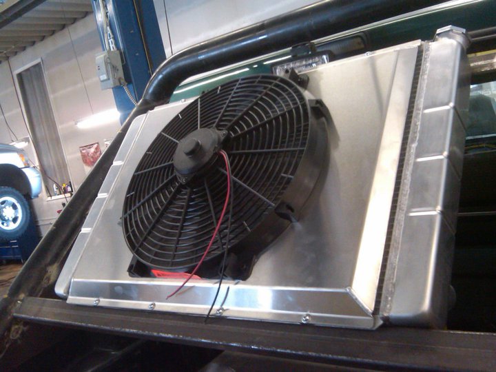

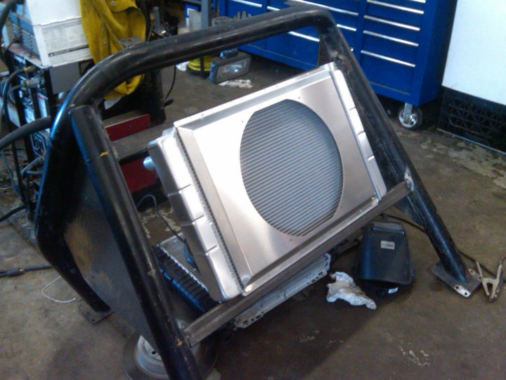

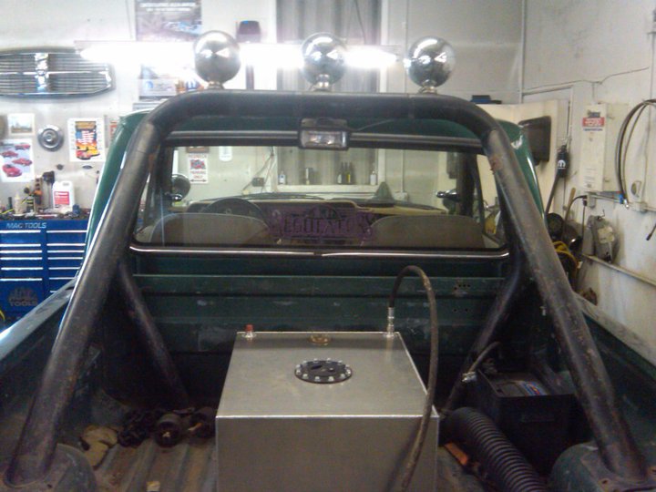

Here a some pics of the bed. Getting How I installed the Radiator and fuel cell. I'll get some new pics b/c the radiator is mounter under the cross bars now.
