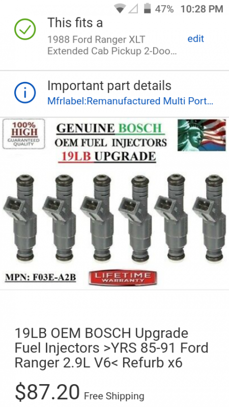

Okay... Well... I installed a new brake booster and brakes now work great.... BUT the syptoms I was having are still the same. I'm really thinking that it may be injectors. When it does what it does.... It's only when warm AND driving. I have to floor it for it to "pick up". What do you all think? Thanks for all the help. I found these injectors online on eBay... What do you think?

Unless you've done work to the heads/exhaust/ignition and don't mind sacrificing MPG for performance, I would get the model number off the injectors and get the same as you already have; which are probably between 14-15 lbs.
