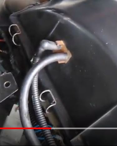

@PetroleumJunkie412 do these vacuum hoses look like they're plugged in to the correct places? I seem to remember having trouble on my old 89 Ranger with these two hoses.. Maybe it doesn't matter?
