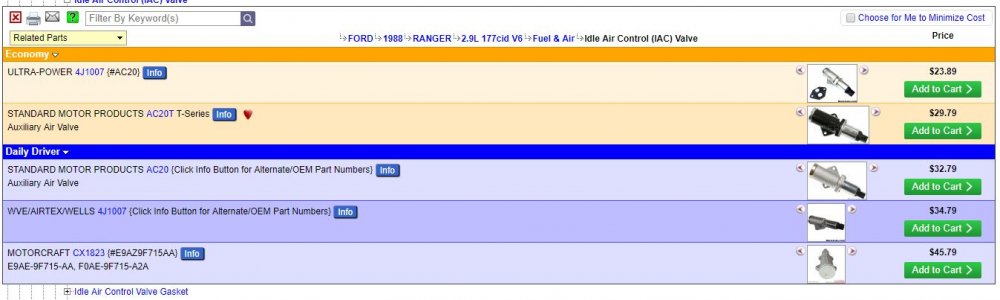

Had a quick look at RockAuto for prices, and I suppose the prices aren't too terrible. There's also a discount code you can use for an additional 5% off. Code: 115246554108459966
