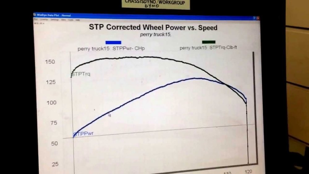

Also as I stated in a earlier thread... There still seems to be a loss of power. It's hard for me to tell because I haven't owned one before but it seems weak. Unless this is just how the 2.9 is.

A 2.9l is a weird engine:
They ARE NOT truck engines. They are a V4 that has been re-engineered into a V6. You have to rev the sh*t out of it to get anywhere. There's a reason yours has 3.73s or 4.10s in the rear end - To translate RPMs into torque.
