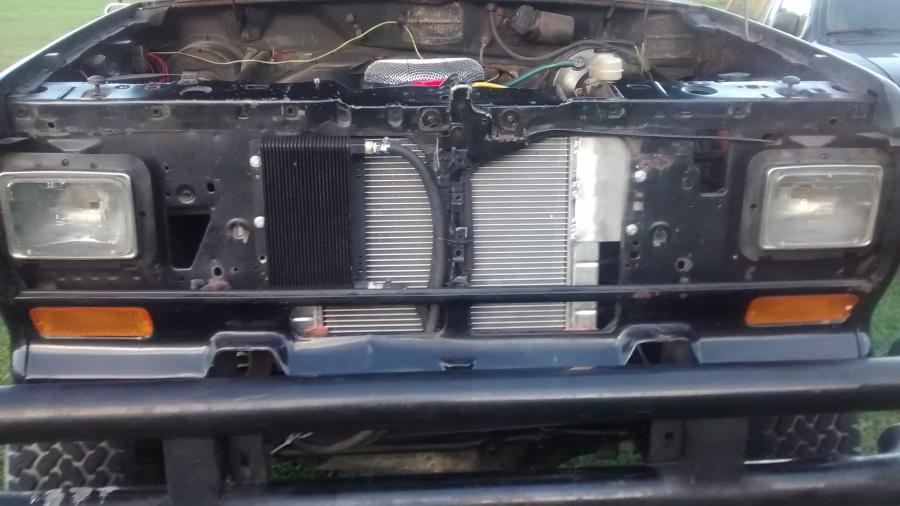

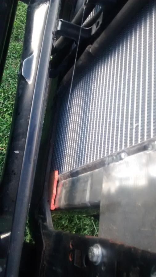

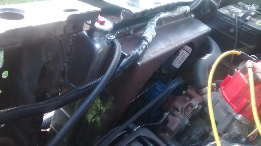

Dam....but heres what I'm working with pics aren't the best but my phone isn't either I guess I could out the lower part of core support and move it out some this is the first time I have ever had a v8 ranger so its all relatively new to me. Reading just a little bit bout ur rig and what you have done its obvious you far surpass me also because I haven't really done this before not quite sure what the right way is I'm doin what looks best.

Goin with a bigger radiator.....
bigger is always welcome when working in this particular size of a space limit.
but your looking to be far enough forward as far as relocation goes, from the pics you did a great job with it really...the shroud is great, though a bit tight for off road abuse.
i think your engine position is hogging up an inch and a half or so that you could go down a bit and back some...just on these pics.
without seeing it in person there are no definitive judgements with what i am looking at here.
from there, a swap out to a sn95 fead or explorer fead will net some space for sure.
if i wanted a mechanical fan, that is the route i would go. full explorer fead and fan. any other setup is a waste of time really.
