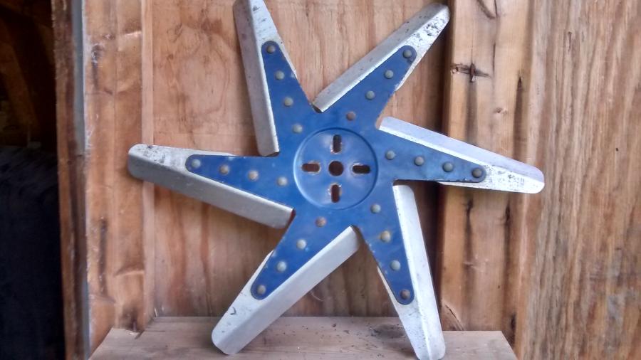

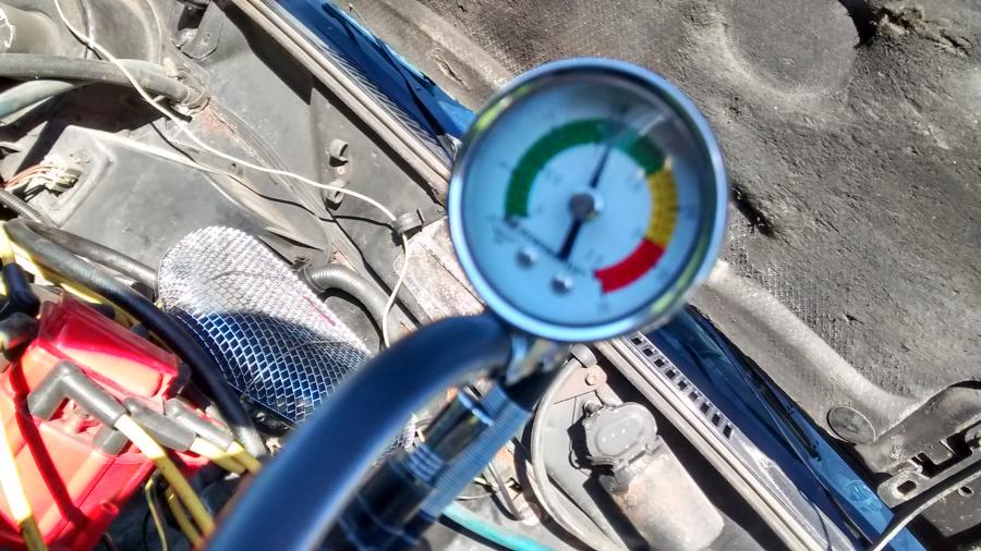

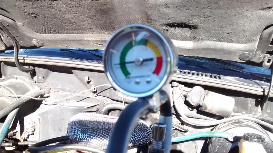

So I did the cooling system pressure test turns out it didn't rip or blow the lower rad hose when I did the test it got up to about 8 lbs and started leaking around the top part of the lower hose where it goes into the water pump I'll readjust it move the clamp and try it again so that why nothing made it into the overflow because it blew the hose way before 13 lbs also here's a pic of the fan style I'm running oh and the pressure guage that was on the testing kit was messes up and wouldn't sit at zero so I counted the marks as I pressurized the system up to 13lbs

I finally got it to hold 13lbs of pressure and just to see what would happen i fired it up let it run with my trusty garden hose close by to spray the rad when it got too hot

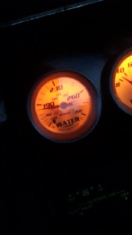

It will now hold 180* for about 5 min then start climbing again :\ so I'll go grab the expo fead next get that setup and grab another fan or look into better options once I gain the room and I have no idea how every one on here makes building trucks look so easy its like tear one down and rebuild it in a weekend.....I must learn this:icon_confused:

Where is it climbing to? 210? Or 230?
It was on its way up to 210 when I shut it down and my trans is makin weird noises in reverse too which really sucks because there's less than 50 miles on it (brand new) I'll have to poke around in that now too:sad:
210 isn't overheating bud. 250-260 is overheating
Alright I'll give it another shot at least this time nothing g shot out of it for once. Also if the thermostat is open all the time once it gets that hot your basicly relying on the rad and fan to regulate temp right or maybe I'm looking at how the system works wrong ???? Because the temp of the thermostat should be where the engine sits all the time is how I'm lookin at it and if it made it up to 210 ish what's to keep it from goin hotter???

i was wondering still if you had the right pump and fan rotation......and that fan is a pos by the way.
