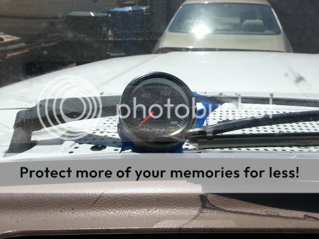

I never thought of that and yes they are wasted and pi$$ me off alot also yeah only carryin like 20 psi of Oil pressure I didn't do the swap so idk much bout motor but after it runs for about 15 min it drops from 35 to 20 and I don't have a replacement long block on a stand for it yet dam right I'm concerned :( but it is on the list and I see how it is can't share the hinge pile:thefinger:
well....depending on pump they can lay down when warm if the bypass is weak.....usually worn bearings are the cause though.
a quick check of a main or two and a rod with the plastigauge can help there.
I think 20 psi on a warmed up old 302 is fine. I was running my Bronco (Full size) with a 302 and it had 0 to 1 psi hot idling. I drove it like that for 6 months and 3k miles until I swapped in a newer 302. Which that one has 20 psi warm.
I agree...20PSI isn't all that bad for a 100K+ 302. If it was 10-15PSI above 2000RPM Id be worried.
hell...if its a 302 5psi at idle is fine....
i dont think i would fawk with anything that had 20.
i assumed it was a 2.9
BTW this was my Bronco running...
Yeah It is a 302 sometimes it's nothing gauge won't barely read looks like hagans pic there but i t also ran hot like 195 * had to small of a radiator hence my fancy dual core after I get the new rad in it I'll try and time it out and get readings at different temps and time and post those too
Is this on an aftermarket gauge?
