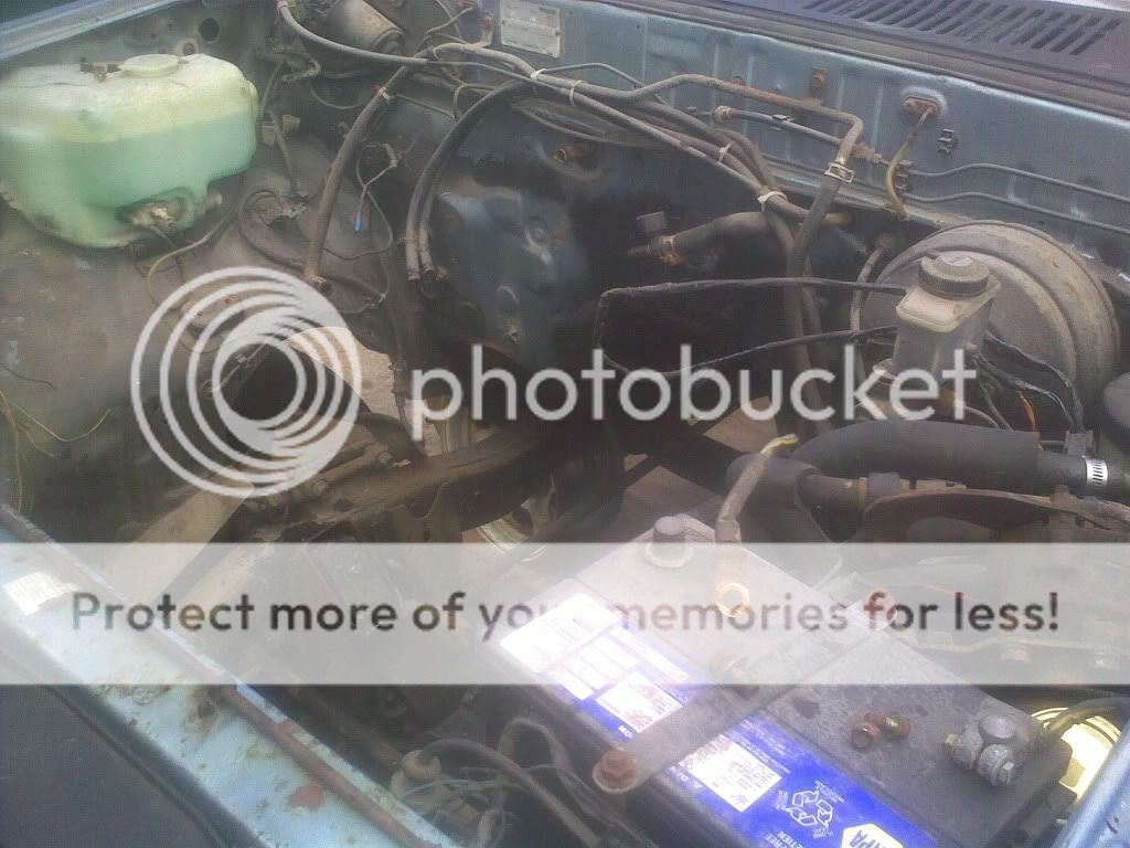

so i have ordered the four link but it is taking some time to get to my house. so i decided to start on the motor swap. i pulled the 2.2 mazda motor and got the 2.4 (22r) up to the house to get ready for the set up.
pulling the b2200
87 mazda sas swap
empty motor bay
87 mazda sas swap

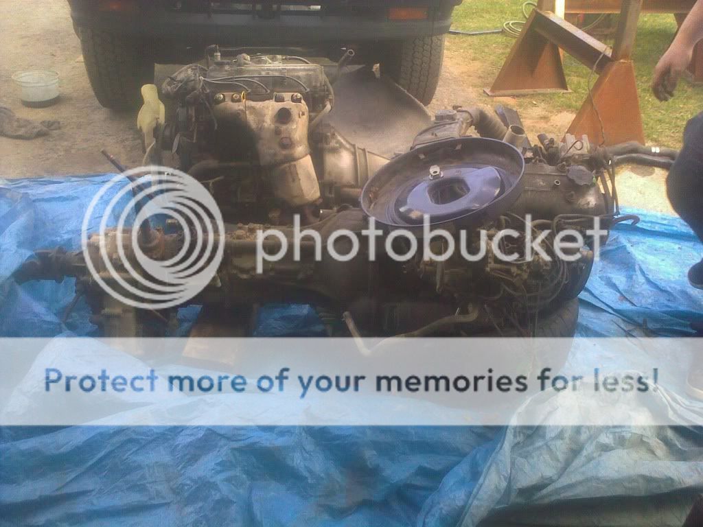

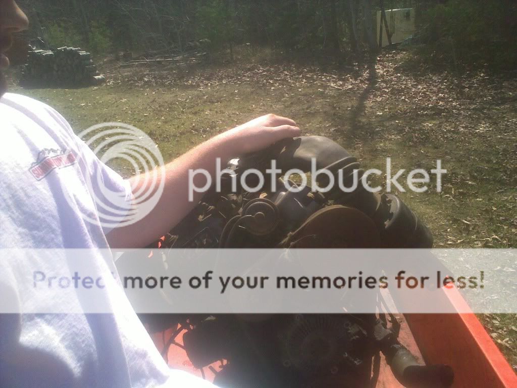

first time the toyota motor has moved in 2 years( in the trailer of the ridding lawnmore
87 mazda sas swap

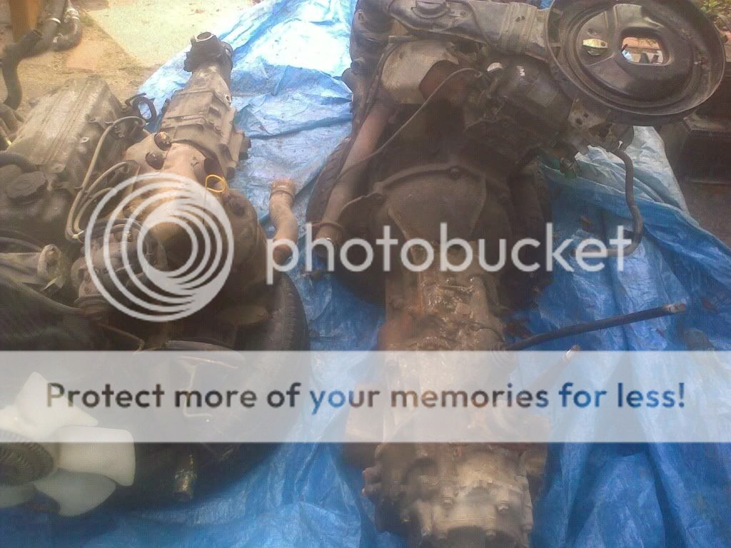

mazda and toyota motors beside each other
87 mazda sas swap

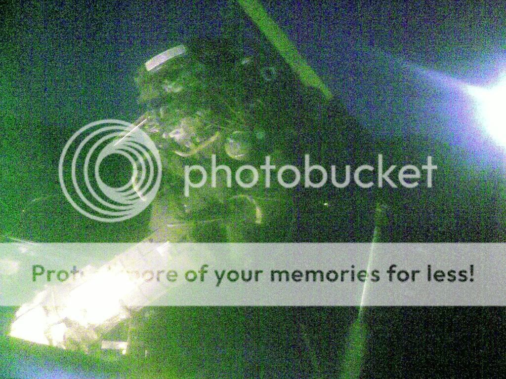

22r in stall

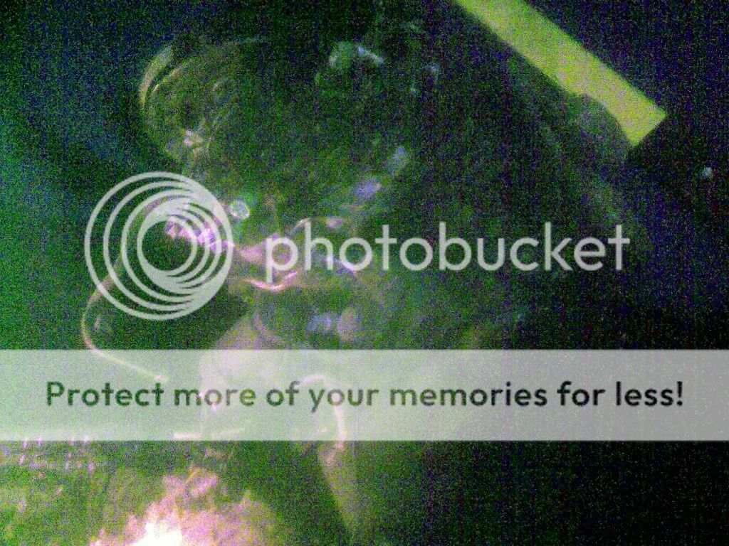

sorry about the crappy photos it was dark out. i have one day off a weekend in stead of spending it with the girlfriend i spend it with my truck

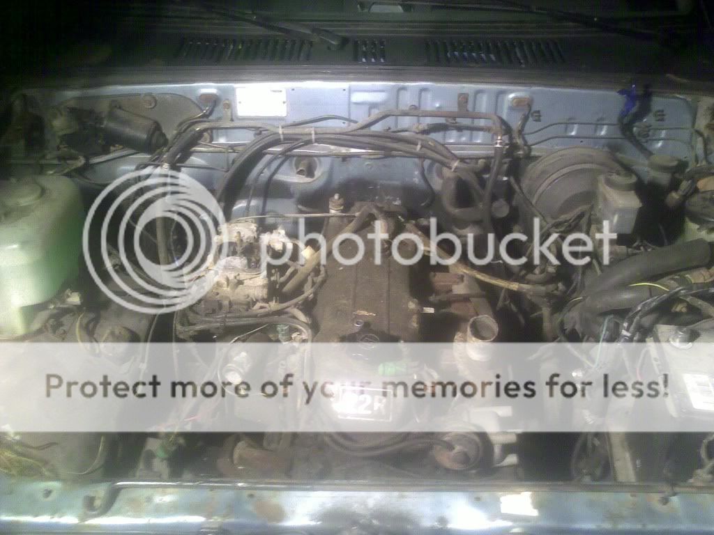

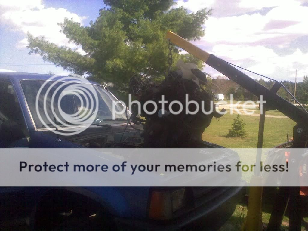

putting in the 22r motor was a little hard by my self but it was done
87 mazda sas swap
87 mazda sas swap

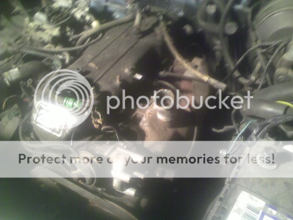

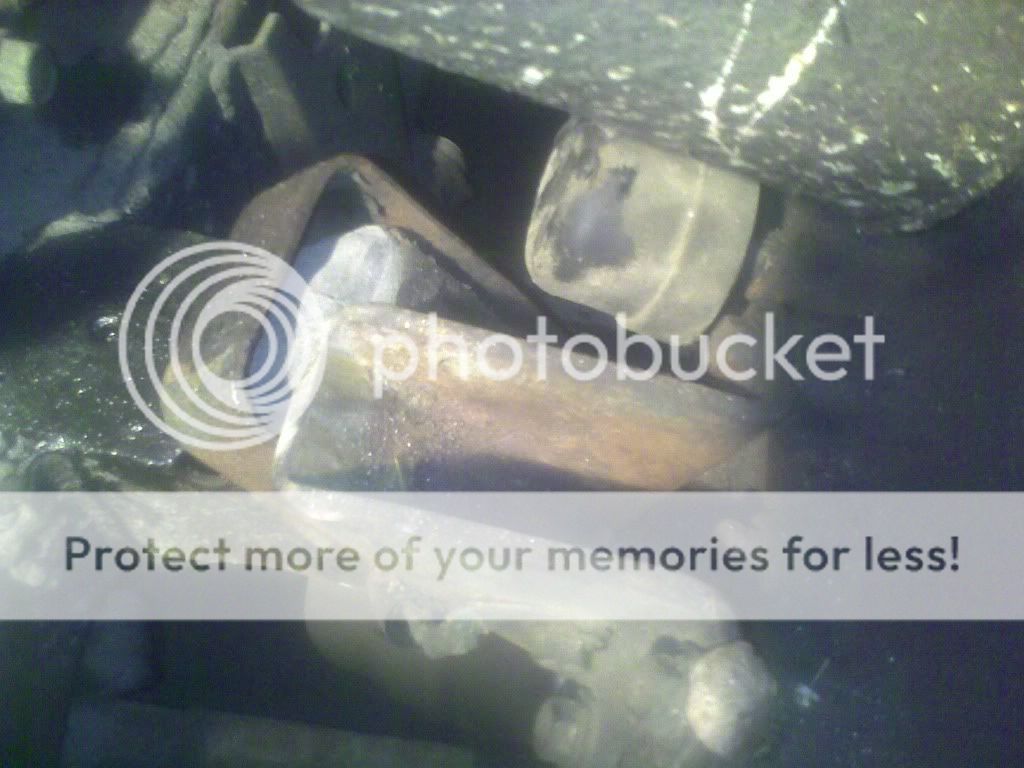

so it was such a close fit the motor mounts were only off by about one inch i will have to mod them to fit in the near future.
87 mazda sas swap
but over all i think the motor looks great in the mazda but it does sit a little low in the engine bay
87 mazda sas swap
87 mazda sas swap
its gonna sit low cause u have a 3" body lift too. but who cares its a lower centre of gravity. (well the motors lower i know the body lift makes his centre of gravity higher)

very true but it just looks too low in the bay i thought i did some thing wrong but it was too dark to see everything i checked it out to day and it is all good

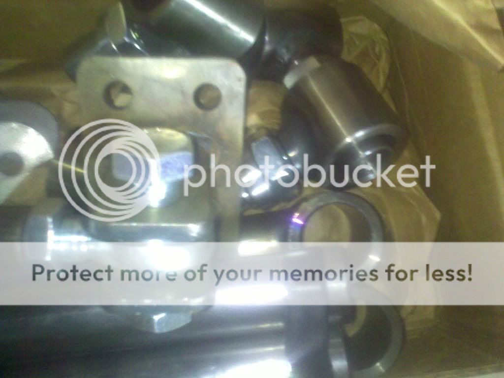

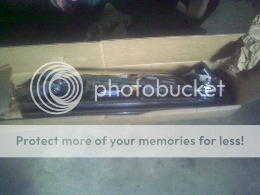

parts are in
so i finally got the parts i ordered in the mail they were from two different companys, one was air bagit,( panhard bar) and they other was sucidedoors.com( 4 link) they look great it was cheaper to buy them then for me to make them
87 mazda sas swap
87 mazda sas swap

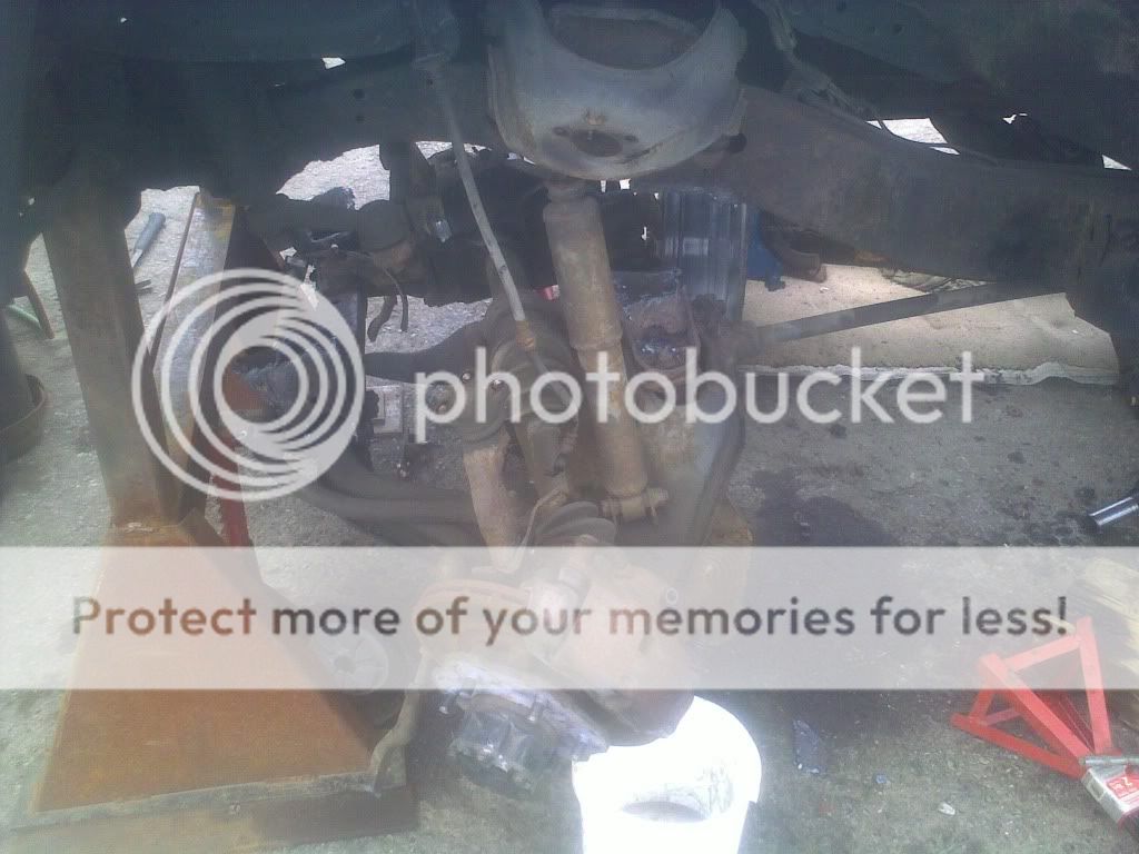

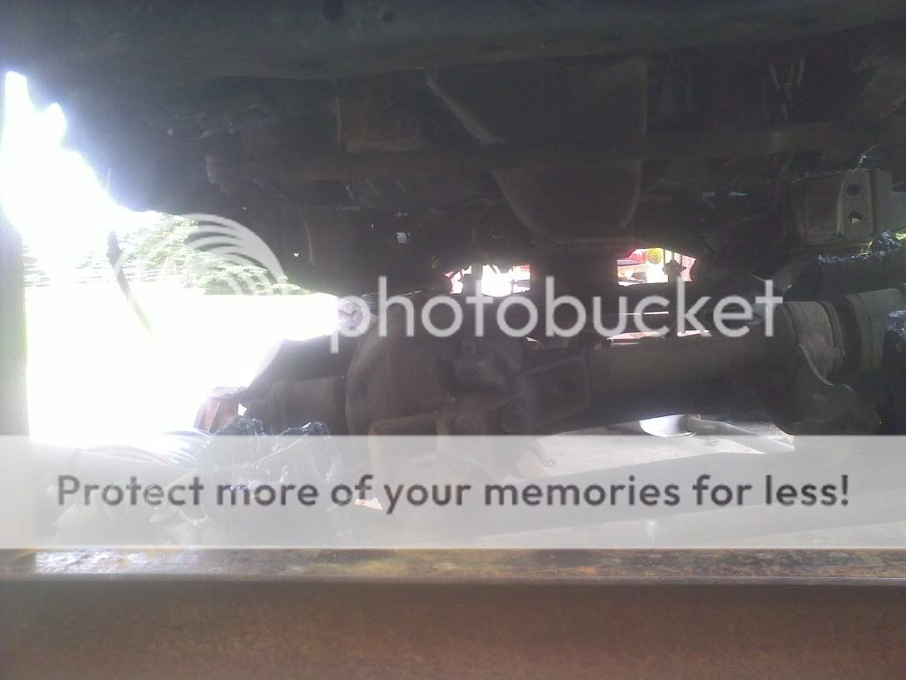

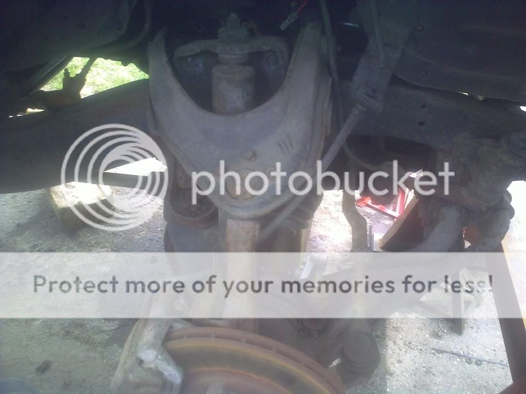

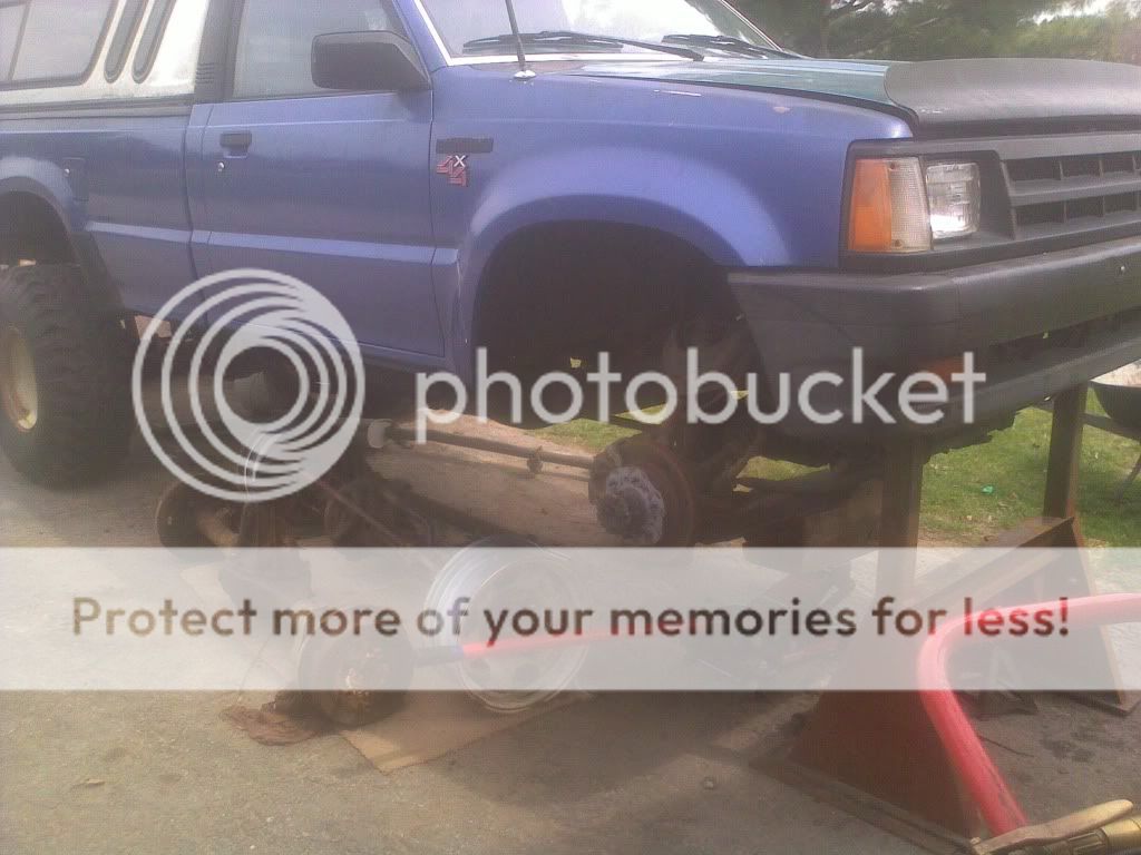

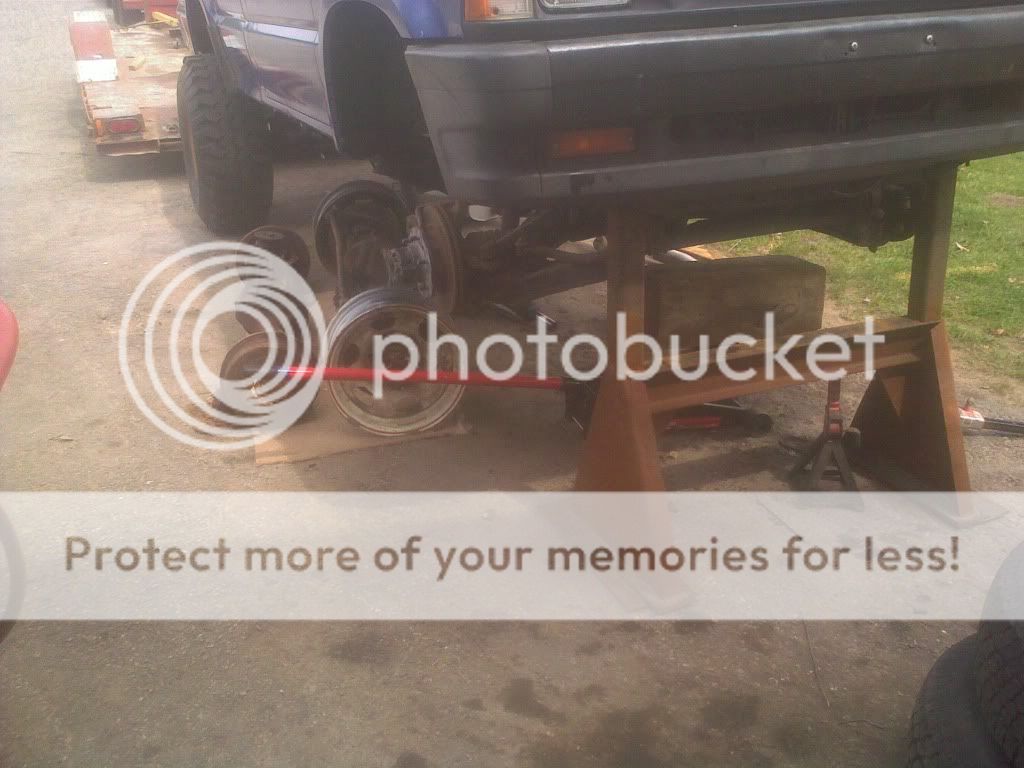

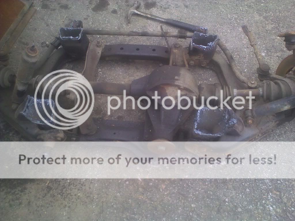

start the front end

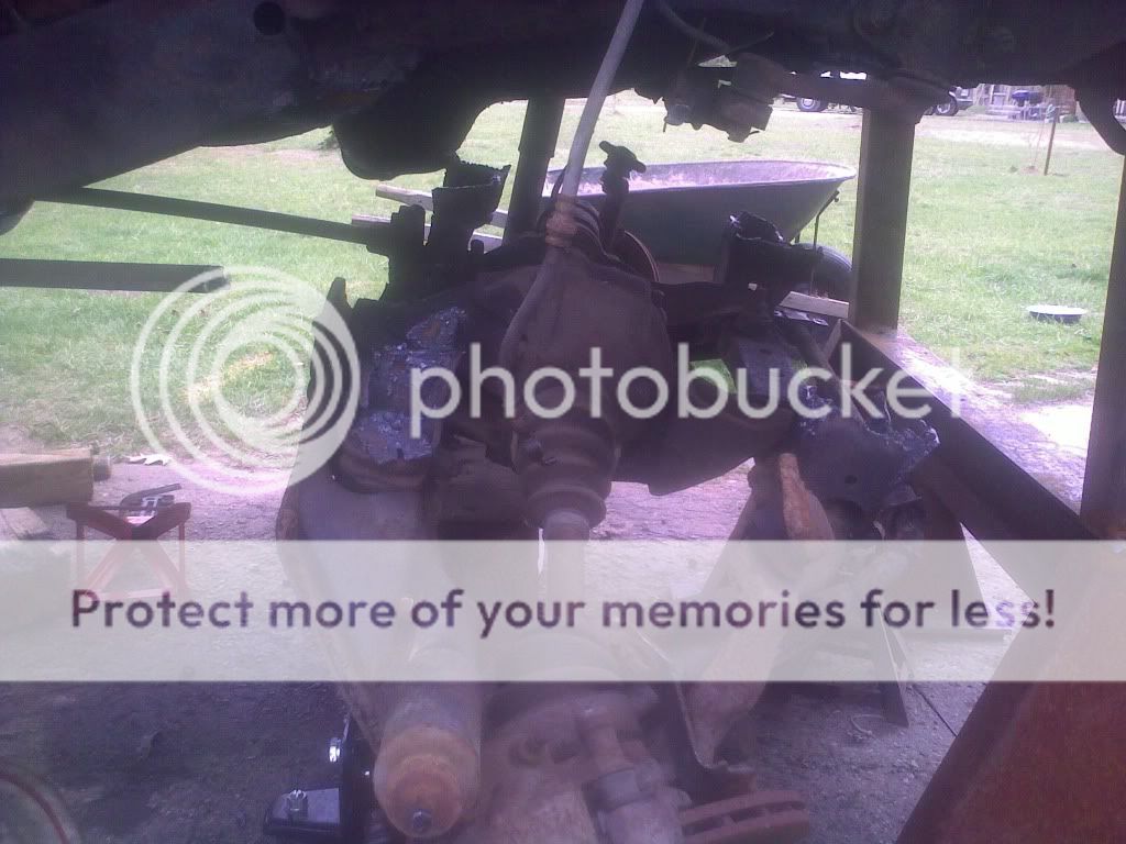

i am still working 12 hour night about 2 hours away from my house 6 days a week but that means i have about 1 hour a day to work on the truck today i took the front end off the truck. no more ifs for this mazda!!!!!!!
87 mazda sas swap
87 mazda sas swap
87 mazda sas swap
87 mazda sas swap
87 mazda sas swap
87 mazda sas swap
87 mazda sas swap
Yaaaa, the solid axle will be so much better looking and stronger too.
Tourch = FTW
really like how the 22R motor fits in the engine bay. everything seems to be in easy reach. how much hp and torque will you get from it? looks like you used the engine, tranny and transfer case from the toy, right? any additional cross-member work needed to mount it all up? great job!!
22r rework
it did fit in the quite nice but there was some problems the stock mazda motor mounts had to moved ahead about 1 1/16 and the tranz mount will have to me modified but is sits right on the stock mazda mount. i just want to make it look nicer. and you are right everything i pretty easy to get to on the motor. but if u notice my ass hole brother stole the fuel pump off the motor.( after it was in my truck )
( he has a 1982 toyota sr5 6 inch suspension 4 inch body but the dumb **** only has 31 ones on it!!!) when he was born god must of stock cotton candy in his head instead of a brain. :icon_rofl:
