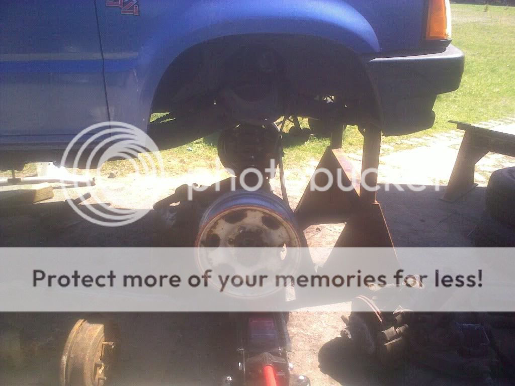

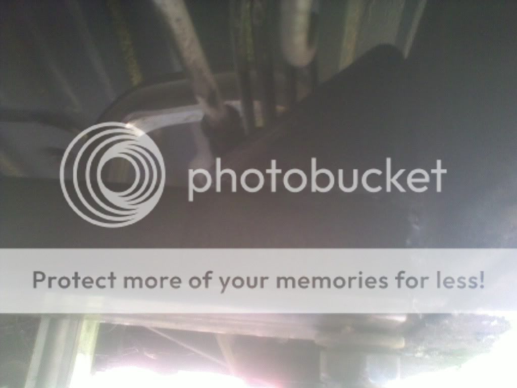

after torching out the ifs i needed to clean up the frame where it use to mount

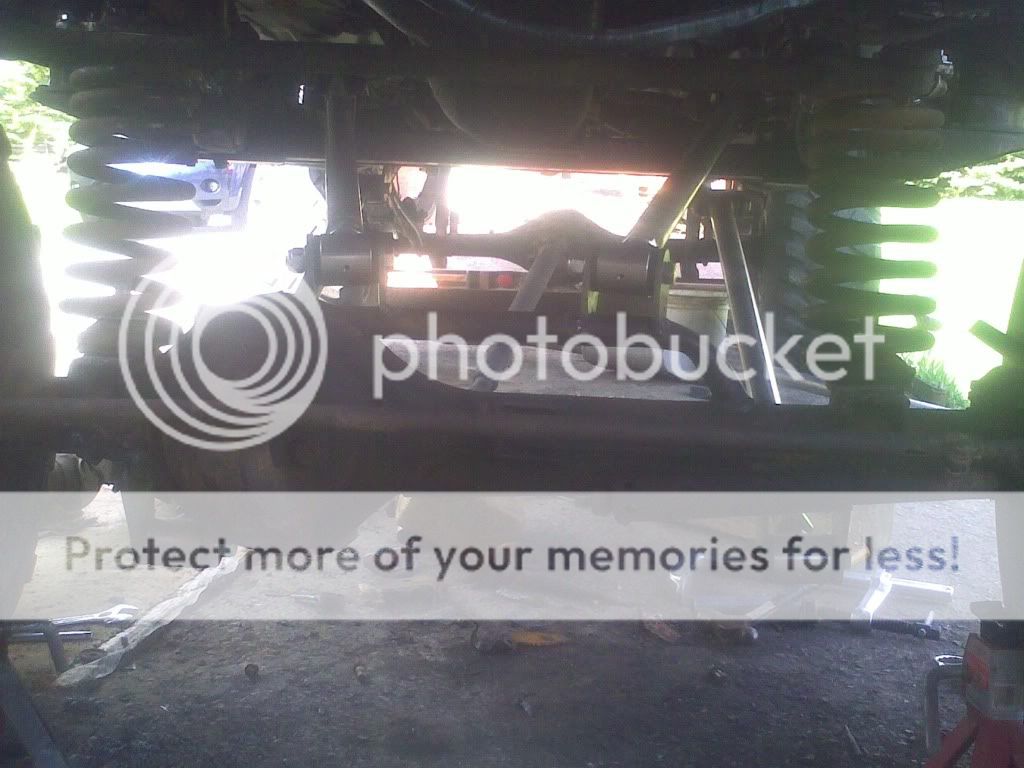

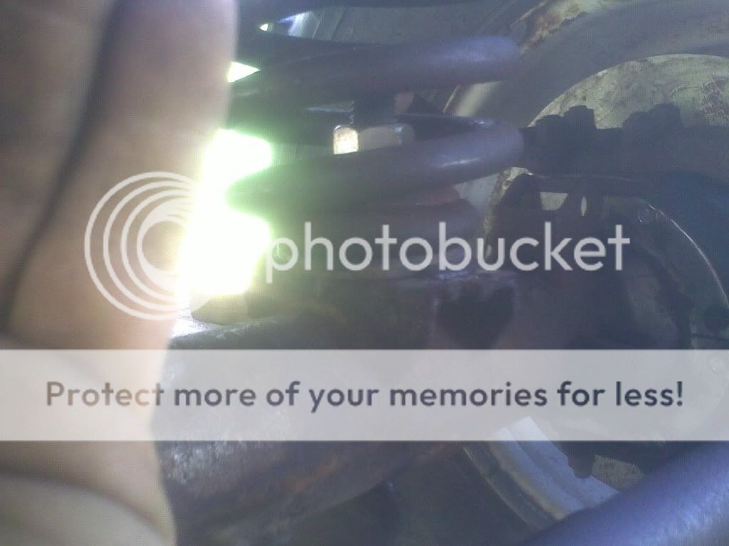

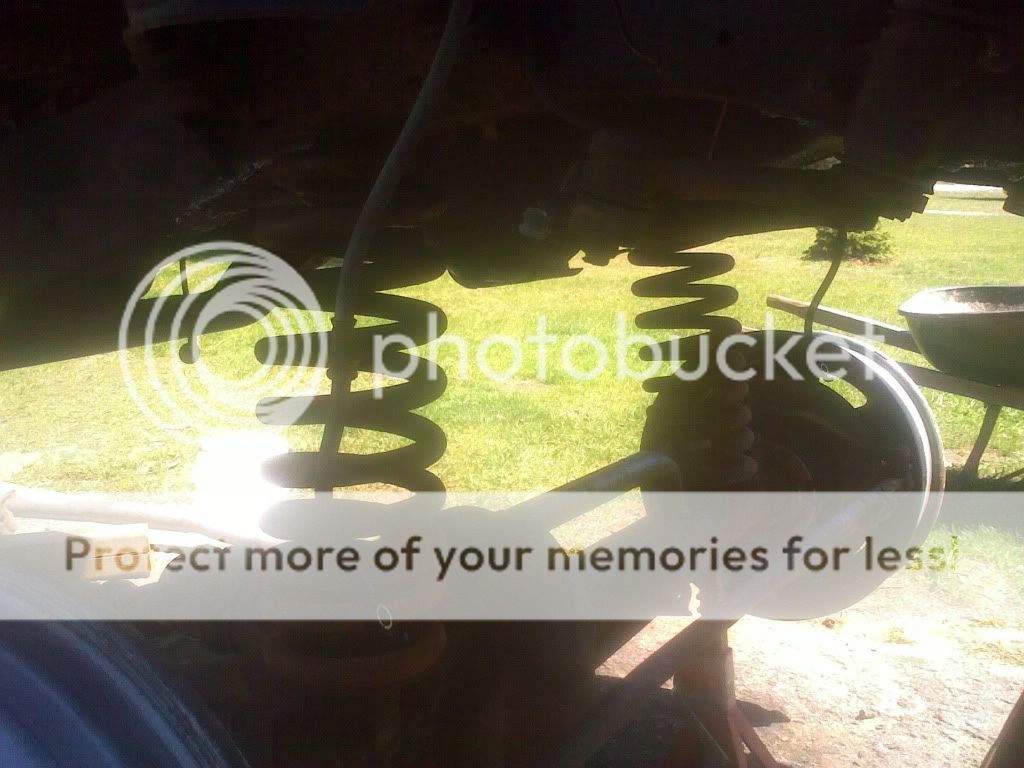

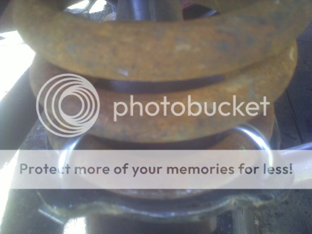

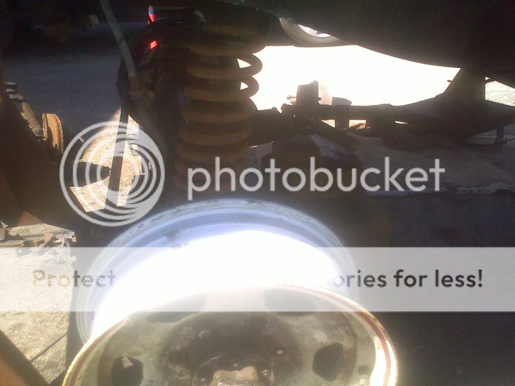

after the frame was all cleaned up it was time to role the toyota axle under and see how it will look. the coils are off a 97 ranger 4x4

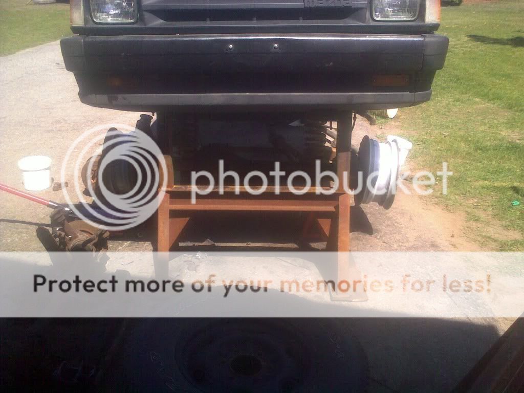

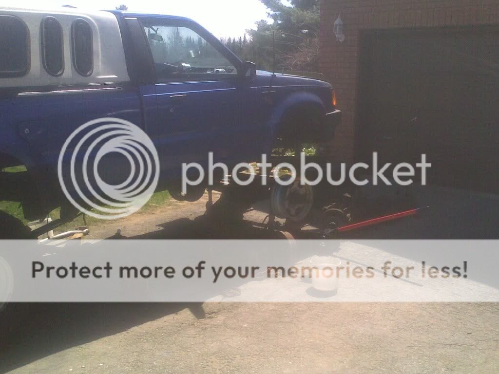

now it is just sitting there it is not the final location for it

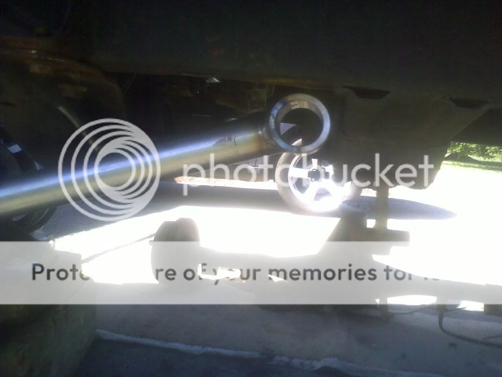

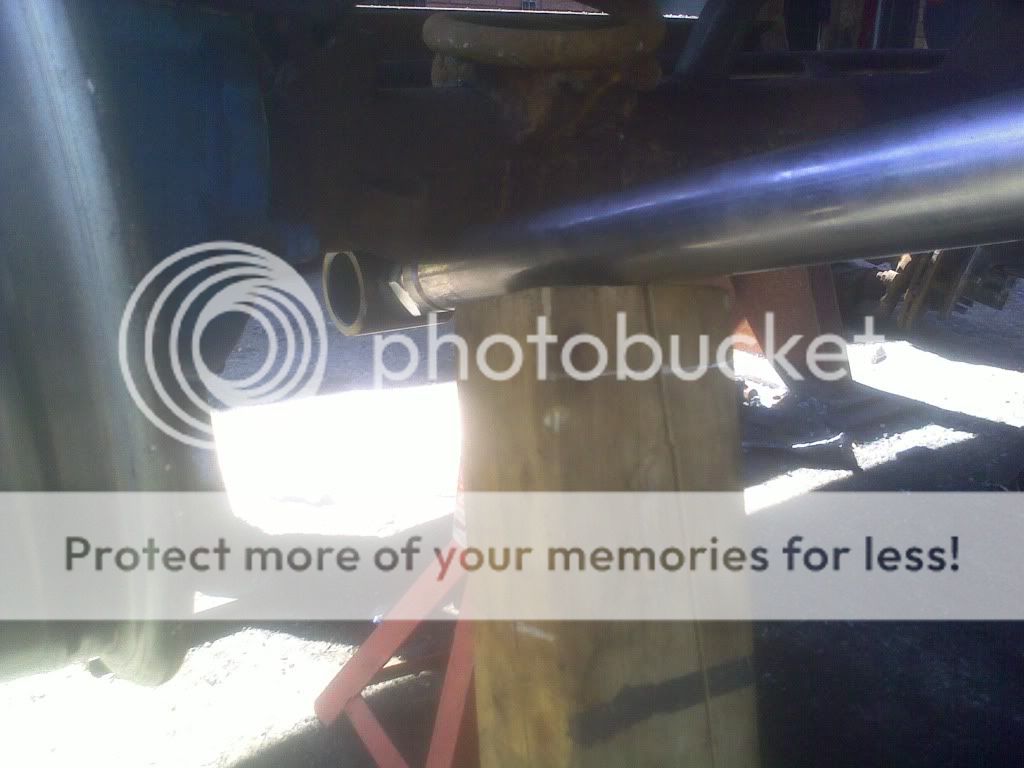

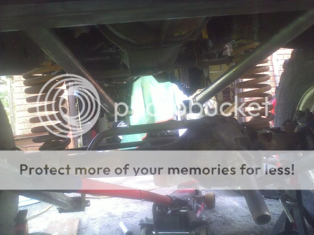

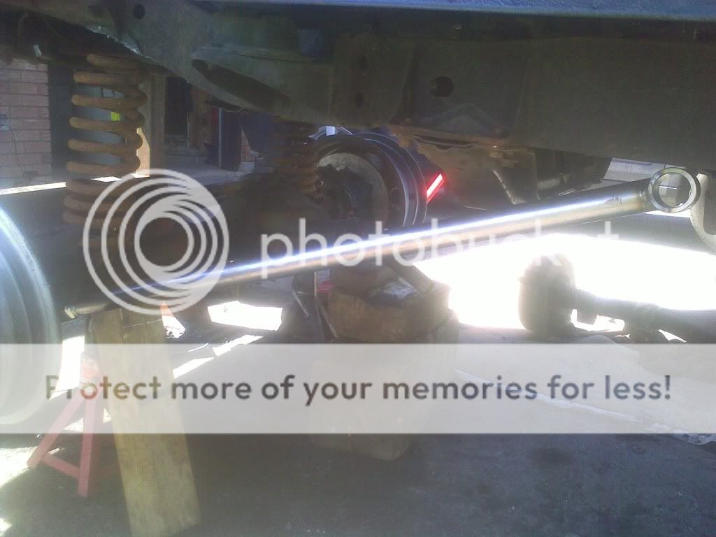

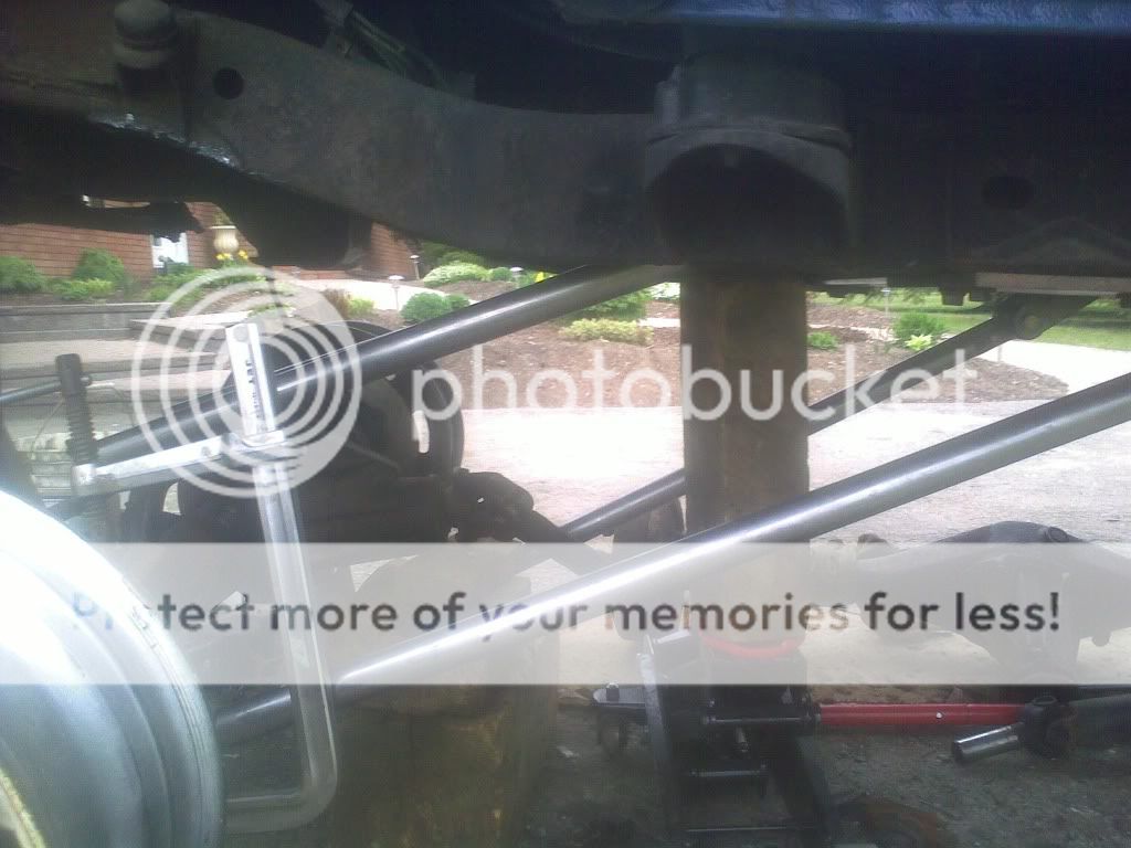

in the heat of the moment i decided to pull out my new 4 link bars just to see hoe they would look under the truck
looks like it'll work well i think thwe springs sit about 4" lower with weight from what i remember but that was witha 4 litre over them

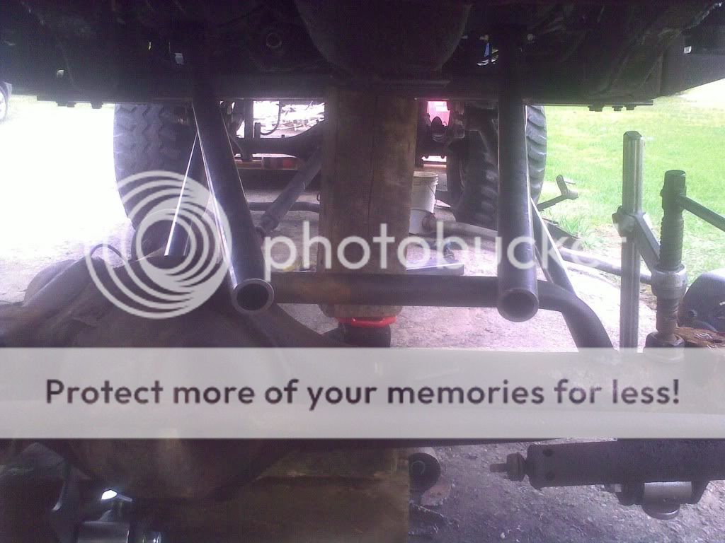

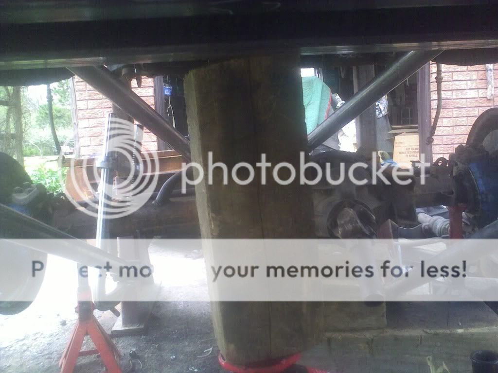

so before work i sat under the truck with the 4 link bars and found out i could not mount them under the fame because i would have no room to turn so i have to build them. i will get the metal asap to get started on that. but i am still working 7 days a week 10 hours a day so time is very short and i just bought a house photos of that will come soon too

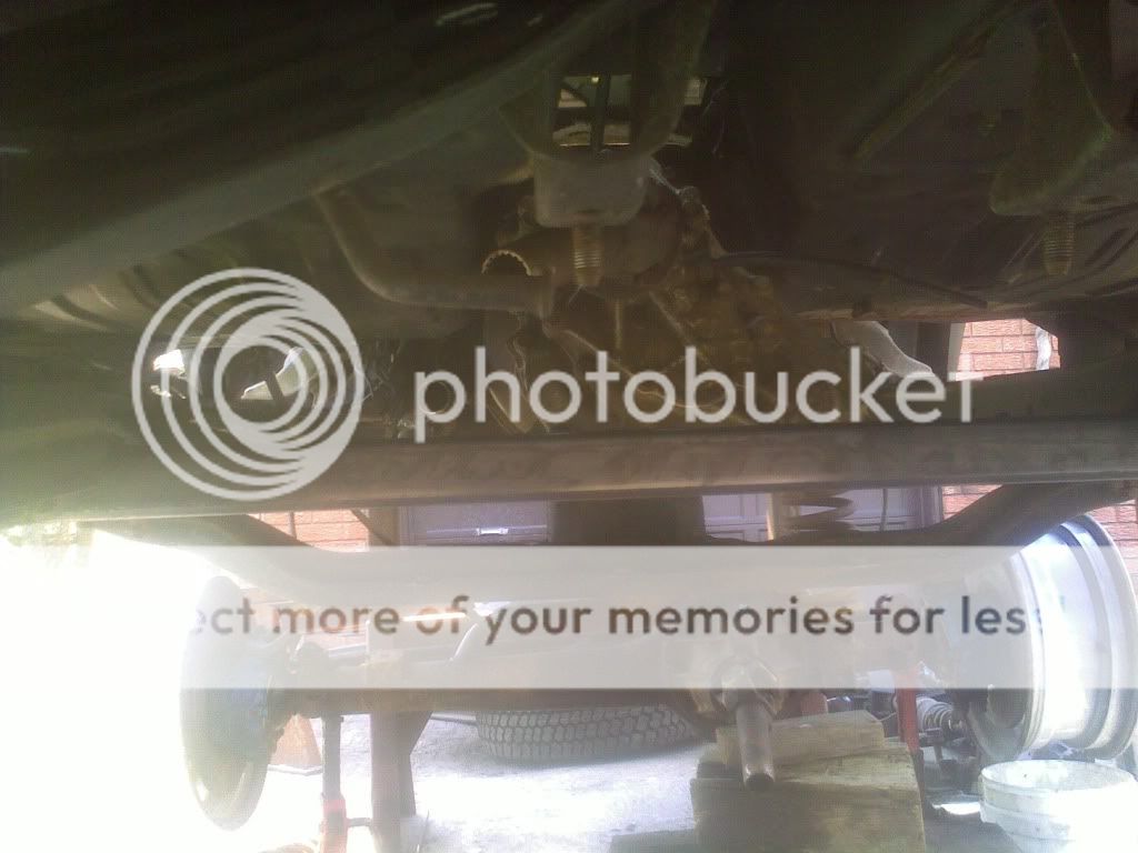

cross member

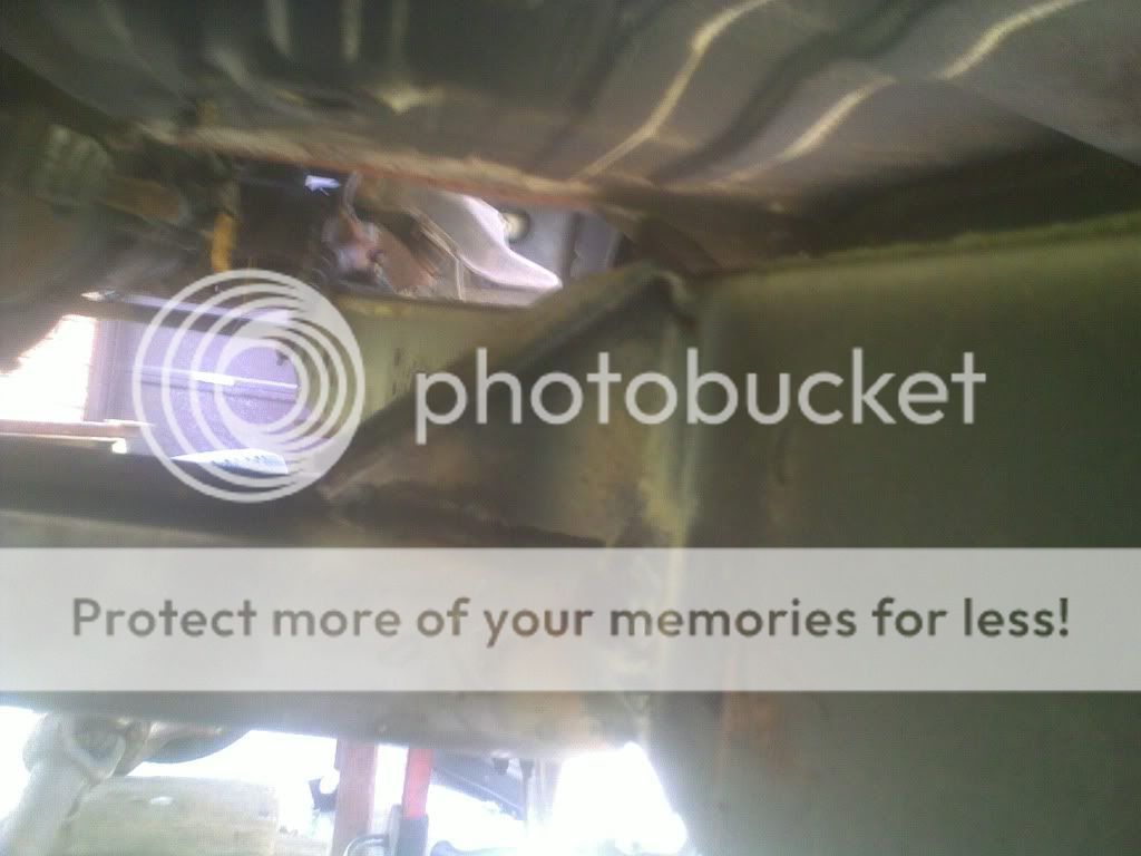

when i started this build i thought that the 4 link would be able to just weld right under the frame, but after i held the links in place i quick found out it would not work. they would get in the way for the tires when turning.?????

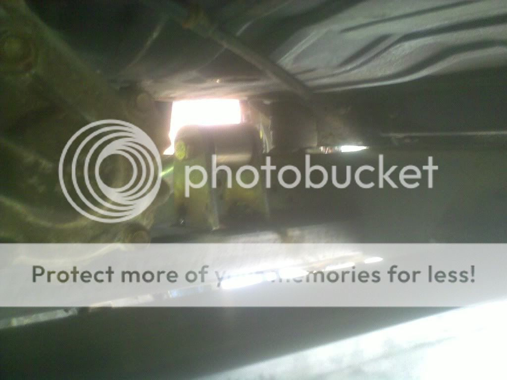

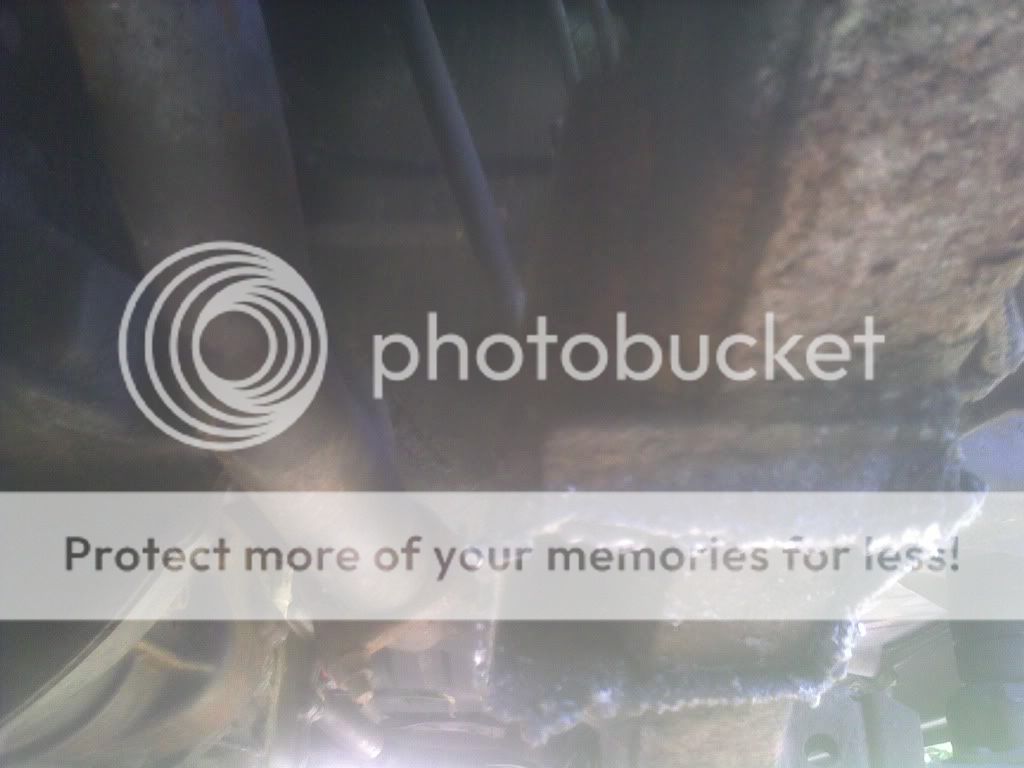

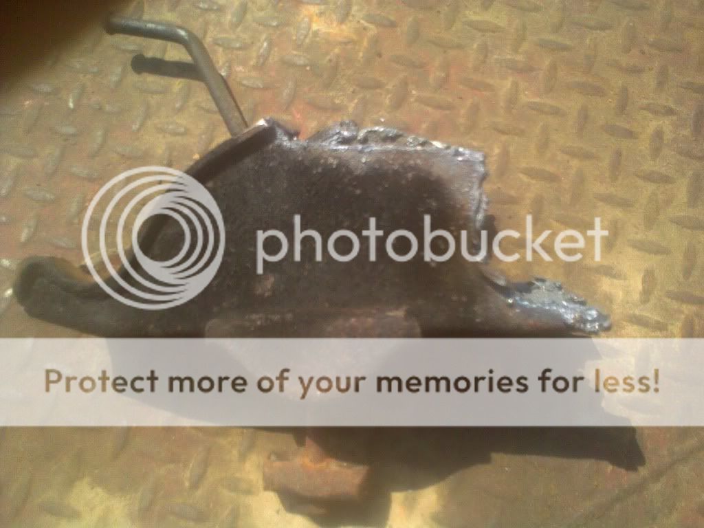

so the way that i came up with is to build some heavy dude cross members that will make the frame stronger and be the mounting location for the 4 link. the tranz will be getting one in the near future, but this one took the place of the stock torsion bar mounts. how u cut them off i left as much metal as possible to be use as a gusset to support the new cross member.
this is the stock torsion bar mount the i had to cut off
there is plenty of room for the rear drive shaft so there will be no problems with this down the road

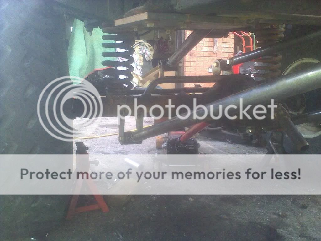

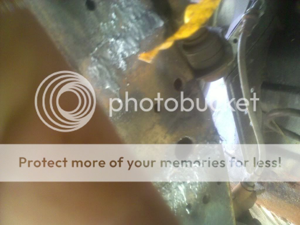

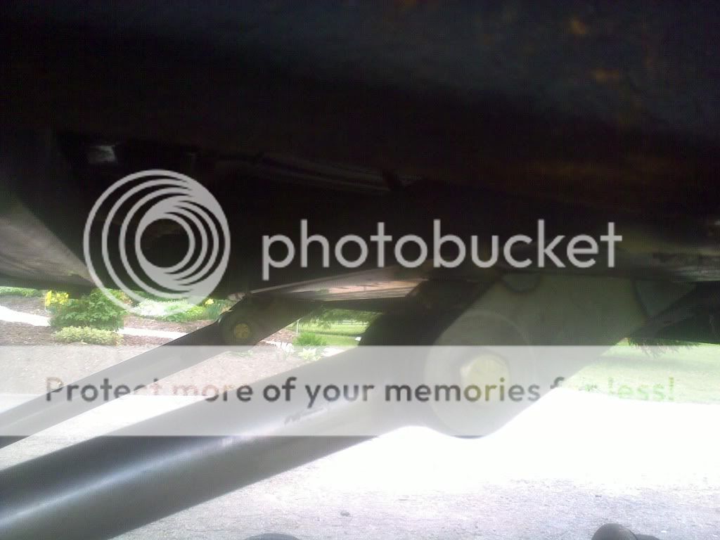

so earlier this week i installed the brace that took the place of the stokl torsion bar location

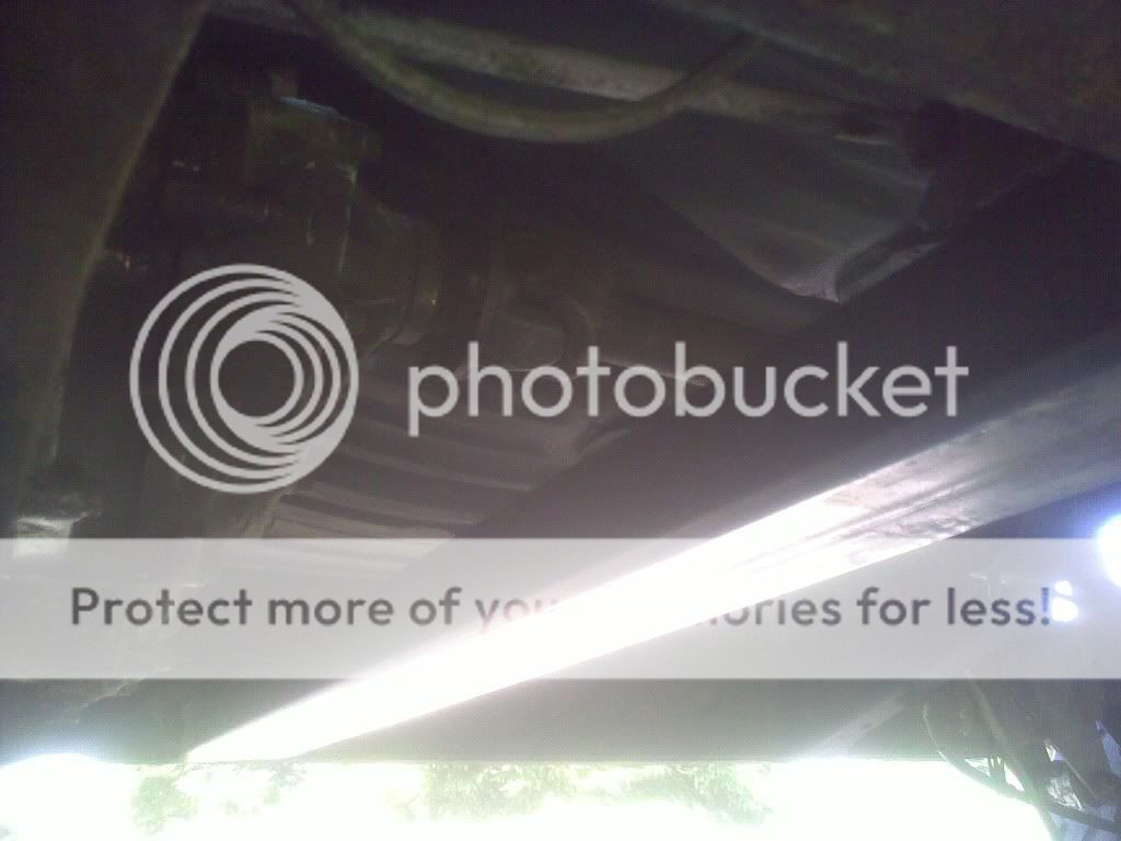

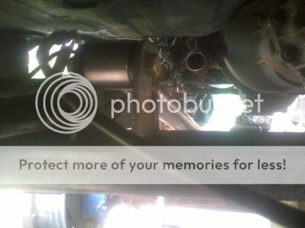

now it was time for the tranny mount to be changed out, the main reason for changing the stock tranny mount was so i could get more ground clearence and for the fact that i wanted to mount the top bars for the four link to it and the stock one was not strong enough to take the forces that will be put though.
not i still wanted this thing to be easy removable so if i ever need to drop the tranny out it could be done easy and quickly, i did not want to have to cut it out and have to weld it in when i am finished so what i did was cut half inch flat plate to bolt in to the stock holes and the the 2 by 4 square tubing to support the tranny and hold the link ends

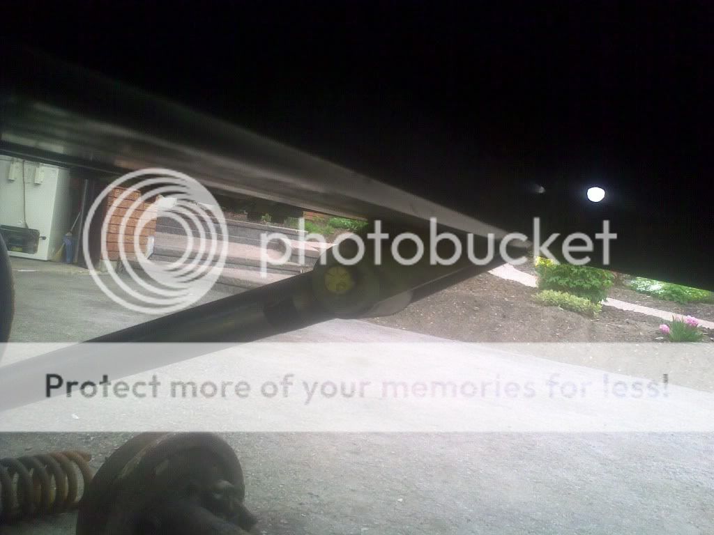

then from there the link bar start getting mounted on the the new supports
those top bars at 4.5 inch away from the center line they are square they dont look square in the photo because i am on a slight angle
standing under its own power now( look out )

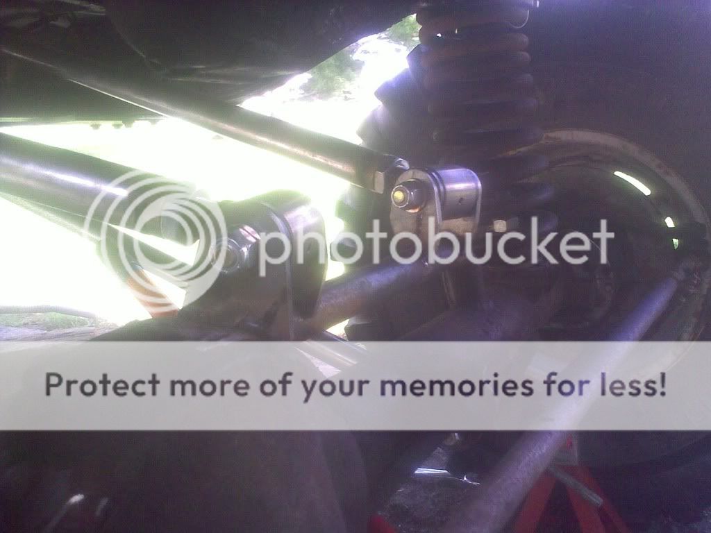

so i got the link ends all tacked into place it is only tacked so i did not stress it by checking the travel.

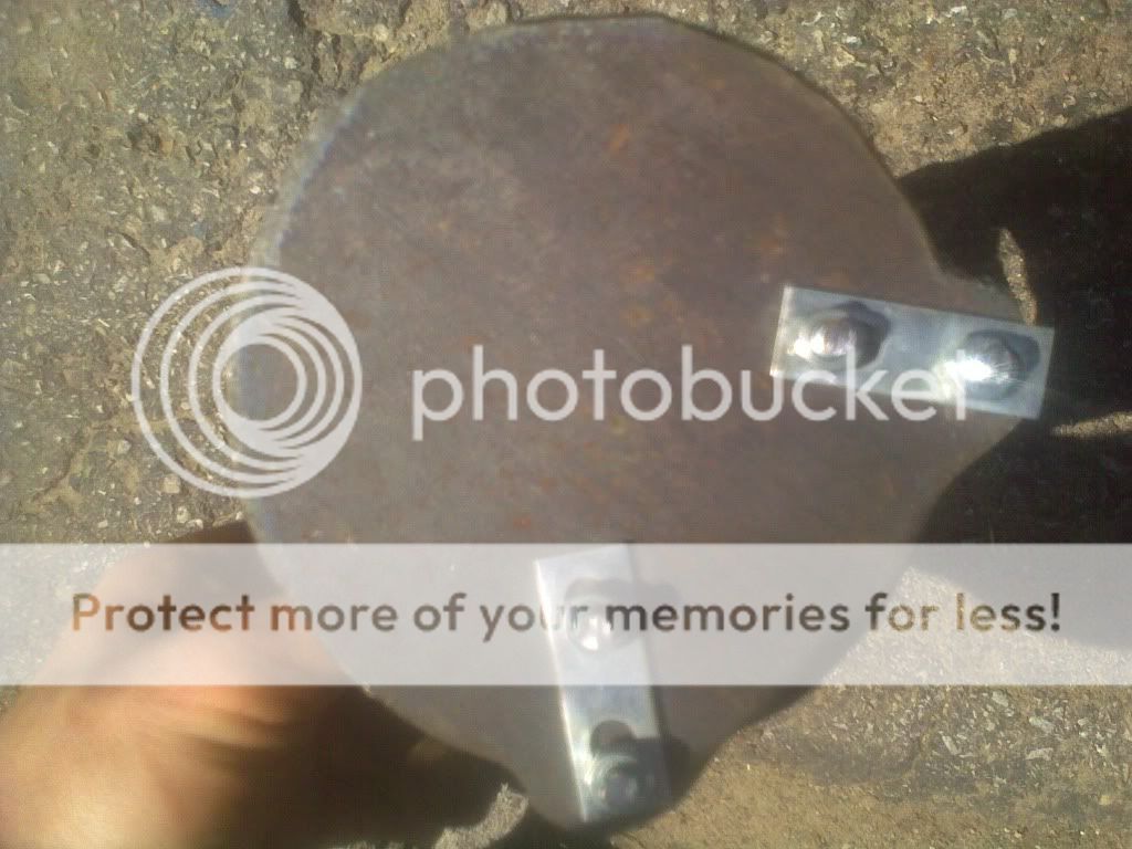

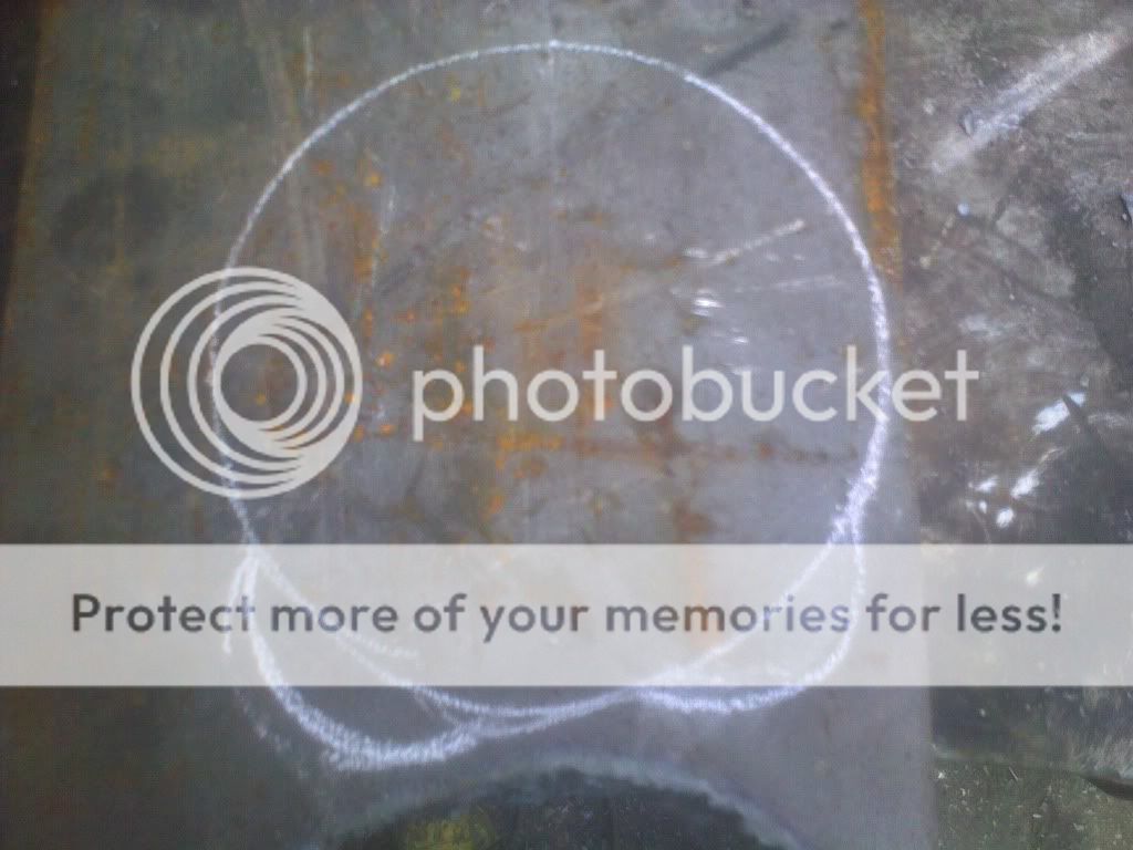

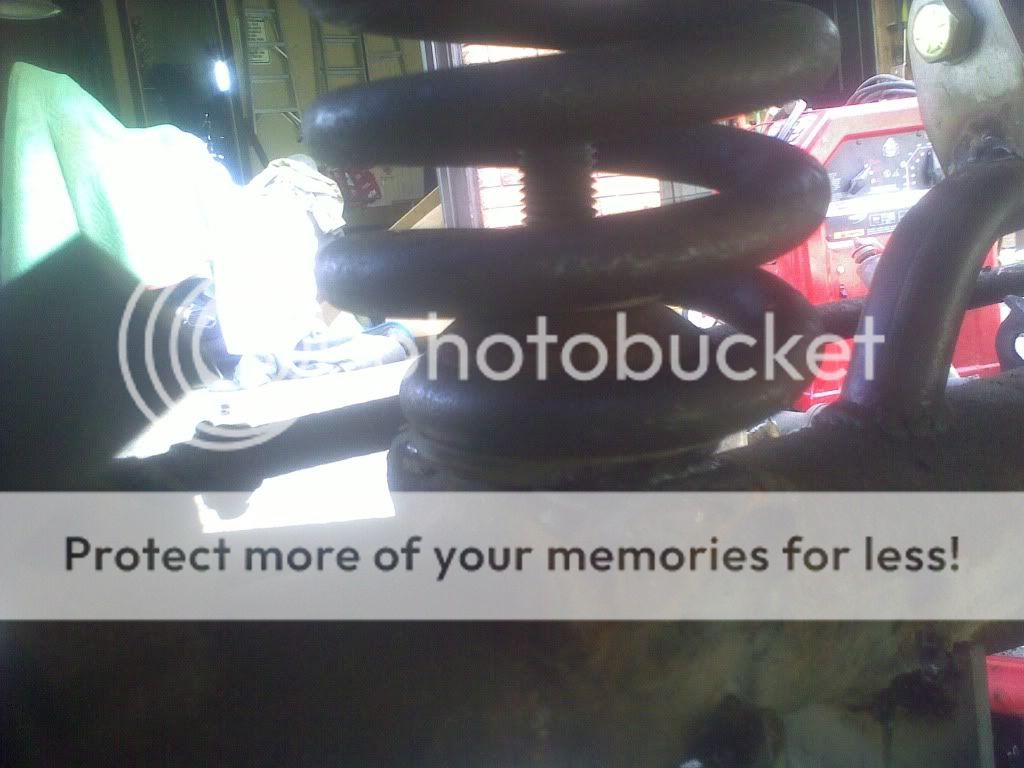

now i did not like the ranger stock spring mounts, and i have to mount the spring under the frame, so the stock ones would not work any way. i i build my own spring mounts

Seeing that your links arent the same lenght, your pinion angle is going to go some weird stuff to you.
Did I guess it right????
Or did I over look something?
you are right the top links are shorter that the rear links but they are set up to work together. there is no binding and they work fantastic i have not been able to fully test the links though but there is a car show every Wednesday in my town and i would like to get my truck there ( by trailer or course ) but i would like the links to be full welded and the Toyota rear axle to be out in the truck. but the links work great there is a little bit of twist in the axle but very little like 4 or 5 degrees or so
ya but bteween full stuff and droop ur pinion angles going to change. and u really gotta either do a cut and turn or divorced t case cause ur front drivline angles are gonna be ****ed (id do both personally) but a cut and turns free minus the cost of the angle finder)
