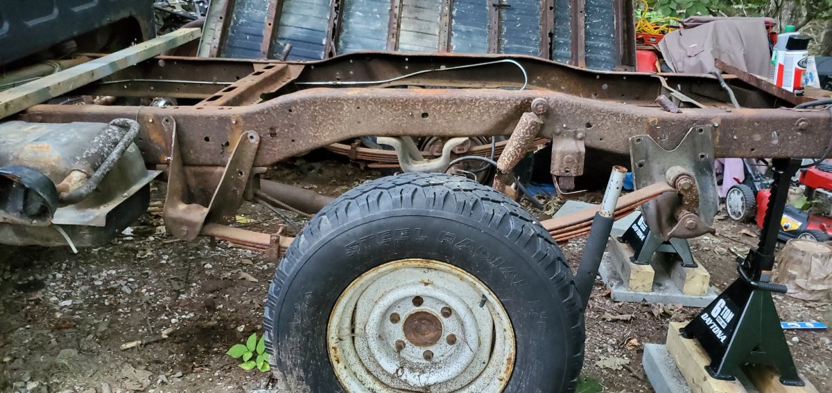

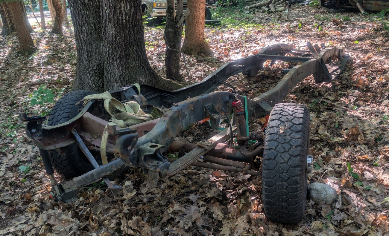

86 GMC squarebody, my introduction to bodywork.

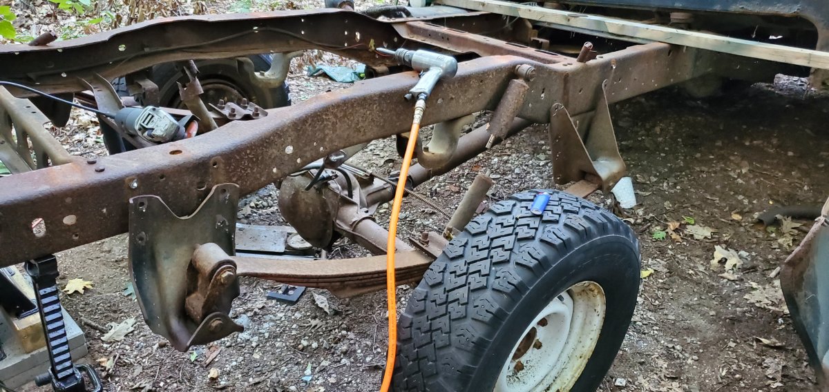

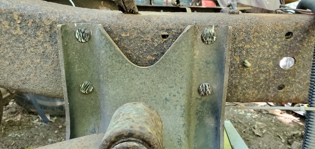

Spent the better part of 3 hours today after work removing the 28 rivets that hold the shackle hangers and the spring hangers to the frame. Tried to slice up the heads as best as I could with the grinder, and then hammered on them with an air chisel. Really gave the compressor a workout.
No way am I gonna get this thing back on the road this year like I had hoped... but I've set myself the reasonable goal of at least getting (most) everything that's behind the cab taken care of and finished before it's too cold to want to be outside for the year.
- Remove spring hanger support brackets
- Fix frame
- Clean, corroseal, and paint the frame and brackets
- Reinstall brackets, install new springs, new shackles, and place it all on top of the 14 bolt full floater axle I got a couple months ago.

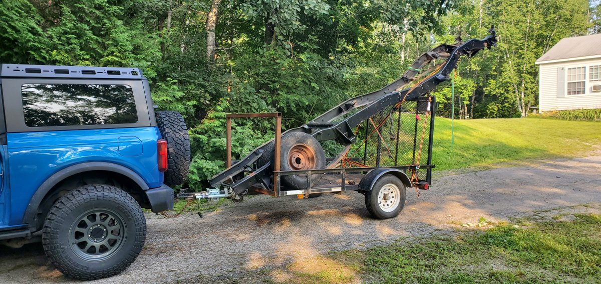

Bought myself an absolute cherry of a frame earlier in the week. This is gonna make things soooo much easier.
I do NOT reccomend transporting an 8' bed truck frame on an 8' trailer though.. even if it's cheap as chips.. and even if it's a first come first serve type deal. 48mph is far too slow to be white-knuckled 😶 I'd have to slow down to stop the trailer from dancing every time a semi came barreling around me lol.
.. I mean.. id totally do it again... just not for 150 miles 😆
