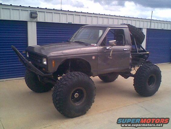

Here's a recent pic of the b-dos. She's been rode hard, but rust free.

I'd say B2. With a little stretch in the front and rear it will work out good for you. My Early bronco was originaly a 92" WB with some work it is now 99" and 92" to the outside of tires and I love it. It is short enough th fit anywhere without even making a single backup but it still stable on the hills.
mine is 4" stretch in the front and 5 in the rear, i even moved the rear shackle hangers forward and lost about 20" of frame. the difference in stability going from 94" and 62" wide to 103" and 79" wide is incredible
