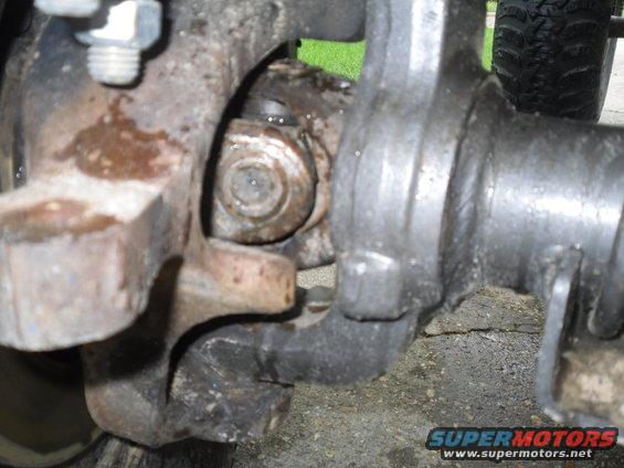

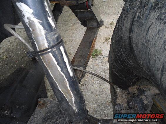

took some pics for you of the axle at full lock.
full lock on the box, about 3/4" gap inbetween.
doesnt even get close to touching, those are 2.5" wide trail-gear leafs, outboarded as you can see on the stock perch locations.
axle is a 97 F350 axle, rims are 15x10 Marsh racing beadlocks, 4" BS w/ 1/2" spacer, so 3.5" equiv. 39.5x13.5 IROK's
