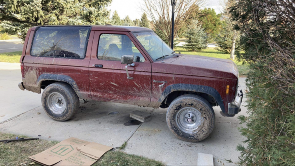

Hello all, I bought this bronco this past summer for a steal of 500$ because it needed a clutch. Just got around to putting the new clutch/flywheel in, and have it running but now I have ran into an issue with the engine sputtering. This issue occurs when the engine is below roughly half throttle, but fades as the engine approaches anything above 1/2-3/4 throttle. I just did the spark plugs and am planning on doing the distributor cap and plug wires. I also plan on checking fuel pressure and putting in a new fuel filter. My worry is that this will end up being sensor related which I am clueless about on these 2.9l engines. Where else should I be looking aside from fuel, spark and air as far as sensors? Anything common that would cause this issue? I will also note that I am a bit of a noob/youtube mechanic but I am enjoying learning along the way. Thanks
