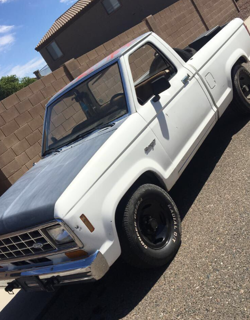

Down to the nitty gritty on getting this truck running, for some reason going from 0 - 100% throttle, the motor would hesitate, as if its not getting fuel, then rev up. However if im on the gas smoothly and slowly it does not happen. Could this be my accelerator pump? New fuel filters, etc.
Basically at full throttle, my fuel will cut out for less then a second, then rev up like normal.

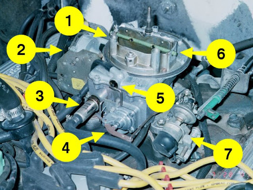

Im not super familar with the feedback carbs, but if the pump is similar to the old 70s 2150s its directly on the front of the carb.
Pop the top of the carb off (6 screws), remove the pump (front of the carb body, youll look directly at it with air cleaner off, right side as your looking), undo 4 bolts, remove from throttle linkage, REPLACE PLUNGER BEHIND IT (thats why you pulled the top cover off the carb)...reassemble.
Its pretty easy
I think this requires the OBD”0” scan tool. It looks like this.
If you still have the feedback carb, you probably have the accelerator pump with the vacuum line going to it. There was a control switch that applied vacuum or didn't apply vacuum, and that varied the output of the pump. If you want full output, just disconnect and plug the line. That's how I am running mine with no problems. When it applied vacuum, it redirected part of the fuel shot back to the pump inlet, reducing the amount of fuel that went into the engine. What a complicated mess that engine system is (was on my engine, I took it all off).
