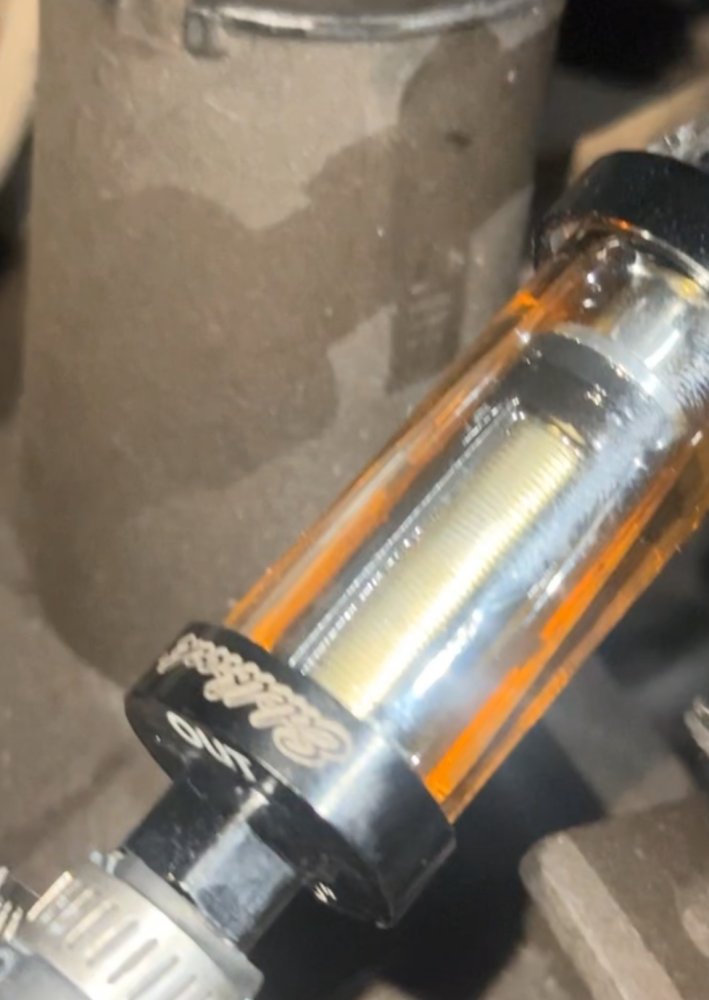

Theres one under the frame rail i still need the replace and there is another that is suppose to go on the carb also, since that got broken i replaced it with a hose adapter and just put a clear filter in between, check photos, but fuel isnt a issue, pressure is good and carb was shooting fuel pretty good after i cleaned it up.
