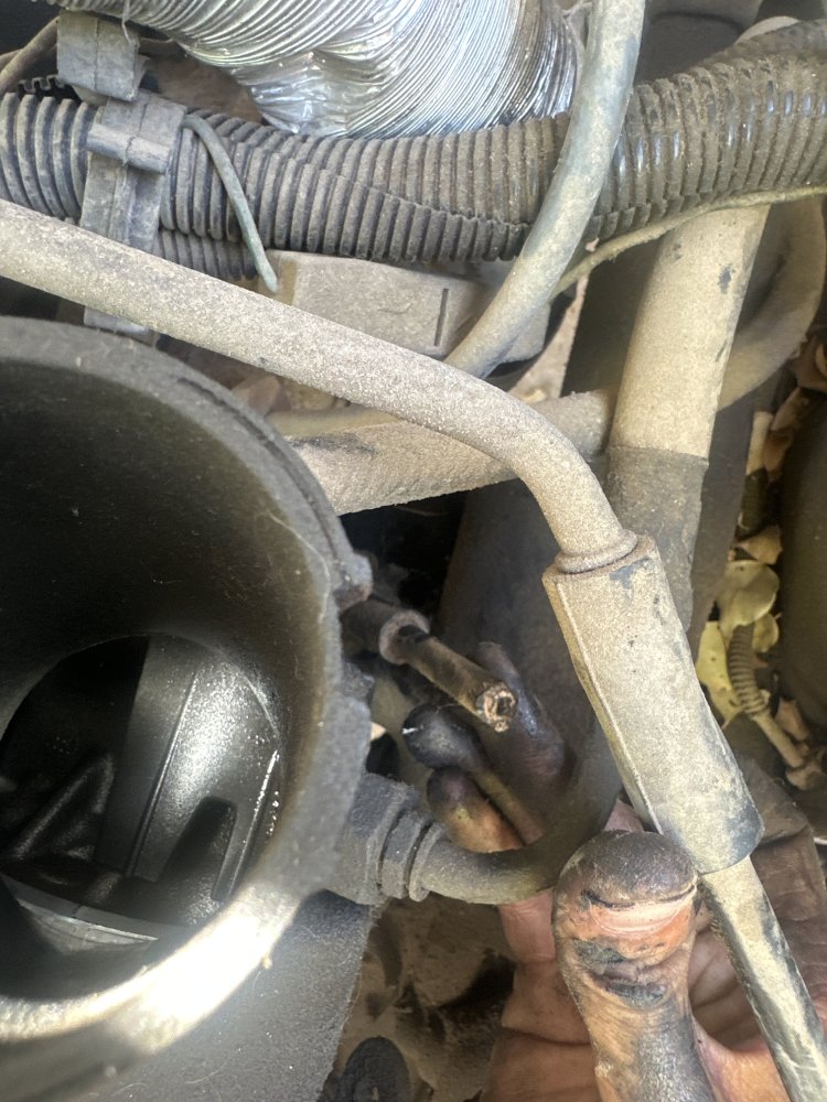

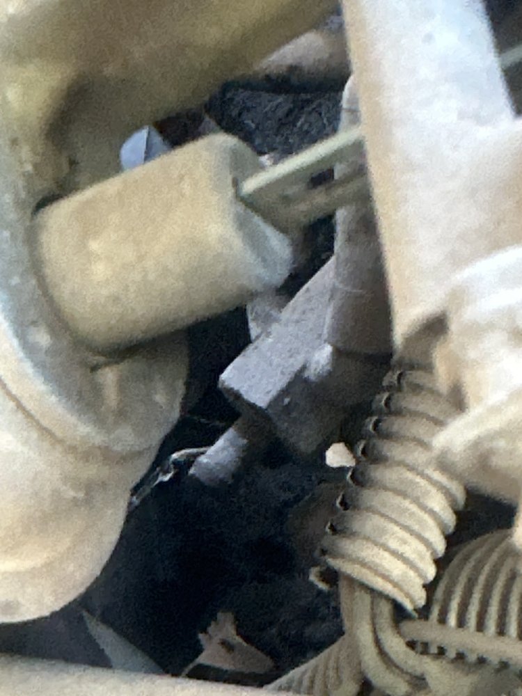

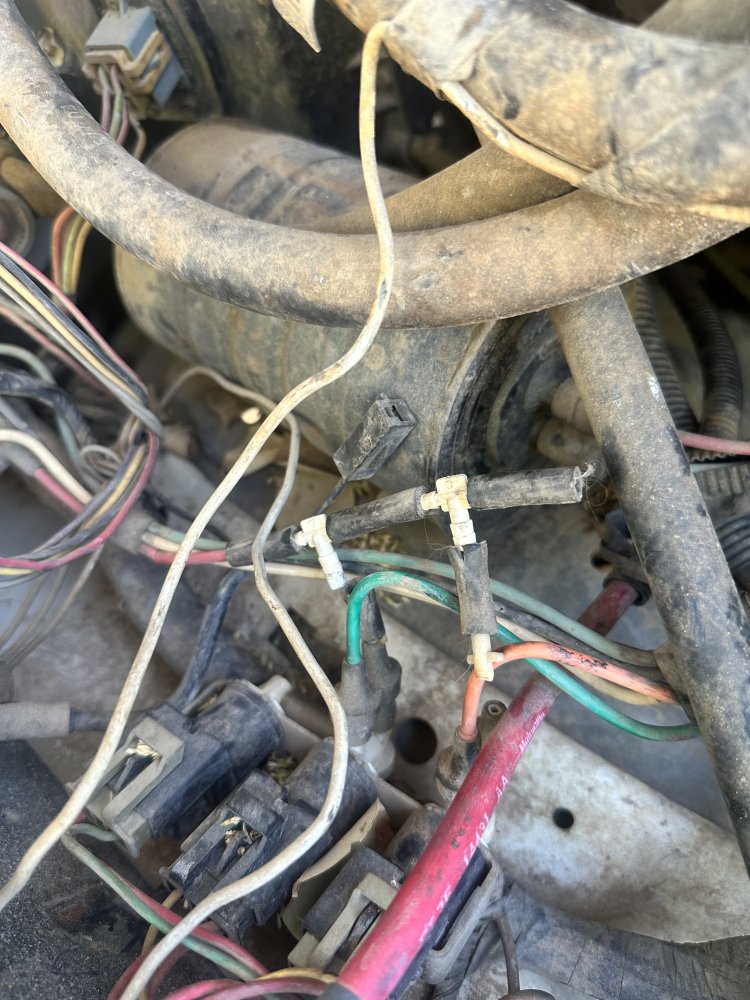

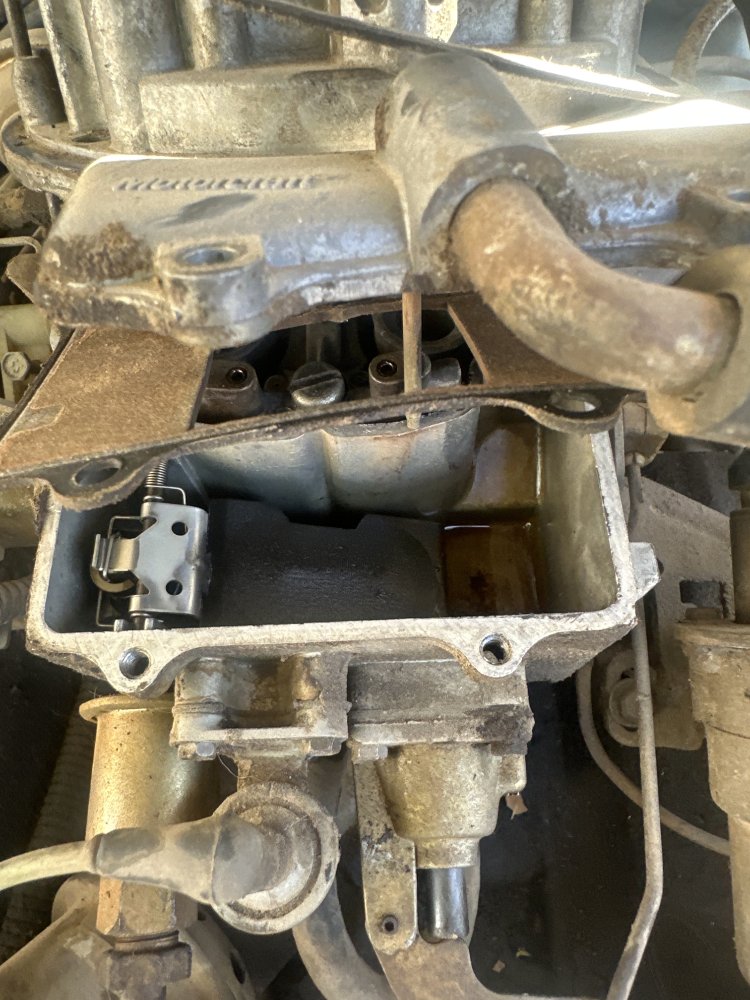

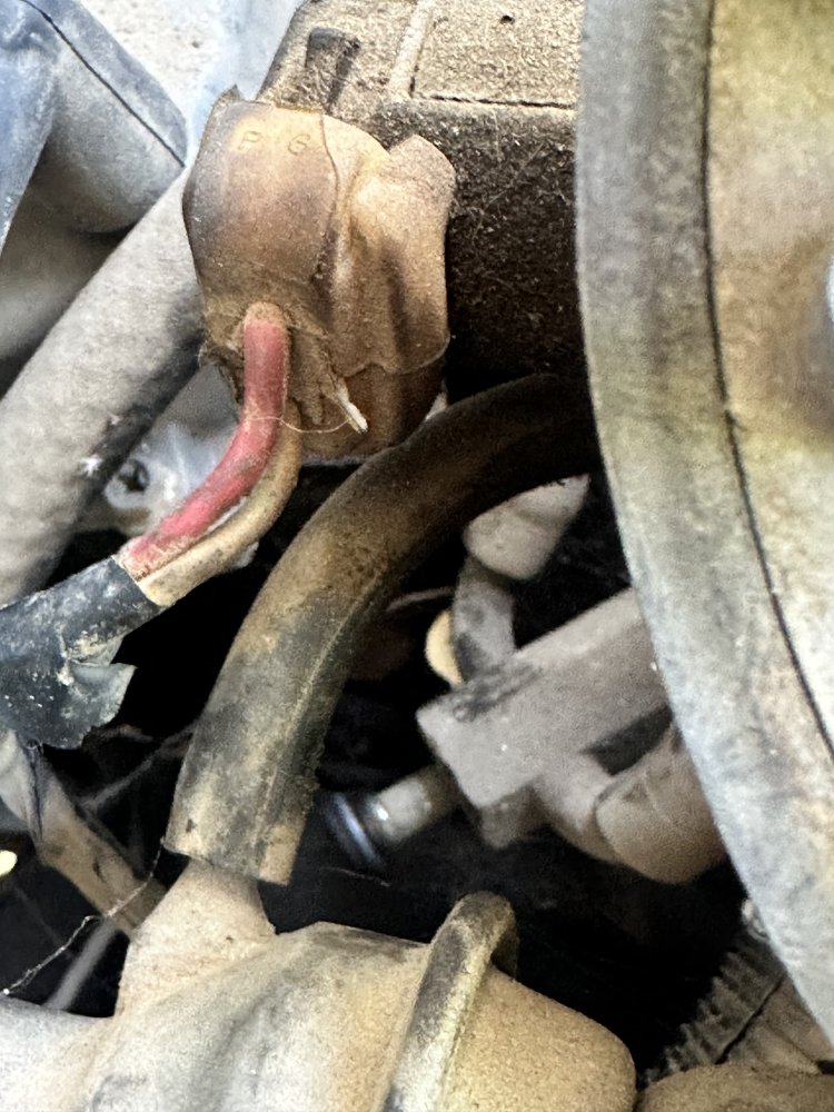

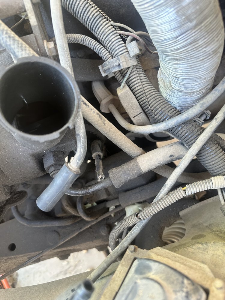

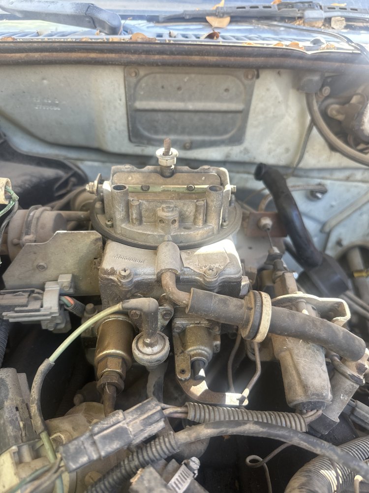

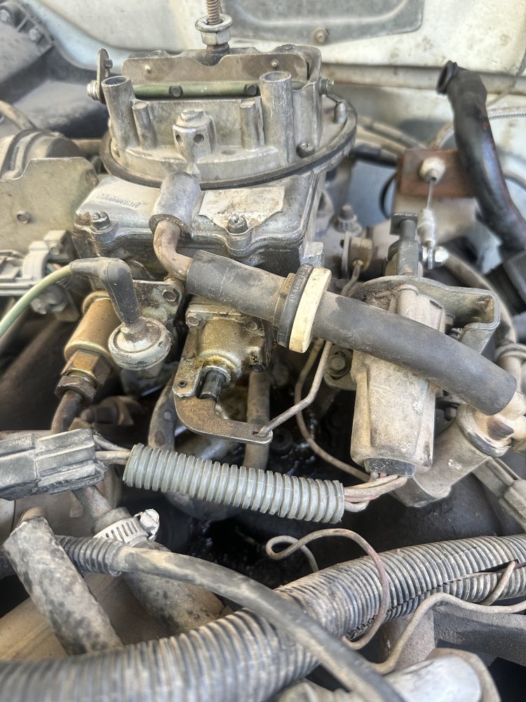

Okay ive attatched images, first things first theres a line blocked off thats under the steering pump, there is a peice under the carb on the manifold i think that has vacuum, didnt have a line so i blocked it and it ran abit better but still bogged wot, i noticed inside the carb fuel was somehow being ignited, not noticeable though. The accelerator pump is leaking, might be bad from what im hearing. Also i dont think the electric choke works i honestly have no idea. But when i do choke it , it seems to go to WOT alot better so im thinking its leaning out because accell pump isnt doing its job? It idles rough and i can hear it misfire here and there but other than that it idles on its own. I just wanna be able to go wode throttle and not die out. Plus i need to work on the charging system, it doesnt stay running without a battery

If you still have the feedback carb, you probably have the accelerator pump with the vacuum line going to it. There was a control switch that applied vacuum or didn't apply vacuum, and that varied the output of the pump. If you want full output, just disconnect and plug the line. That's how I am running mine with no problems. When it applied vacuum, it redirected part of the fuel shot back to the pump inlet, reducing the amount of fuel that went into the engine. What a complicated mess that engine system is (was on my engine, I took it all off).
heres a photo, which vacuum line?

Can you link this to me and explain it more? I am replacing the accelerator pump and the rubber plunger since it literally disintegrated on me while removing it, maybe it had something to do with it, and the gasket was no good. Most of the lines like emissions and stuff are blocked off, so would it still do me good “resetting” the codes. Not sure how it really works everything under the hood is a mess but i do know the MAP and the ignition coil is there with vacuum line attached and no leaks from what i can tell. Vacuum tree is also blocked off. Green vacuum wire next to the accell pump i blocked off if thats what everyone talks about
That black elbow to the right of the fuel filter.
Its blocked. Ran it today runs so much smoother and idles on its own great, still hesistates but fixed it because the vains for the accelerator pump was clogged. I cleaned it and it intermittently clogs and doesnt spray consistant so im going to fix that.
even when both vains were spraying good it seems to still hesitate. Everything vacuum wise is blocked off. I added a new fuel filter thats visible just so i can see how fuel looks and its pretty clean, imma just go over and clean the carb again.

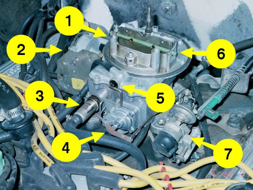

Is #3 the fuel filter? I know there is a inline one on the rail. But i want to change #3 but not sure which part i need. Going to change the one on the rail and put a clear filter in between so i can see how fuel looks
Yep #3 is the fuel filter
