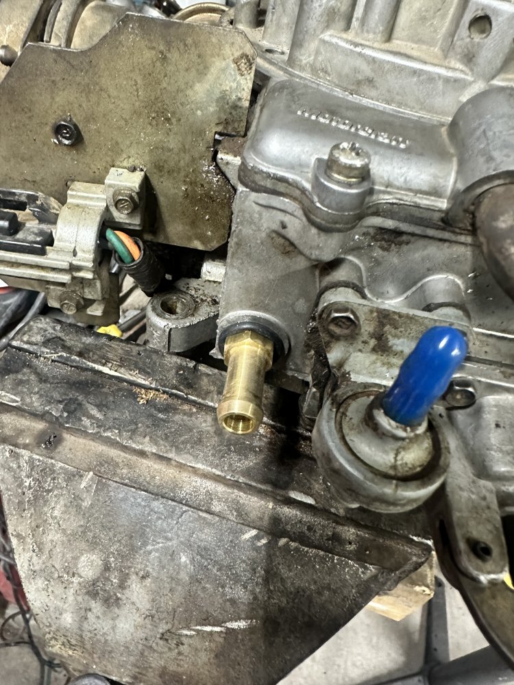

The brass fitting for the fuel filter broke off inside the carb so i gotta pull it off now and retap new threads for the fuel inlet 😵‍💫

Nope i just drilled everything out dissembled some things and cleaned everything out. Retapped new threads and used a hose adapter since i already have 2 filters inline.

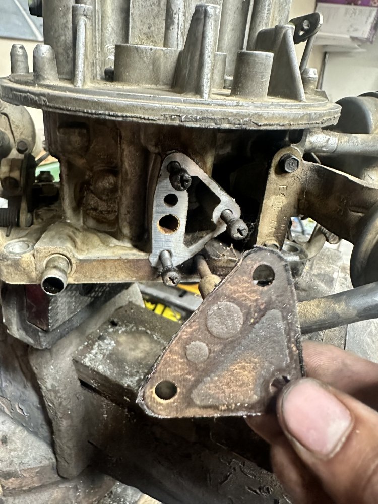

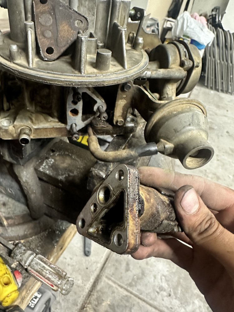

alot of things were nasty and sludged but its cleaned up. The mixture control solenoid was also dirty and the gasket was just completely blocked?? Anyone can explain? Photos attatched. Other than that the replacement for it on ebay is 100$+

Theres one under the frame rail i still need the replace and there is another that is suppose to go on the carb also, since that got broken i replaced it with a hose adapter and just put a clear filter in between, check photos, but fuel isnt a issue, pressure is good and carb was shooting fuel pretty good after i cleaned it up.
pretty much curious about the mixture solenoid and why it was capped off, my only guess is since its a ON OFF solenoid i assume it is blocked so it stays shut?
