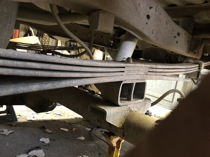

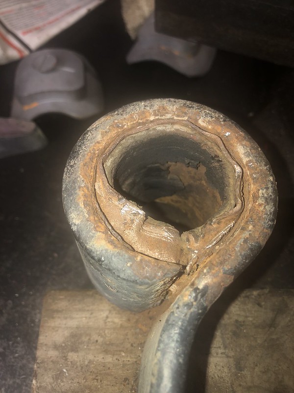

That over load plate looks bent. It should be flat. Not to say that is why your springs are messed up. It just looks like the truck was over loaded at one time, which can be bad on springs.
Springs were used from a 2009 scab. He thought they were too soft, I wonder if he overloaded them and I didn’t notice before I installed them.
That could very well be.

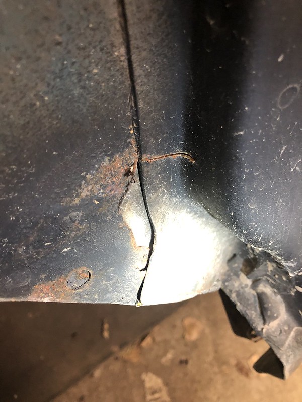

Also discovered how the torque box is still getting water in it:

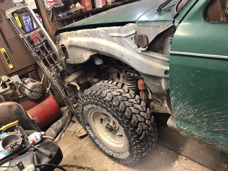

Main goal is to get the doors to open and close nicer. The passenger side is really bad, usually passengers think the door is locked. Wifey has to use two hands to open it. Truck is nosed into the garage and PS is against the wall so we will figure out how to do this with the DS. Hinges are tight, this all started after I replaced the cab mounts last year.

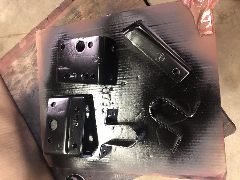

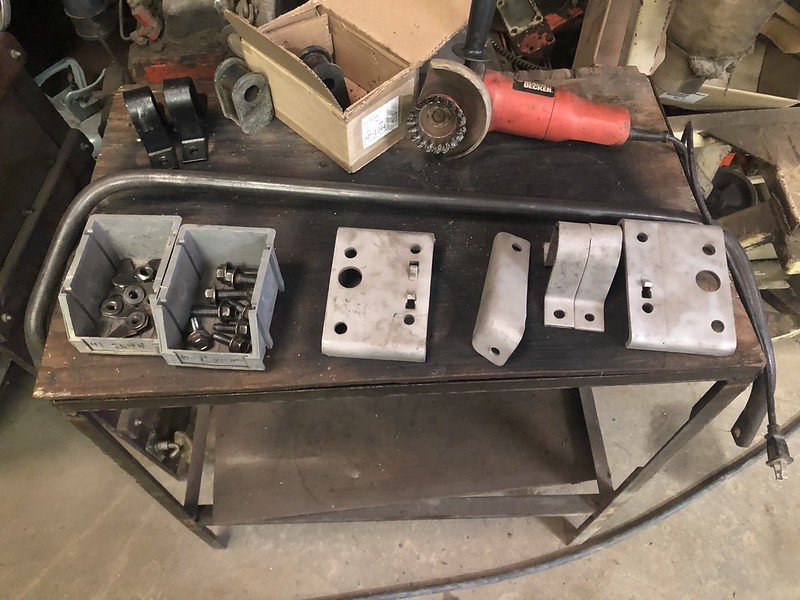

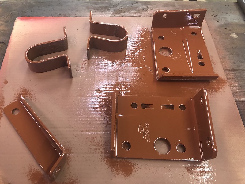

Sway bar parts are cleaned:
'85 Ranger Restomod

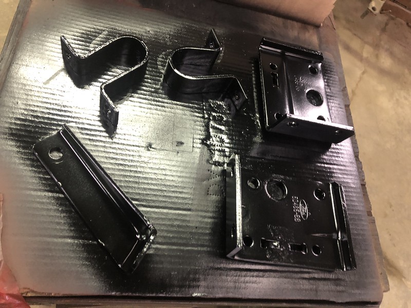

And the brackets are primed:

Anyway to update on progress so far I have the fender back on, I think the doors open better. Alignment is still off but after delving into it the alignment of everything is off and I can't do much about it as the truck sits now. The hood isn't square to the cowl so the fender is either off compared to the cowl or hood... I just need to do more to get after it and I am kind of under excited about doing it, I will probably call it good until I pull the truck apart to repaint it.
Almost done painting the sway bar stuff, just gotta figure out end links and I can go back together with it:
'85 Ranger Restomod
It is interesting all three of the bigger stamped parts have this stamped into them, I can't find much about them. Just a bunch of crap about the Nissan Titan.
'85 Ranger Restomod
The two big plates have ovals and Ford part numbers on the other side. The little brace is just smooth.
