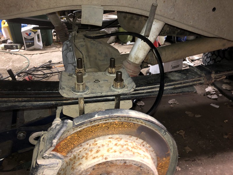

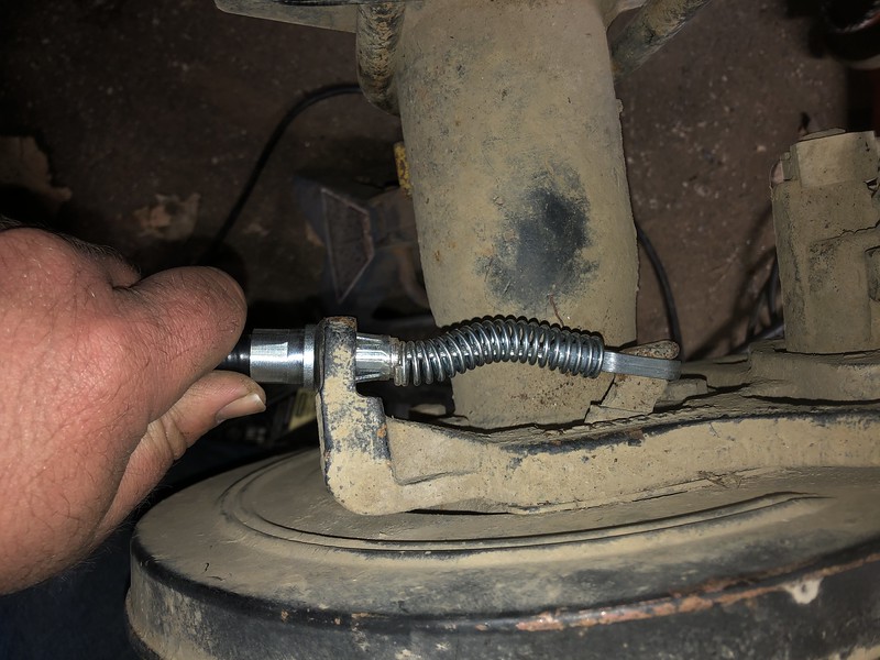

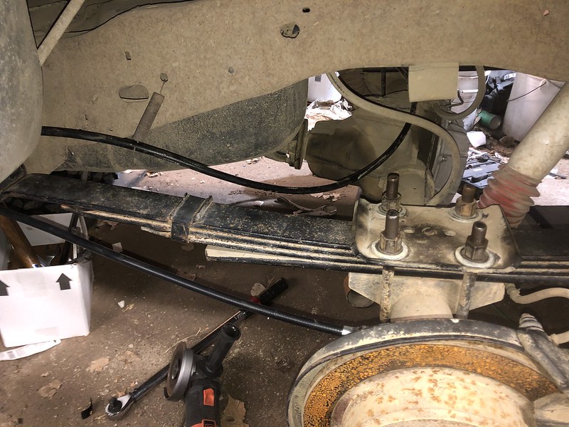

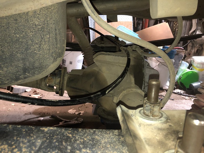

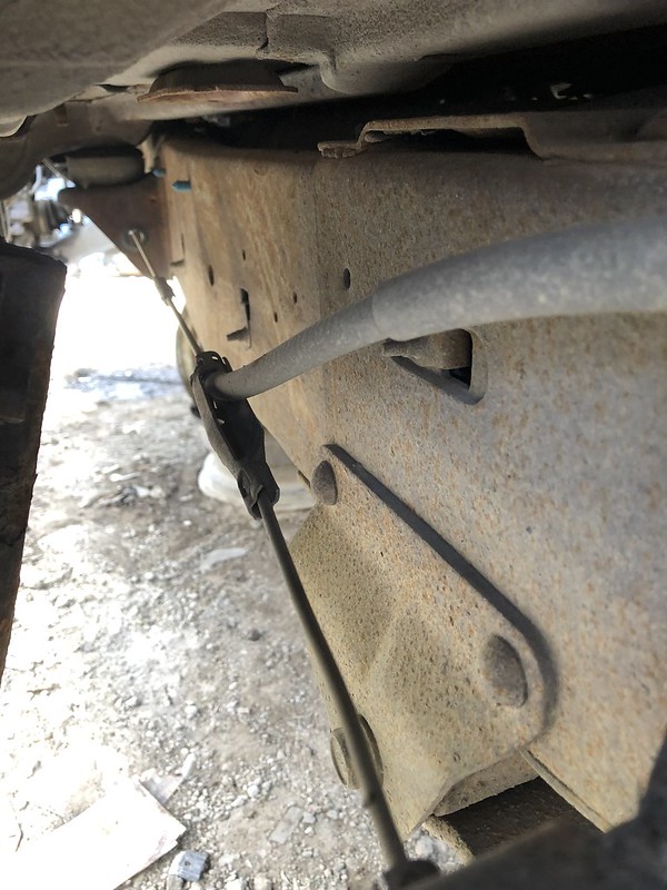

Cables are on, using springs I nabbed from an Explorer at the JY I am pretty happy with the routing:

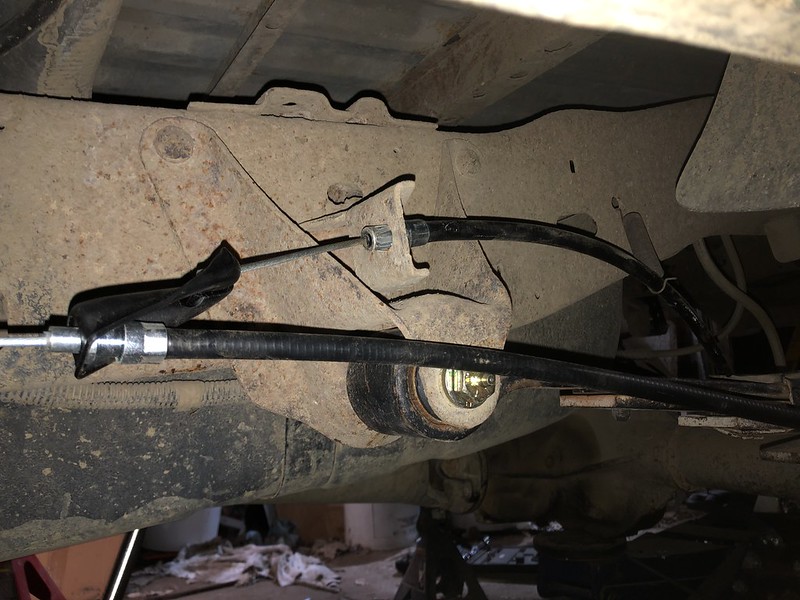

DS needs a little more support yet:
The cables are a little on the loose side, the pedal doesn't ratchet down right, at least the LH side sticks... otherwise everything is awesome! :yahoo:

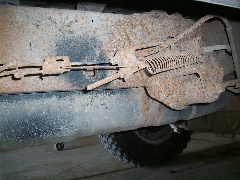

I was hoping there would be some adjustment on the pedal assembly to take the slack out of the cable, I dug thru my 8.8 swap folder it looks like originally Ford had a spring in addition to a bunch of other junk on the cables to add tension to them. I have no idea where that ended up 9 years later...
I do like how they had the PS cable routed thru the slot in the frame too. I should have looked at this before I got started...

I am putting the Explorer brake system on my Ranger... so it is a hodge podge thing.
My Ranger system used the spring to put tension on the cable. I am now thinking the Explorer just uses the springs on the cables.
I don't really know what I need yet, I might just need to move that bracket back a bit...
This was making my head spin a bit. So I reposted the two pictures.
Looks like the cables are reversed...
They can only go one way though?
@adsm08 what say ye? This is all your idea...
So the passenger cable won't fit into the equalizer and the driver cable into the frame bracket?
