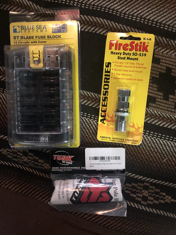

Nice thing about the setup is that the mount is a friction fit for the flag and it's relatively small. I just cut off the threaded end on the flag and chamfered it. It slips right in. And the flag breaks down like a fishing pole so you don't have to make it fit somewhere.
I went this direction for the flag and the mount.
I have that mount already lol:
'85 Ranger Restomod
The flag I had found that apparently amazon quit selling broke into like 4 parts, two parts are still better than one.

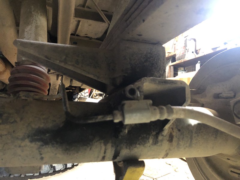

- I will also need to relocate the brake line mounts (aka weld a 1/4" nut a little lower on the spring perch so it doesn't hit the spring in its new position)

Add another 12 circuit blue sea fuse panel for battery constant power along with changing the key power relay to support more demand (and some other tweaks to the electrical system too)
Add dual Mercedes efans.
Mount flag on truck

Welded another nut on the PS perch to lower the brake line below the spring, with perfect strategic placement and an equally perfect bend added to the brake line it fits perfectly.

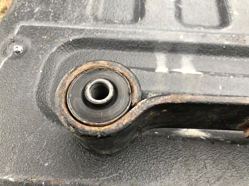

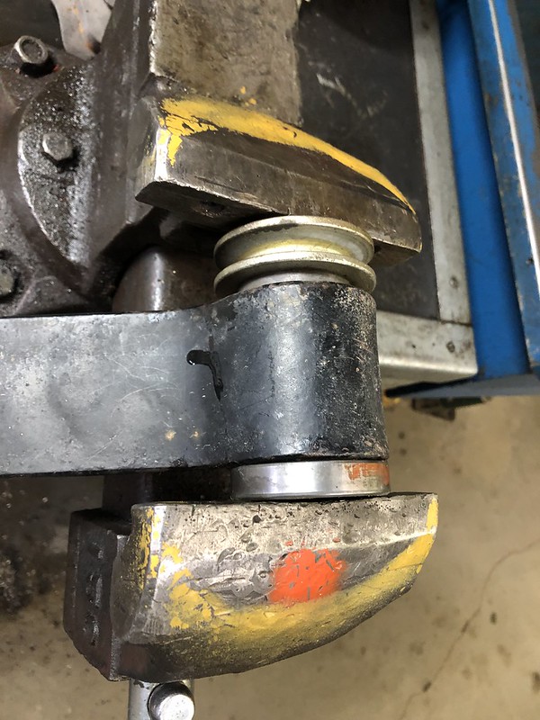

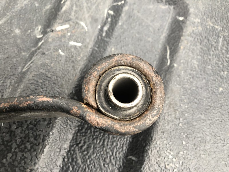

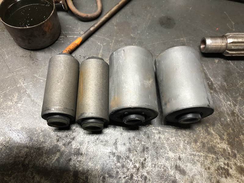

All new bushings ready to go:
'85 Ranger Restomod

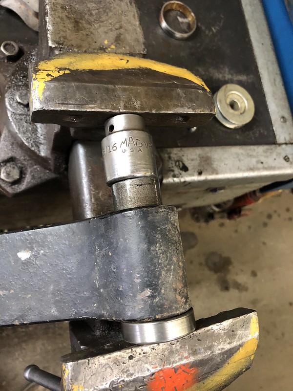

The little turds fought some but they are all in:
'85 Ranger Restomod
'85 Ranger Restomod
'85 Ranger Restomod
'85 Ranger Restomod
'85 Ranger Restomod
'85 Ranger Restomod
I did not notice they had changed the front spring bolts to the larger size when I put these springs in a few years ago. Needless to say they had a lot of slop in the front.

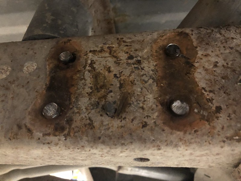

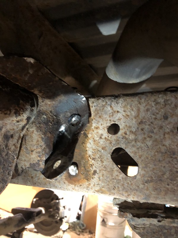

DS rear shackle has a little side to side play in it, PS will swing back and forth by beating it with a hammer. Like half a dozen whacks for a full swing. I also noticed the PS spring hanger has been replaced so it is bolted on... I am thinking I will just replace the hangers instead of fighting the top bolts with the bed on.
'85 Ranger Restomod
The hanger replacement isn't that bad. I did them on the '98 without too much fuss.
Are you going to be able to make that larger bolts work with your existing front hangers?
I screwed up when I put the '09 springs in a few years ago and didn't catch that they changed sizes (also didn't catch they had been overloaded, I was in a hurry before the wedding) It actually wasn't until PJ's thread in the suspension section that I knew they changed them... which got me to wondering. PJ also noticed I seemed to have a lot of rear axle movement on the trailride (seemed ok to me from the drivers seat) Since the '09 springs had been horridly overloaded at some point I decided to put my '96 Explorer springs back in, delete the blocks and replace the shackles with Belltechs if the need arose. The springs I just replaced the bushings in and reinstalled are the Explorer ones.
The '09 springs are already in the iron pile.

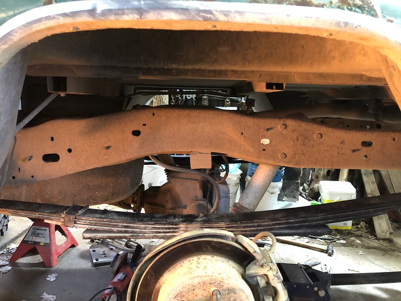

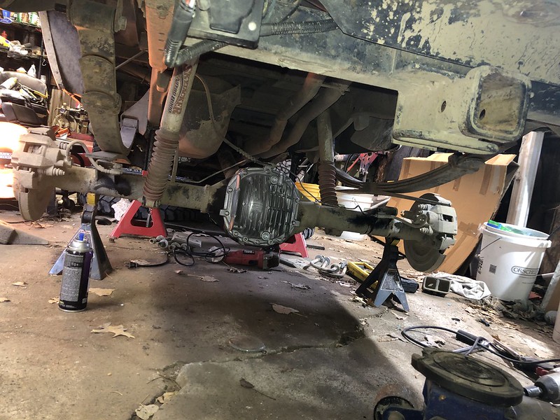

Stuck at home with a sick kid, can't work outside and I don't have a whole lot of parts on hand if I could so I figure I will type up my plan for something to do.

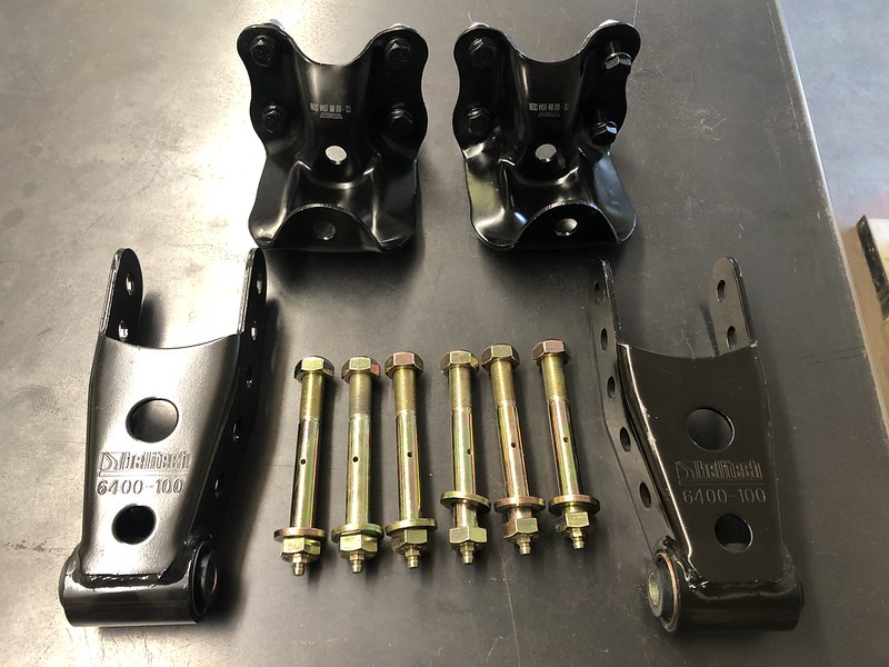

Rear of truck is on jackstands, springs are back out of it. USPS did deliver new slider puck things this morning so I can get those put in the springs tonight maybe. I have greaseable bolts coming for the spring eyes and upper shackle bolt, due on Monday. I have had 1/3 of them seize on me and I hope to eliminate that in the future. Just ordered new rear spring hangers and Belltech shackles that should hopefully show up next week sometime.
So, after I get the pucks in my springs I need to get the rear hangers ripped out of the truck. One has been replaced before and is just bolted in (the one with a siezed shackle actually) so I don't see my impact caring much about him. DS will need the rivets ground off, drilled out and driven out. Then install the springs on the front bolts and the axle and wait until the rear spring bracketry shows up, then slap it on.
Then on to the fuel pump...

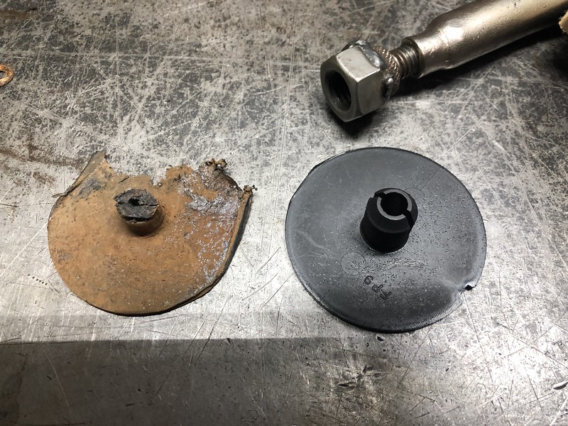

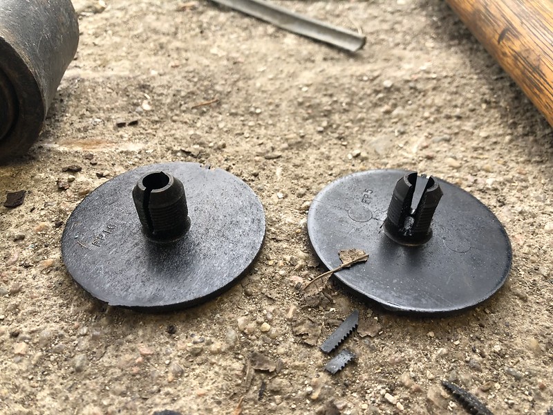

New plastic spacers are not quite right, if I open up the slot and shave a little off the sides they go in:
'85 Ranger Restomod
I haven't messed with the ones under the clamps yet, not sure how to do deal with the clamps as of yet. As a whole they look to be in better shape the ones that don't have the spring clamps.

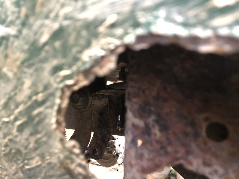

Convenient rust hole to watch the progress thru, Ford just thought of everything!

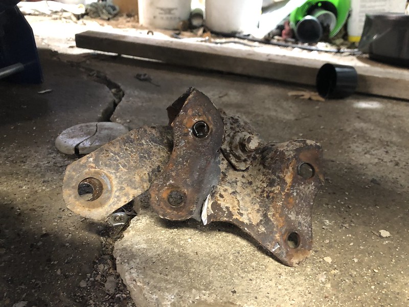

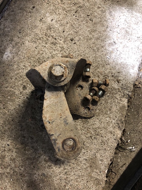

I am going to try to rescue the shackle, it would be a spare for my pickup box trailer:
'85 Ranger Restomod
'85 Ranger Restomod

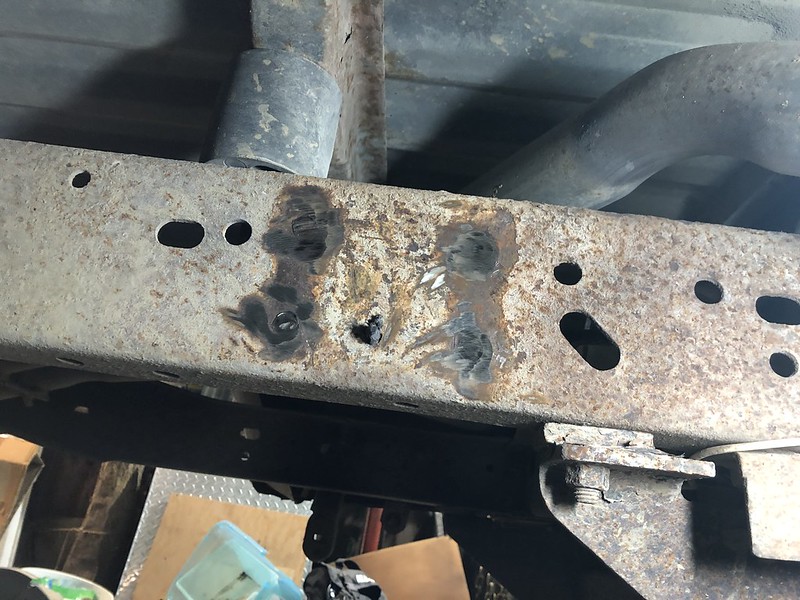

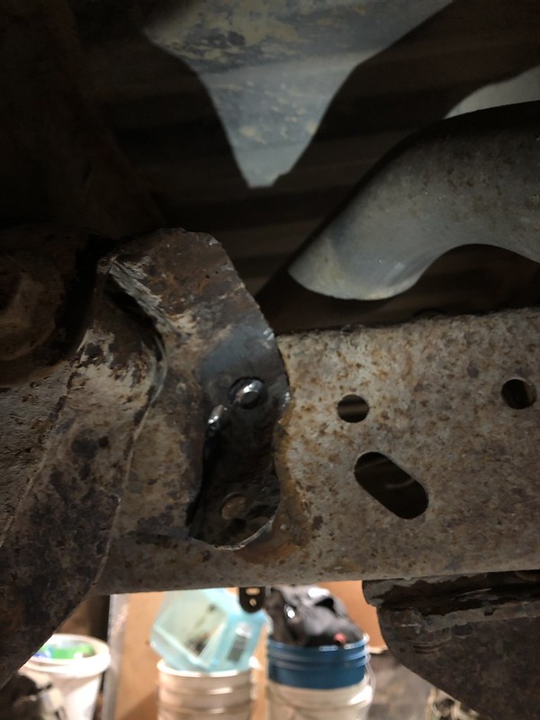

Then I borrowed a service truck from work with a big on board air tank (mainly for filling tires or running an air gun) and an air hammer and buzzed the rivets out. Like 5 or 6 hits each, compared to drilling and beating the coil bucket rivets it was a cake walk.
I wire wheeled the rust off and threw some paint on it:
'85 Ranger Restomod

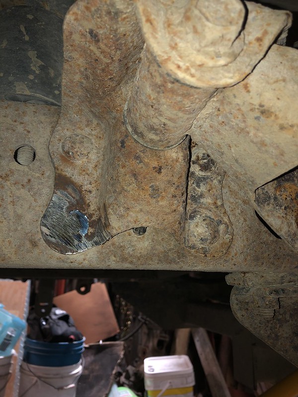

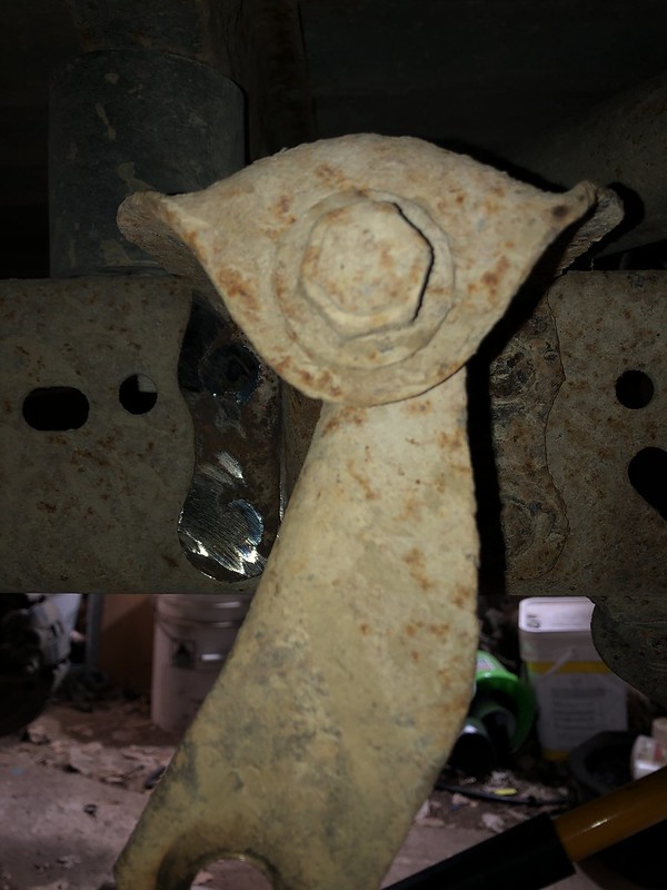

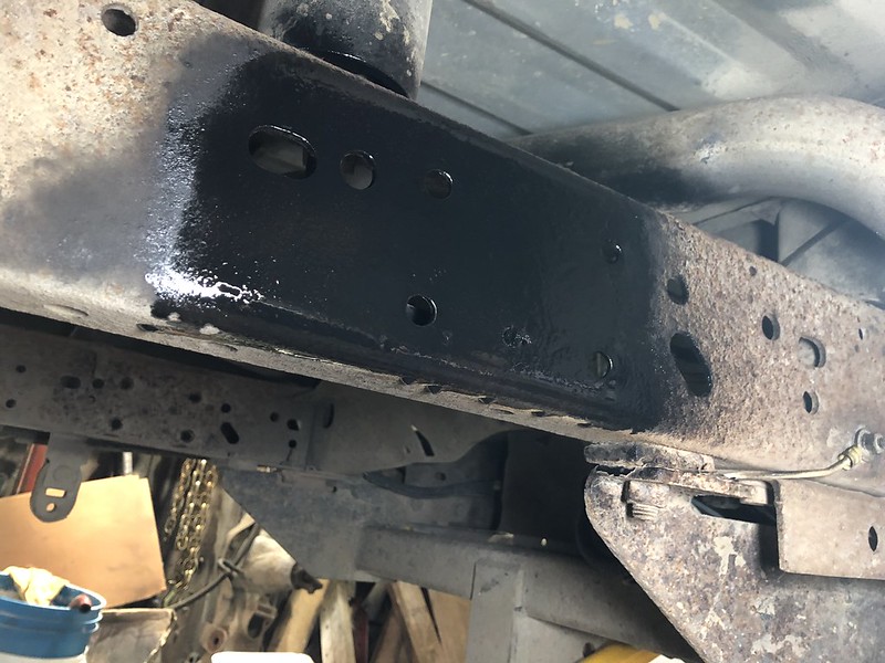

And the other side was bolted on, not sure why. I don't think it had been replaced. Coincidentally it also has the seized shackle. I am going to try to save this bracket for a spare now that I can fight with it in the open. The odd mix match of fine thread and course thread was a neat touch by the previous owner too.
'85 Ranger Restomod
I also cleaned and painted the frame behind it but didn't get a pic. Waiting on parts, bolts are supposed to show up tomorrow, hangers and shackles on Tuesday... so hurry up and wait.

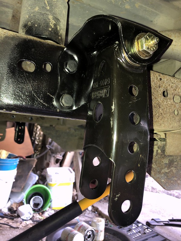

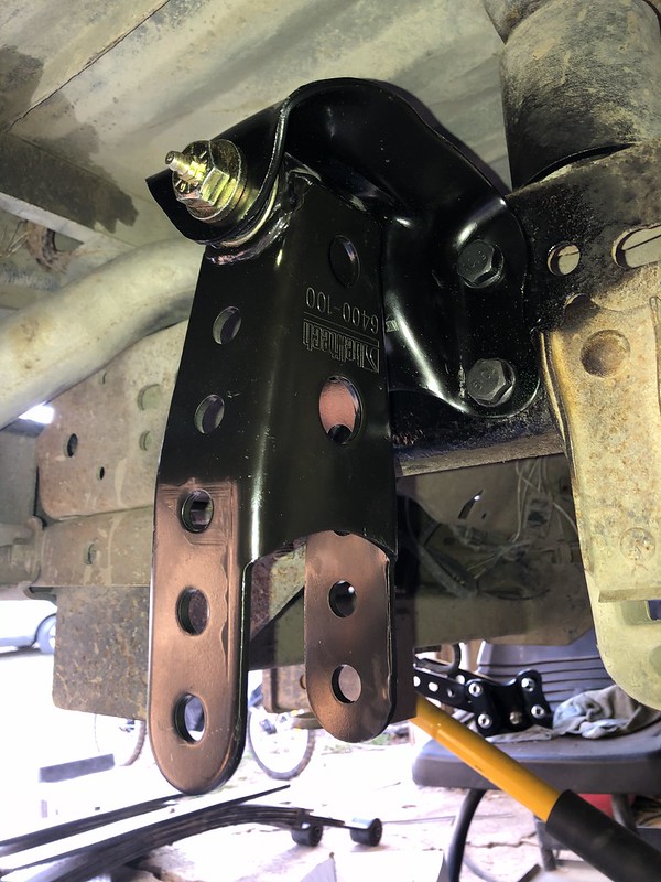

One new hanger and shackle:
'85 Ranger Restomod
Another new hanger and shackle!
'85 Ranger Restomod

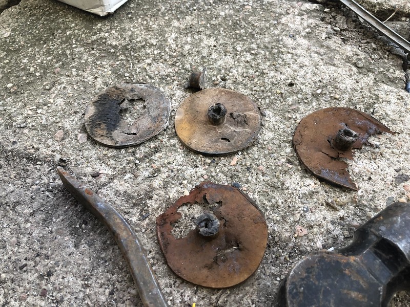

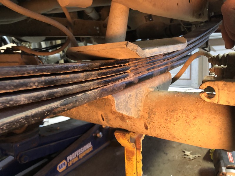

How I modify the spacer pucks to fit in the springs:
'85 Ranger Restomod
Glad I did, all 8 of the were shot, these 4 on the clamp end of the springs looked pretty good until I got them out.

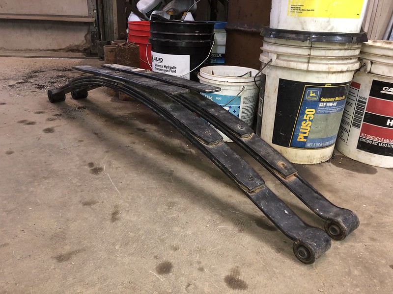

It can hold its own weight
'85 Ranger Restomod
The springs are actually curved now!

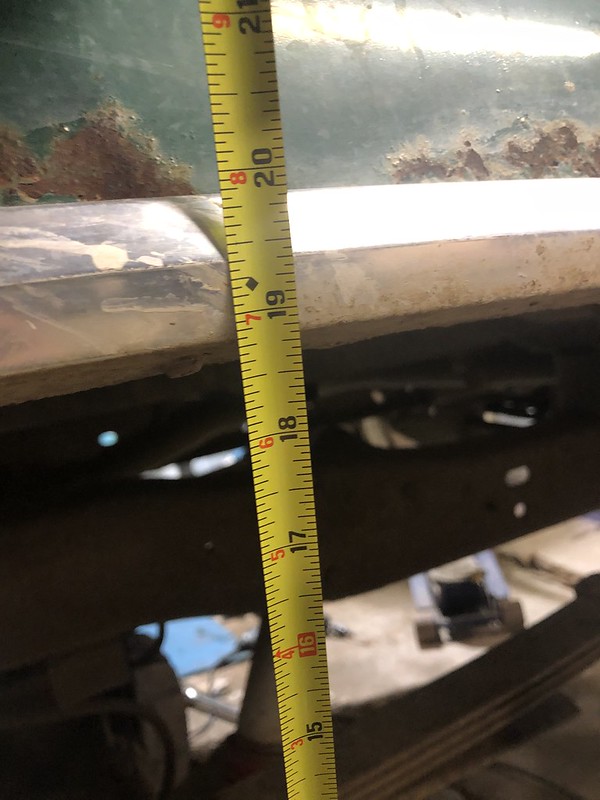

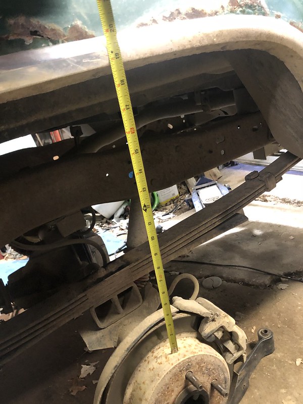

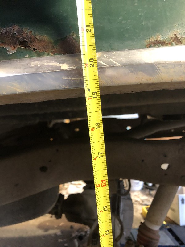

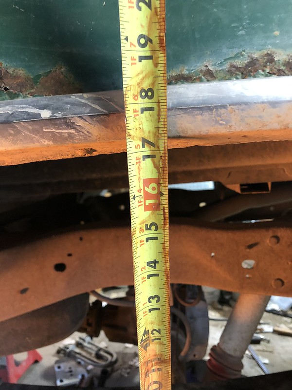

To recap the ride height changes as I have removed and added things. I was content with where my truck sat but I wanted to ditch the lift blocks. Measured from the center of the wheel arch to the parking brake drum.
Whooped '09 springs, factory lift blocks, factory shackles:
'85 Ranger Restomod
'85 Ranger Restomod
Explorer springs, no lift blocks, factory shackles:
'85 Ranger Restomod

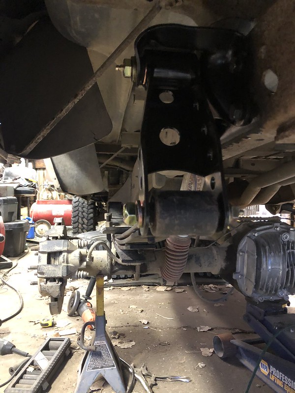

Explorer springs, no lift blocks, Belltech 64000 shackles:
'85 Ranger Restomod
I gained a little bit, I can live with it. Better than losing.
So now I just need to tighten everything up, get the parking brake cables on it and then move on to other things...
Are the shackles oriented correctly? I would have thought the open end of the U would face the springs....
The factory shackles were this way in both my Ranger and F-150 and the write up says they go this way.
It bugs me though, if i had to scratch one on a deserted island with no instruction I would opt for the other way, it just looks more “right”.
Yeah. The way its installed it seems more likely to hit the spring on a big bump.
It would a biblical bump, I could move it up a hole if I wanted to.
