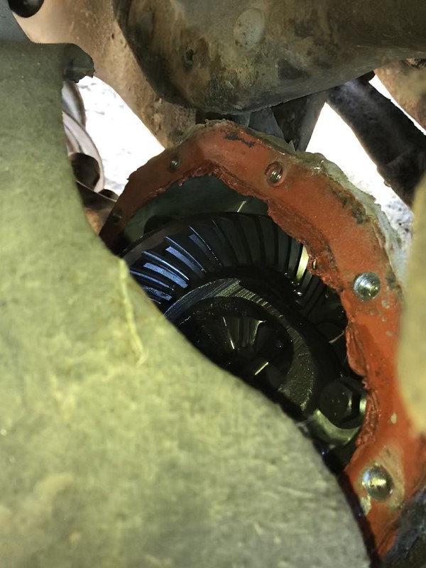

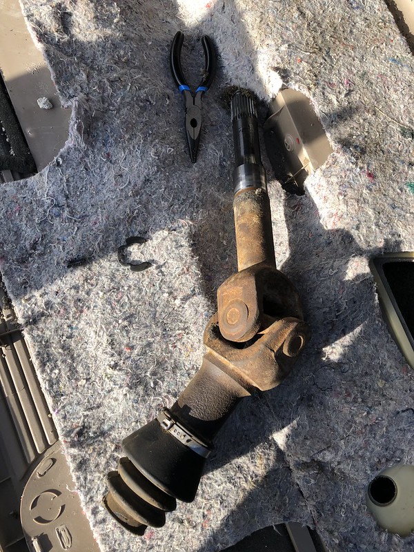

Found a second gen 4wd with the spindles and outer shafts already out of it... so I figure I am halfway there I might as well drop the diff and nab the inner PS shaft to complete my set of spare shafts.
After breaking the shock and almost twisting off my torx bit on the driveshaft bolts after two hours later I got it to here:
'85 Ranger Restomod
FYI at least at stock height you cannot get the diff housing out of the truck with the axle beams in place. I am so glad I did the eliminator mod to mine.
My leatherman would just fold up on me, that is a heck of a clip. So we crashed at the inlaws for the night and I went back yesterday with needlenose and popped it off on the third try:

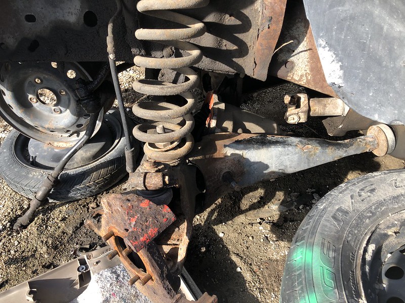

The scene of the crime:

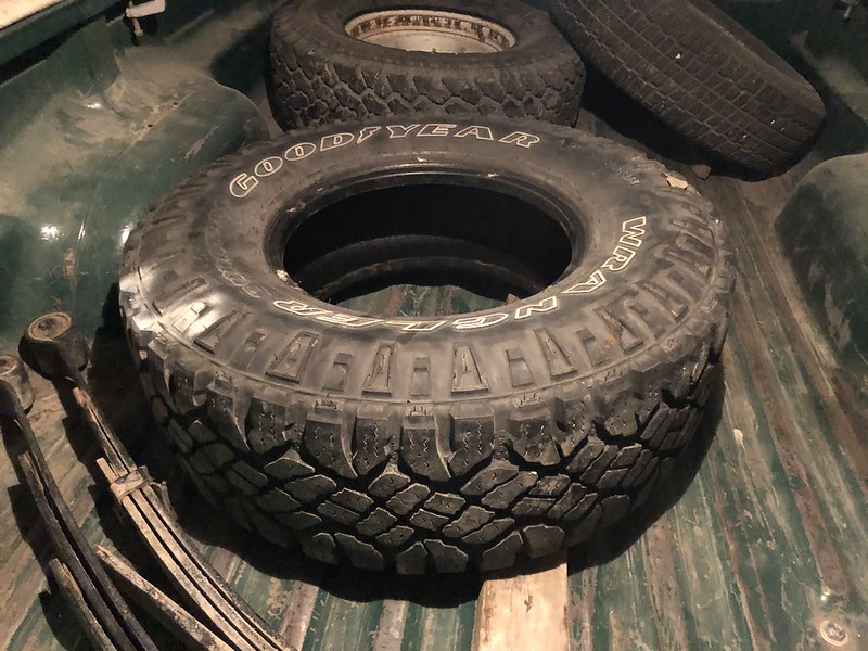

They also had a really nice 31" Duratrac on the rack so I grabbed that for a second spare (it is newer and in better shape than my current spare)

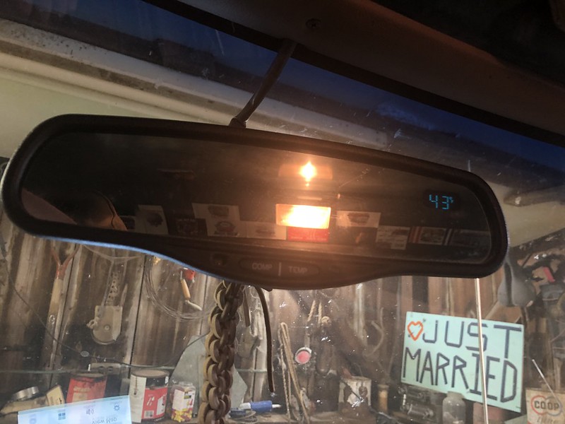

I also rumbled it to town to pick up hamburger and charcoal (holy flat spotted tires :oops:) My compass mirror also calibrated so both it and the thermometer are working great. Very happy with it, forgot pics though.

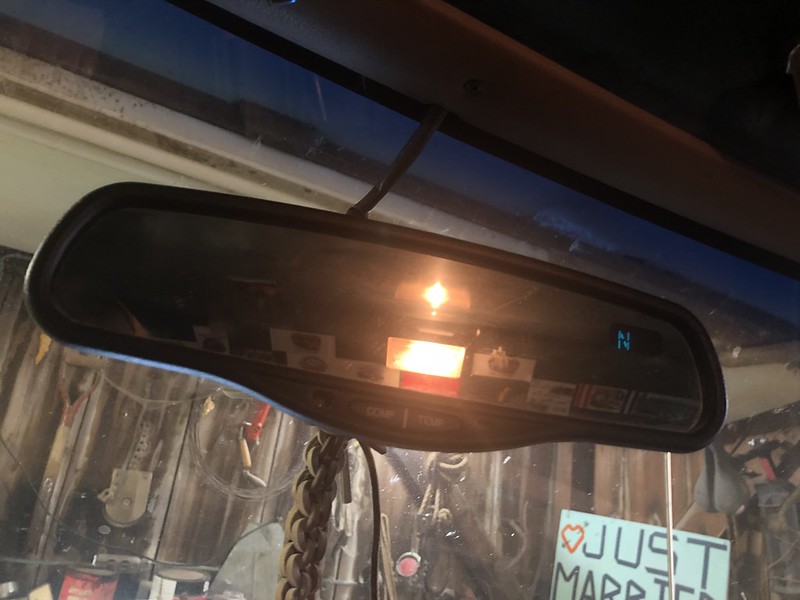

What did your compass mirror come out of? I have my stuff all set up for auto-dimmers, but I've been thinking about looking for a compass and temp mirror, just hadn't got to looking at what all I'd need to make it work. Also haven't had any yard time to look for one.
I have some of those pics too.
'97 Tahoe. It isn't the fancy one that shows both compass heading and temp at the same time, I have to toggle back and forth.
Mirror is retained by a torx screw (I think T20).
Ambient air sensor is in the lower center of the grille, goofy looking thing with two wires held by one screw.
Wiring is pretty straightforward, hot, ground, backup (so mirror doesn't dim when you are in reverse) and two wires for the sensor.
I am working on a writeup for it.

Compass:

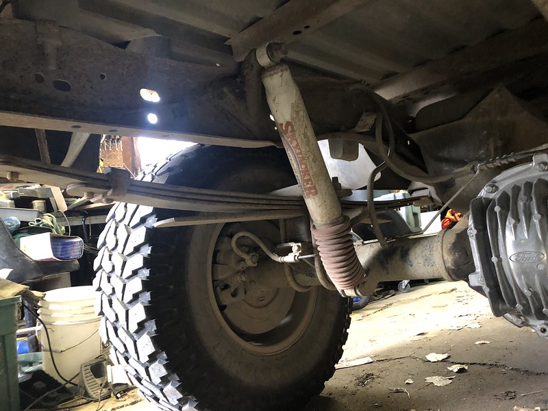

Going out to Ohio I was not happy with how the truck rode. Something in the back... just plain felt wrong. Like it was undersprung and it had a irritating habit of wanting to kick the rear end out to the left on big bumps. I resituated things in the back and got it to feel less undersprung but it still would like to kick the rear out. When I changed the diff cover I noticed the rear springs looked weird, especially the drivers side. It kind of has a "W" shape to it.
'85 Ranger Restomod
So I decided to put the Explorer springs back in and ditch the factory lift blocks to help with spring wrap. It is really weird, I have never loaded the truck much at all with these springs in it. They were out of a 2wd 2009 Supercab. Going back to the Explorer springs was going to be a quickie thing but I see the bushings don't look too hot... so I need to replace those too. I did start the teardown today since it was nice though.
'85 Ranger Restomod
Just playing with things I think the PS spring shackle is seized too... so that isn't helping my cause any either. I am going to go ahead and put the springs in it to see how the ride height works out and if I need to go to Belltechs to get the rear where I want it or if factory replacement shackles will work.
