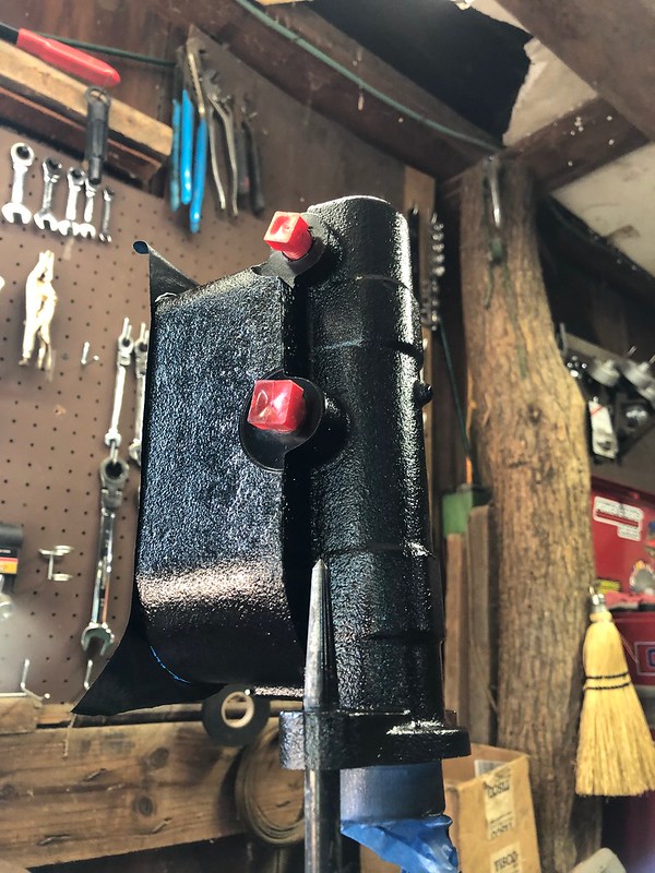

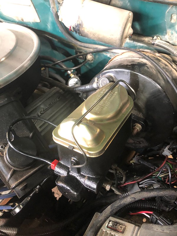

New master cylinder is painted:
'85 Ranger Restomodh

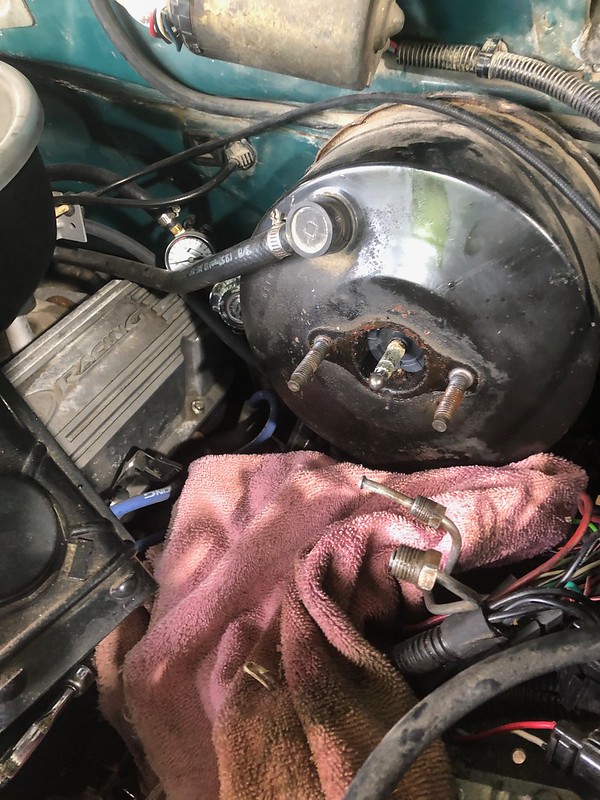

Old master off:

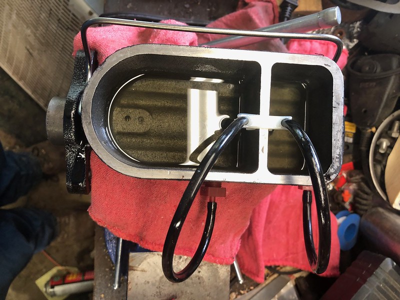

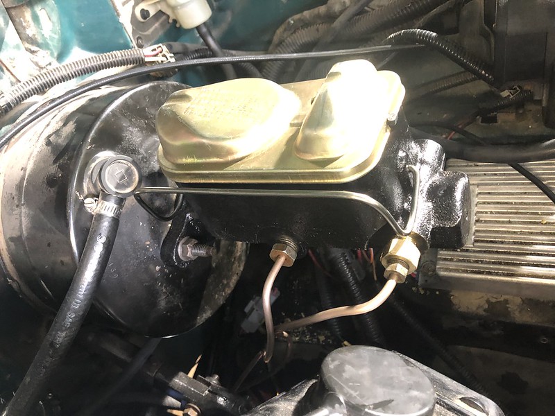

New master on:
'85 Ranger Restomod

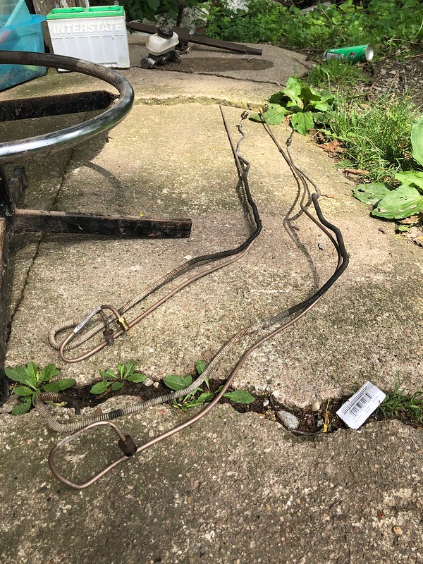

Brake lines bent at the bottom:

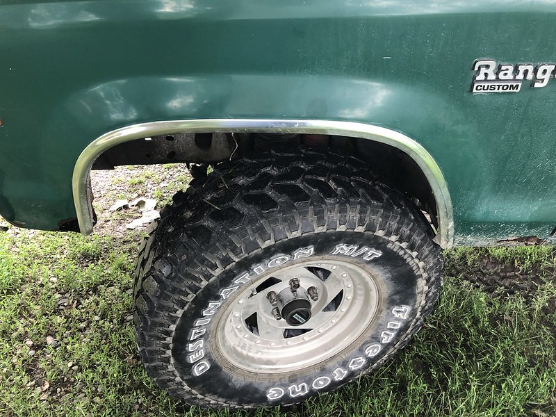

Check the body location, make sure I can't move the cab back more on the frame. For some reason the left wheel isn't centered in the wheel arch now and looking back at pics it wasn't before either. It is hard to gauge that stuff in my tiny garage and it hasn't been outside much. Everything cleared before the swap so I am guessing the increased track width caught me. From when we were welding the floorpan (having a photo record is really nice)
'85 Ranger Restomod
Two years ago before I did bodymounts it looked a lot better:
'85 Ranger Restomod

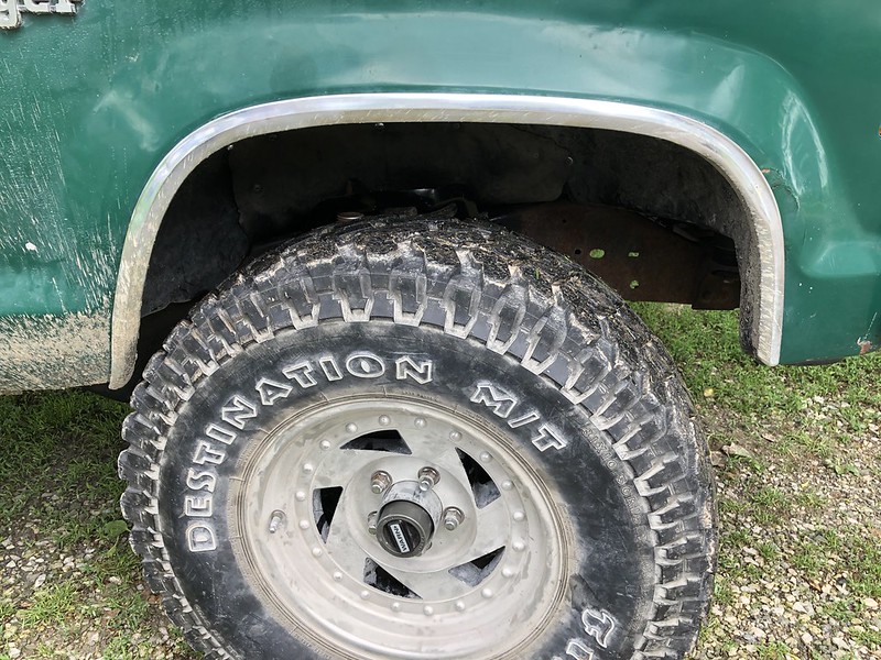

I also want to pull a wheel off and measure my offset, I want to end up with FX4 Alcoas maybe they would be the magic fix if my offset isn't right. It doesn't look like mine stick out much though.
If that doesn't work, trim.
Played with the toe some more, it was toed out too much which was sucking the front of the truck down.
Camber isn't perfect but it drives nice and only rubs occasionally, I am going to reserve final judgement until I get the thing aligned for real.

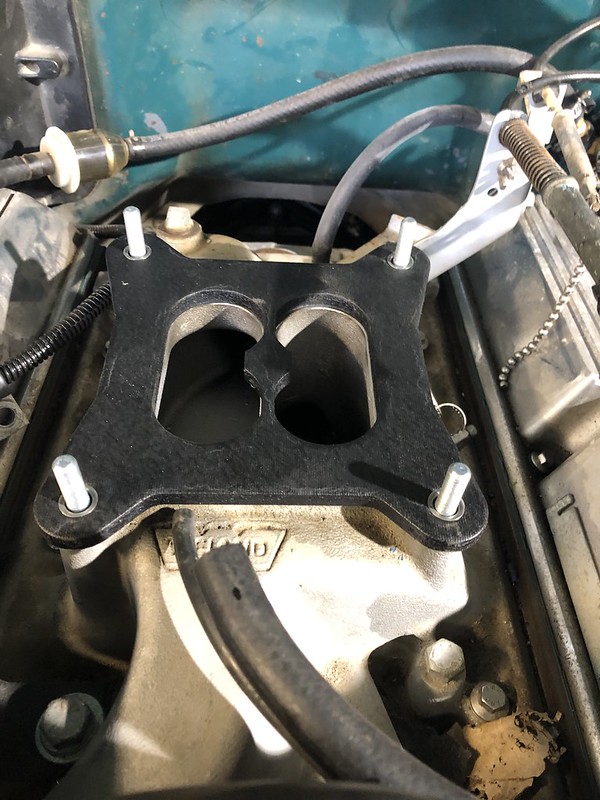

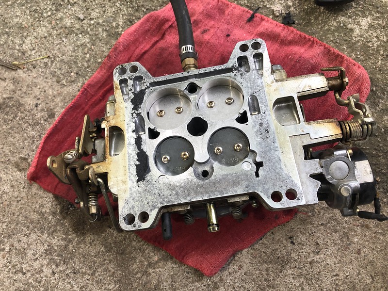

Been fighting terrible heat soak after ditching the 1/2 carb spacer for just a gasket to see if I could get by lowering the air filter housing that way.
I found a thinner Edelbrock spacer and threw it on this morning before it got hot. I thought it would be a quicky thing...
Of course the gasket had to stick to the carb so I had to pull it all the way off to clean the bottom gasket surface:

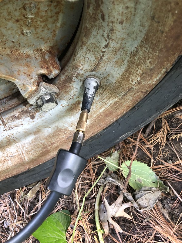

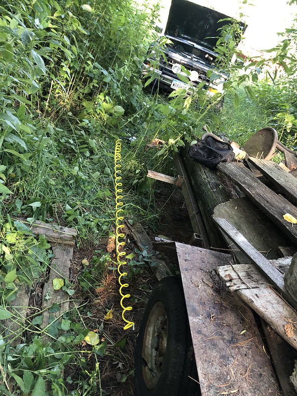

I got to test my 12V air compressor on a trailer tire, lots of reach and it seemed to work pretty good. It worked a lot better when I figured out the hose screws on the valve stem.
'85 Ranger Restomod
'85 Ranger Restomod

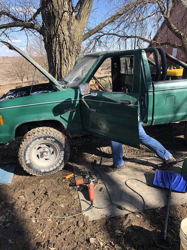

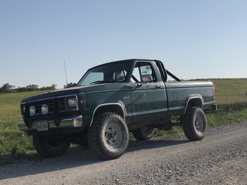

Went for a drive, realized the hood wasn't latched so I pulled over to do that. It was a decent photo op so I went for it.
'85 Ranger Restomod
