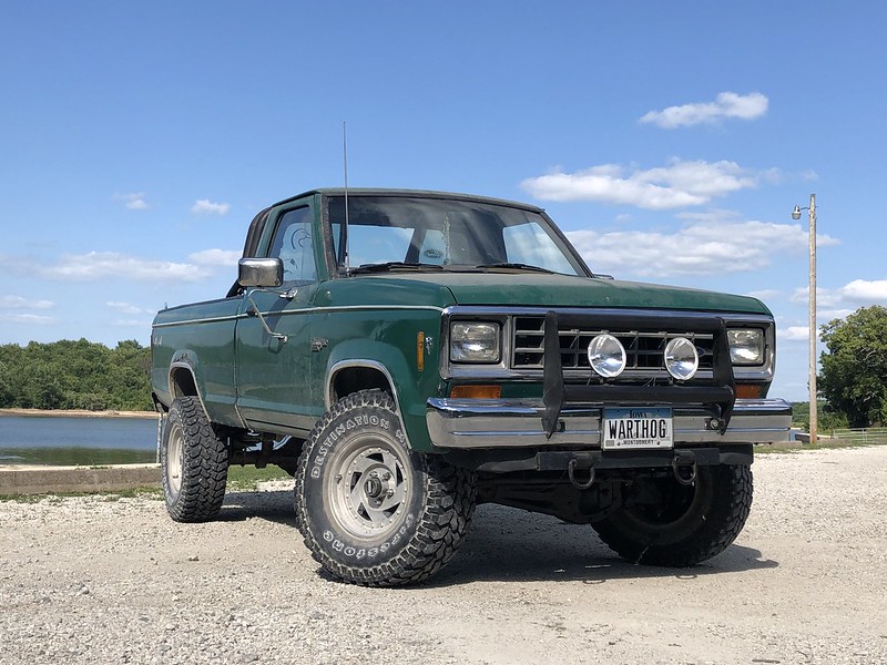

I probably put 30 miles on it today or better, went over to the lake to take pictures and lake was drained down (didn't figure they would do that this early in the summer) so that didn't work out very well.
The poles usually go between pontoon boats.
Otherwise the truck is driving great, it needs aligned badly as it is spooky on gravel though. Like the back wants to pass the front, I must not have the toe right yet. Cruise is getting better (BW1350 VSS retaining bolt is longer than NP205 so it bottoms out and lets the sensor can around) but it is still not 100%, it doesn't surge as hard it was but it would still get really freaking annoying going cross country. Otherwise it starts good, runs good, shifts good and goes down the highway good.
