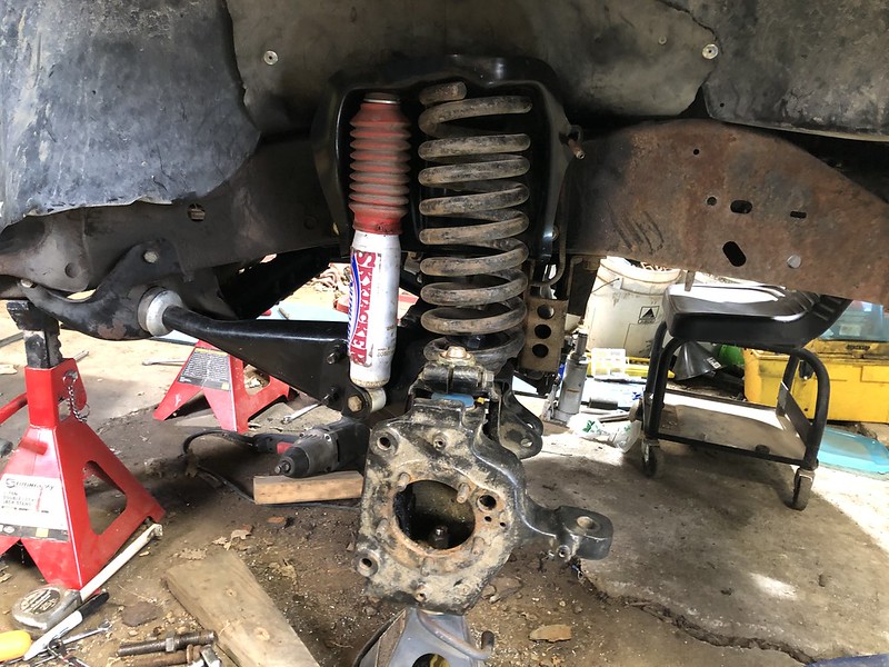

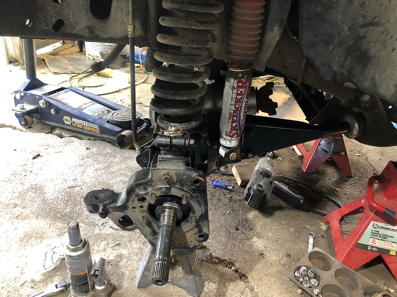

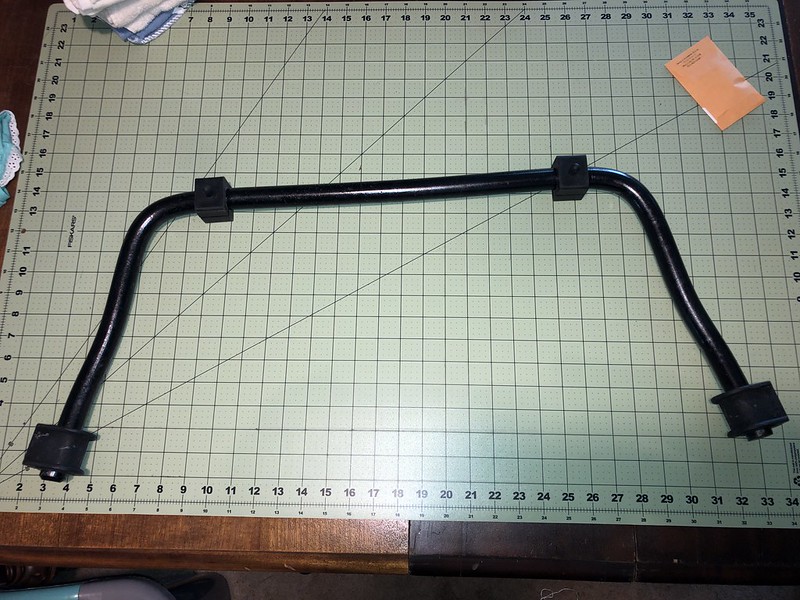

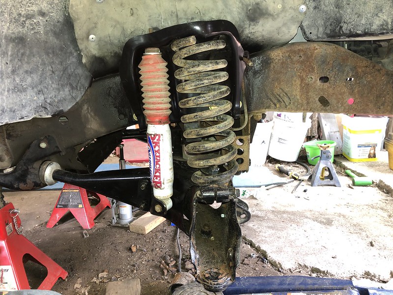

Sway bar is installed:
'85 Ranger Restomod

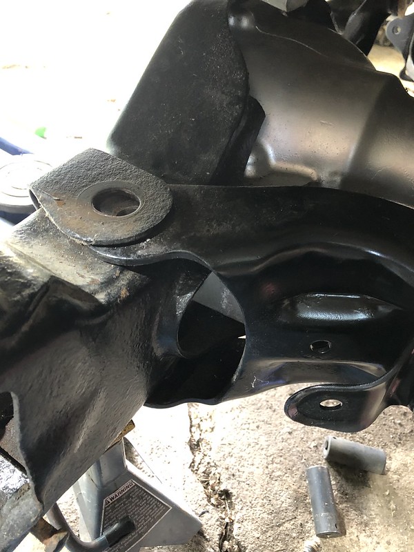

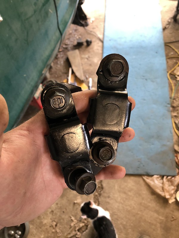

Had to take it a part a little to get the pinch bolt in:
'85 Ranger Restomod
Suspension is in:
'85 Ranger Restomod
Knuckle is on:
'85 Ranger Restomod
Knuckle is on, shaft is in:

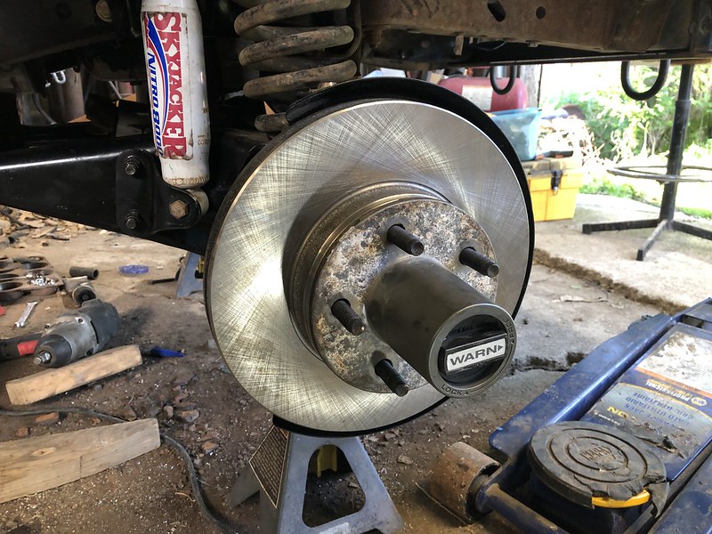

Both shafts are in, both dust shields are on, both spindles are on.
'85 Ranger Restomod

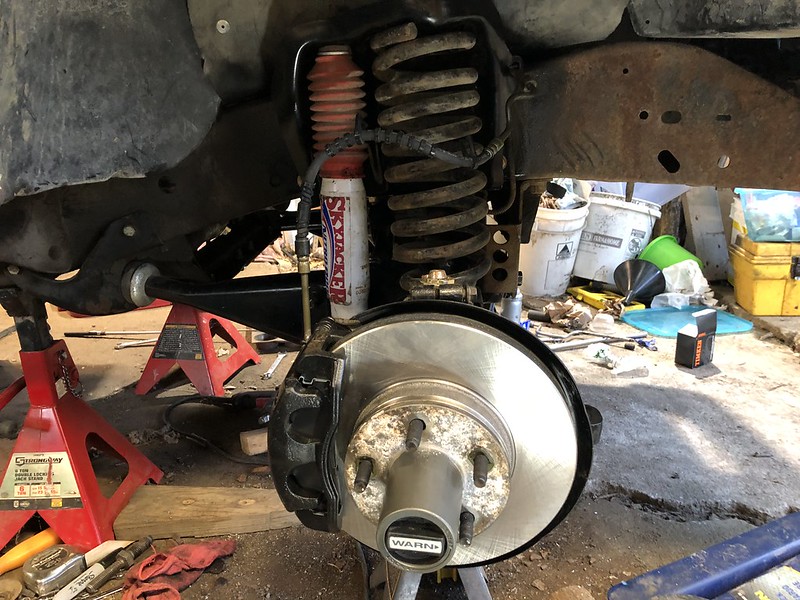

Then I decided to focus more on one side and get it buttoned up.

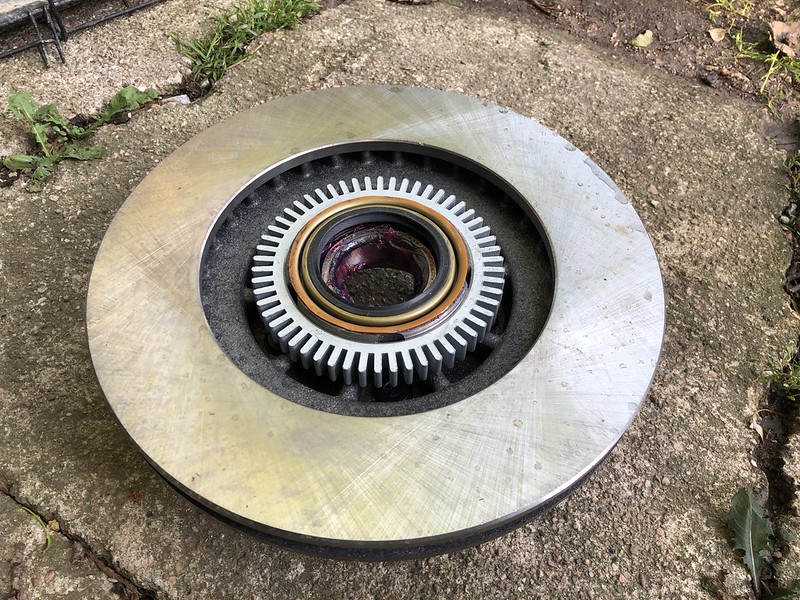

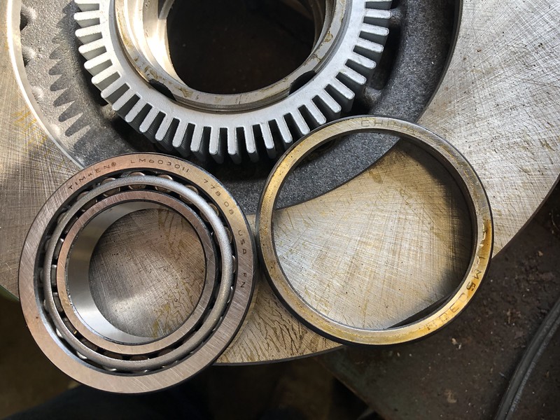

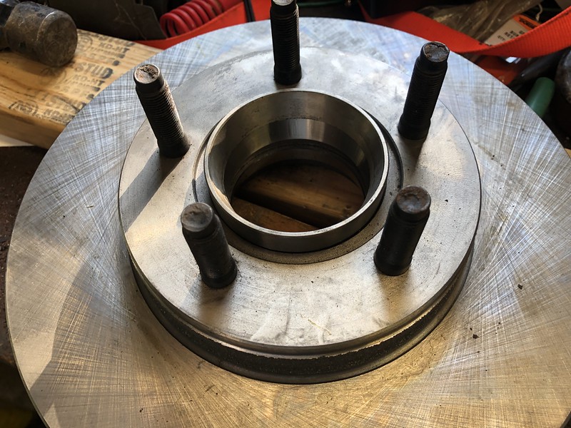

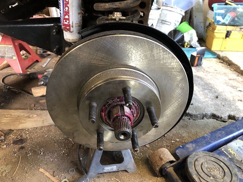

Sure nice for Bendix to include these bearing race drivers but I only wish they wouldn't put them in the hub....
'85 Ranger Restomod
I had bought bearing sets, seemed kind of wrong to throw away Timkin races for brand X probably Chinese races, sure enough they were brand X Chinese...
'85 Ranger Restomod
Bearings packed and seal installed. On a non related note if you ever feel without a purpose... just think of all the tag along ABS junk on this truck.

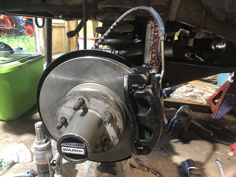

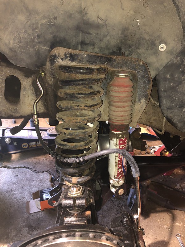

Line is on loosely, of course the hole in the spring bucket isn't right for the brake line...
'85 Ranger Restomod
'85 Ranger Restomod
Other side is done. Now I just have to hook up the hydraulics.
EDIT: One side is hooked up.

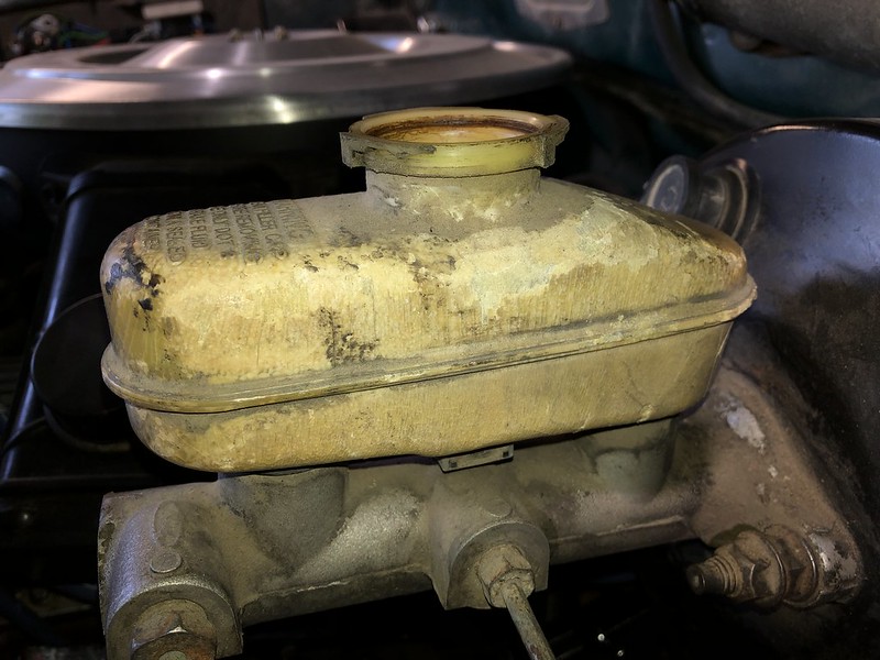

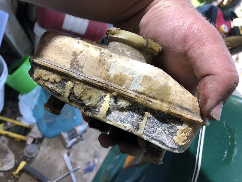

This thing has been a thorn in my side for years, it looks freaking hideous. The "Full" line broke off years ago the first time I tried to clean it. Kind of a PITA to change purely for cosmetic reasons though. Since the front brakes are dry I figured I might as well open that can of worms.
It didn't want to but it came off the truck. Weird stuff, almost like it is lined. Maybe 30+ years of brake fluid changed the plastic.

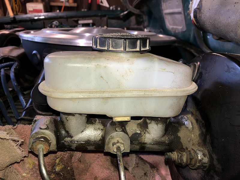

It is aftermarket but it looks a lot better. Factory cap fits it.
'85 Ranger Restomod
I probably should have gotten new seals too, I am not sure how well this master will work with the dual piston front calipers and rear disks so I didn't mess with it. Reserviour was a couple bucks at the JY, worth a gamble for that.
Looks way better! I've been looking for NOS reservoir for quite awhile with no luck. Have seen some in salvage yards but only slightly better than what I have. Also, nice work on the front suspension. I'm glad to see you get her back together.
Apparently they didn't age well, I have yet to find a decent looking one either.

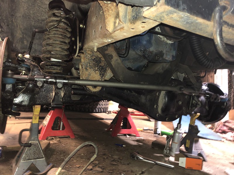

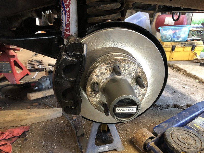

Mrs 85Ranger was a trooper and helped bleed the front brakes tonight, just waiting on steering parts to finish slowly trickling in.
Steering linkage is on, truck is supporting its own weight.

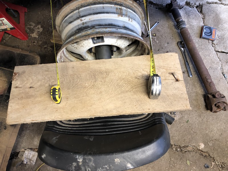

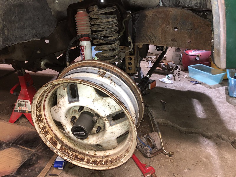

I got one alignment bushing to adjust, stuck an old rim on to have a good measuring reference to rough in the toe. Need to get something figured out on the other side and I will do the same.
'85 Ranger Restomod
High tech alignment rack, tapes are taped to the rim on the other side and I hold them like horse reins to actually measure.

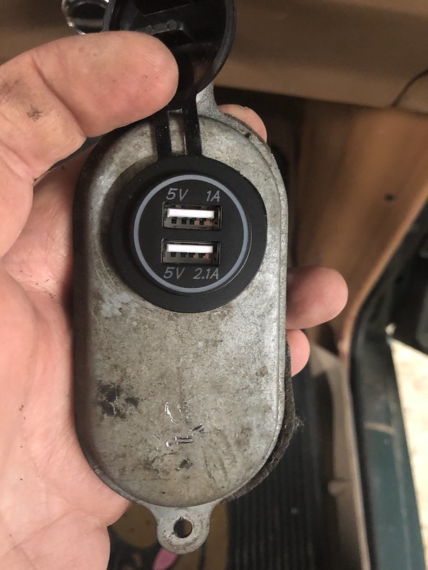

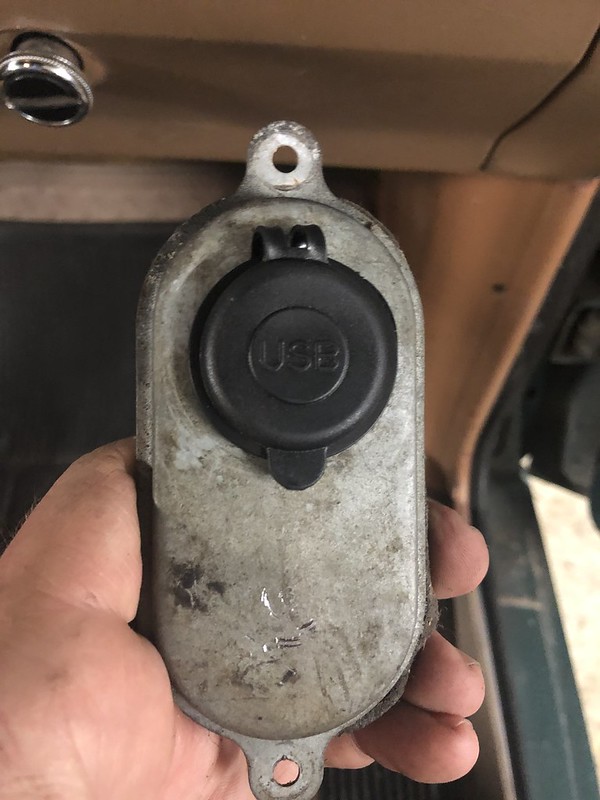

I got to thinking, if we do do Ohio with the Ranger I am going to be running out of charging room in the cab with the GPS occupying my only cigarette lighter. After a lot of thinking I came up with a place to put added chargers out of sight but still easily accessible... the cover plate from the ECM harness in the firewall.
