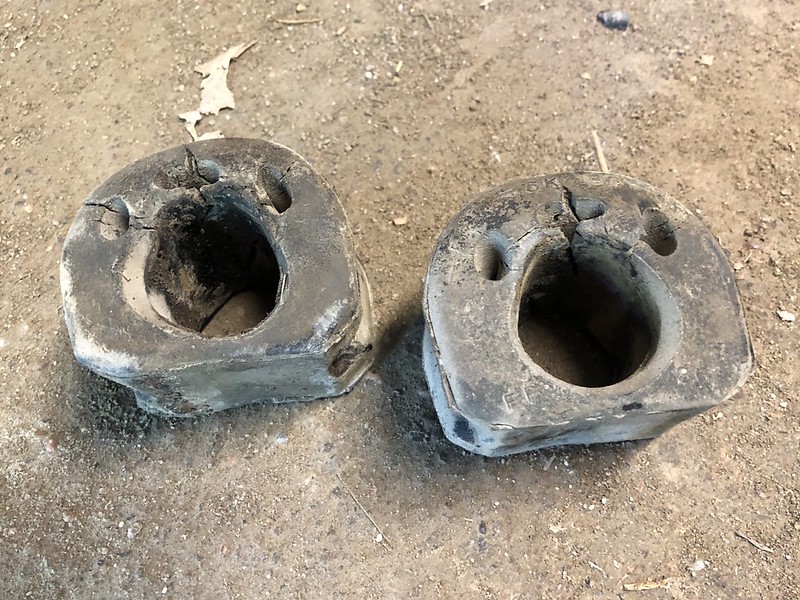

Mine were pretty shot. Swelled and petrified.

Sorry about the rust but glad you found it. Also, how are your sway bar bushings? I had a heck of a time finding first gen ones. Mine were NOS, though.
I found these in the trash in my garage. The crossmember ones were cut off and thrown in the dumpster at work, I ain't dumpster diving for them. ;)

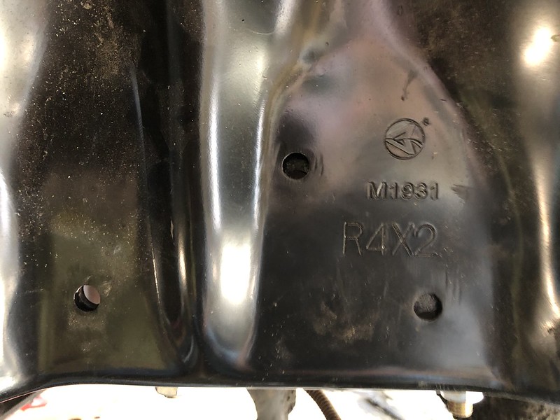

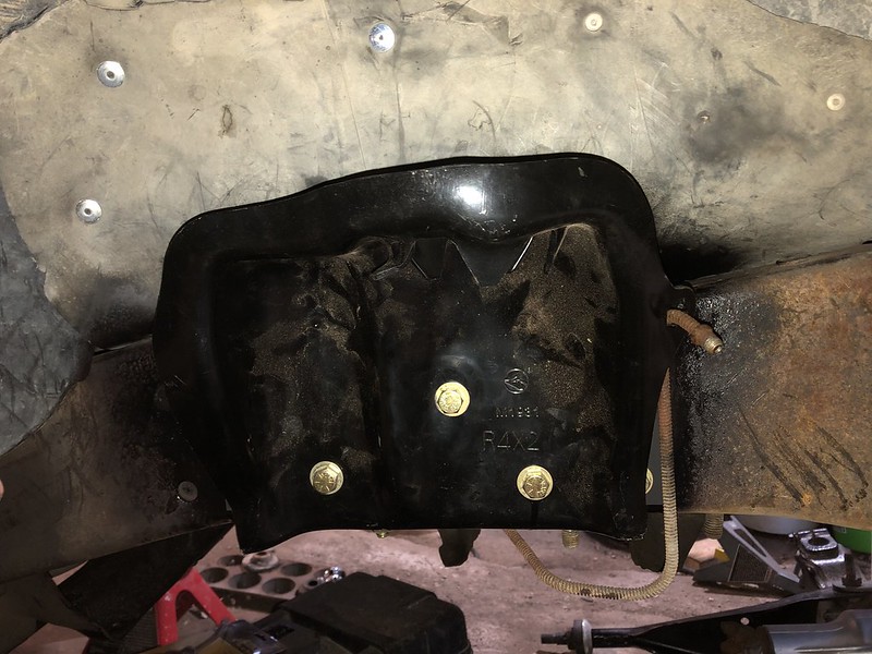

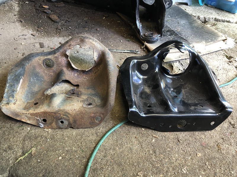

I didn't realize that the bumpstop didn't mount to the frame, only the coil bucket (center hole on bottom) Also front hole needs to be enlarged for the fancy bolt that also holds the pivot bracket. Otherwise everything on the bottom lines up.

the three side mounting holes are all just a little off.

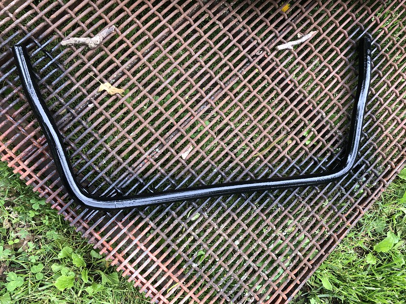

Sway bar is painted:

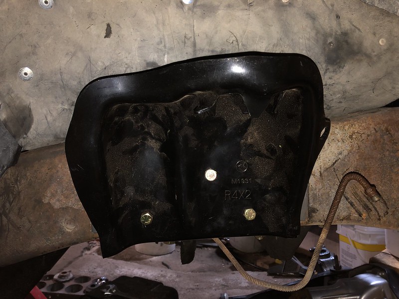

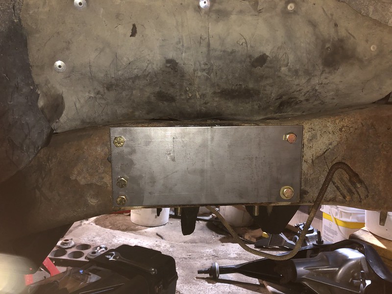

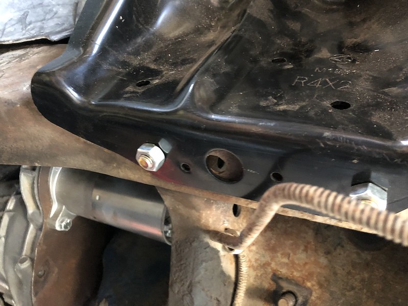

Plate bolted to frame, back bottom bolt caught a brace on the inside of the frame that bubbles up so I had to drill a hole kind of in the center:

Bucket bolted on:

Forgive my ignorance, but why a bolted doubler vice cutting out the bad section of the frame and replacing it with that plate?

Best I can do at the moment. No welder to weld it and the truck can’t go too far as it is.
Torn if I should weld in a patch or keep an eye out for a better frame for a final fix.
As near as I can tell most of the load is carried off the bottom flange of the rail, spring bucket is pushed in against the side of the rail... so it should be fine for a long time with the bolt in plate. I have good meat to bolt thru all around the hole, even the factory holes are still factory thickness. There is a lot of boxing on the back and the engine crossmember is right there too. I have done a lot of head scratching on it...
If I had a welder I would have welded it though. I don’t drive it in salt anymore which should help too. If/when I get a worthy welder I would like to revisit it.

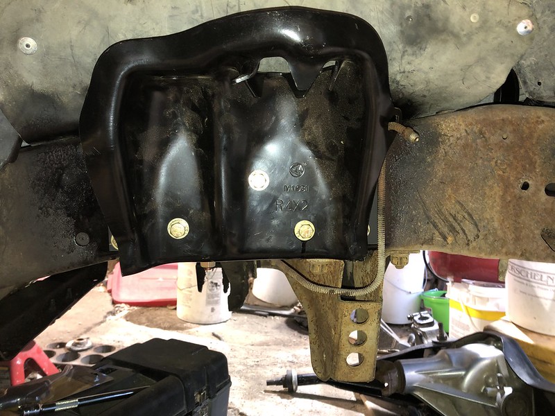

Spring plate and bracket are installed:
