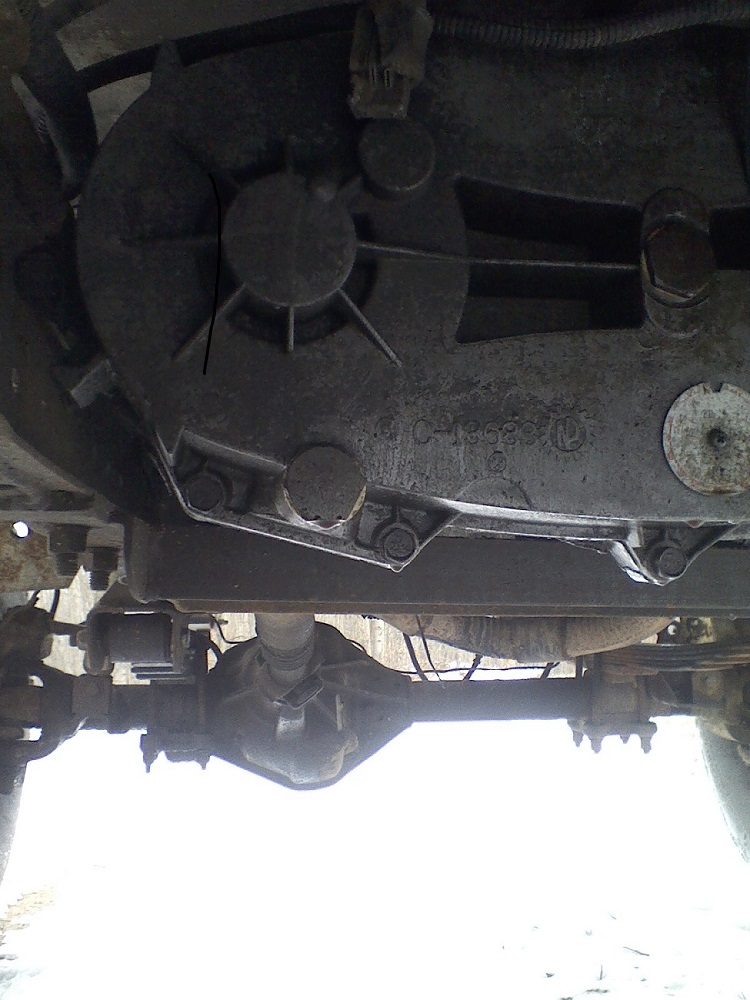

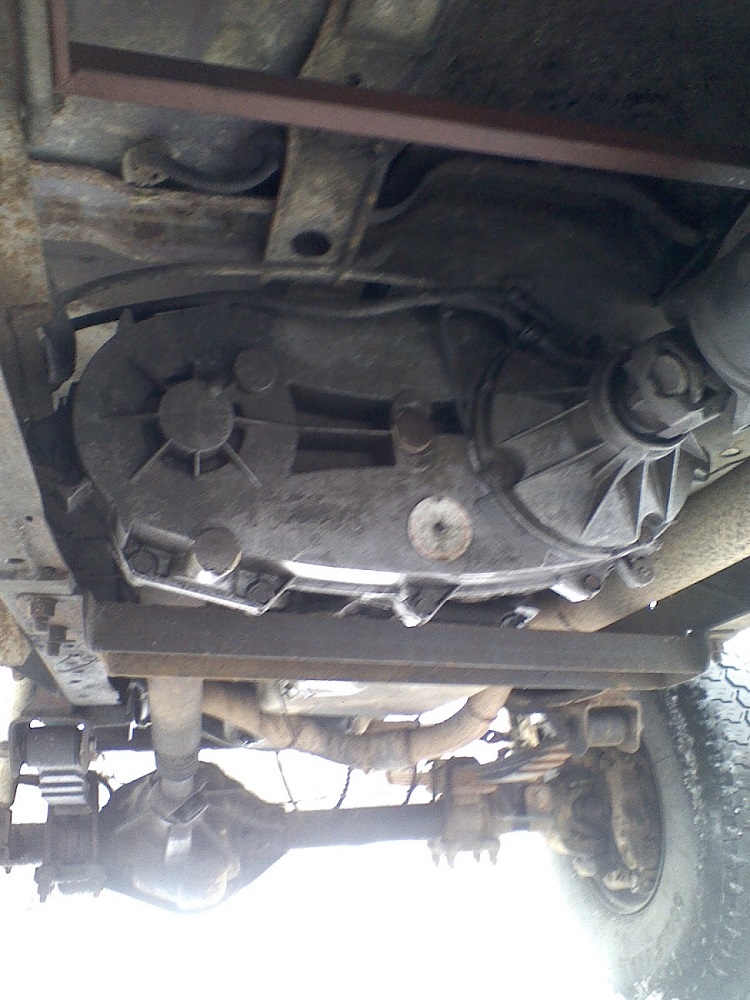

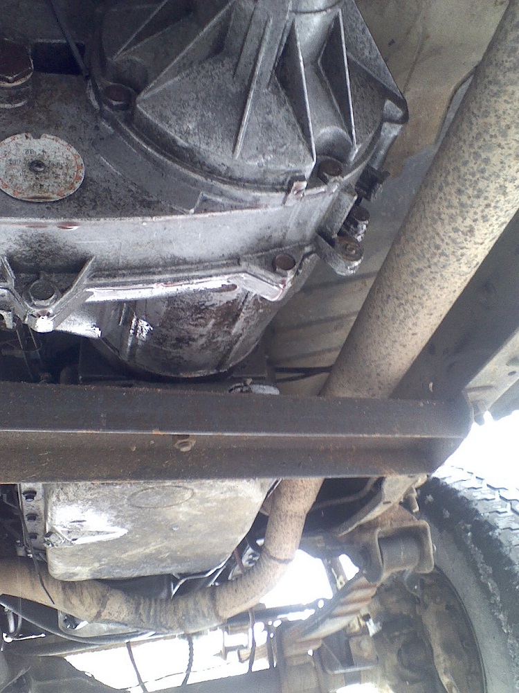

depends on chassis and where you want it.
I clocked mine a little flatter when I put the diesel in because I had to set the diesel lower to get to my boa goals and body lift equivalence targets.
the 208 is so easy to work with I ran it to get going, figuring a doubler or atlas before 10 years went by....
...... come august it will be 10 years my platform has been diesel.. been on front leaf 11 +....
