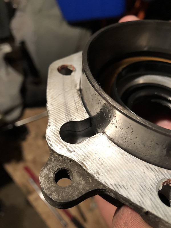

What looks like a crack below the top left hole is really a crack. On the fence about it, it won't cause a leak. More concerned about getting it torqued right and it not throwing off the input shaft bearing.

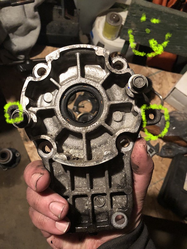

threaded rod with a nut and big washers and heavy deep well sockets in those holes your using....unless you have nice slide hammers....
or the marked bosses...ya know...:thefinger:
What he said.
Yeah, that occurred to me later after I saw that the slave cyl holes didn’t work so well.
Yeah, now that I see that picture of the plate, it's not actually the slave holes, it's the slave bolts, in the other holes.
I know it works on the R2 because I have done it.
Damn. Why would they make it different?

Note that their R1 graphic shows the ears on it too. Unless you probe the holes for depth (or have the right book) there is no way to know. Might be safer to just use the ears if you have them. I was doing mine on the floor in my cave of a basement so they were not so obvious.

Upon further inspection I declare that front retainer plate is hosed.
