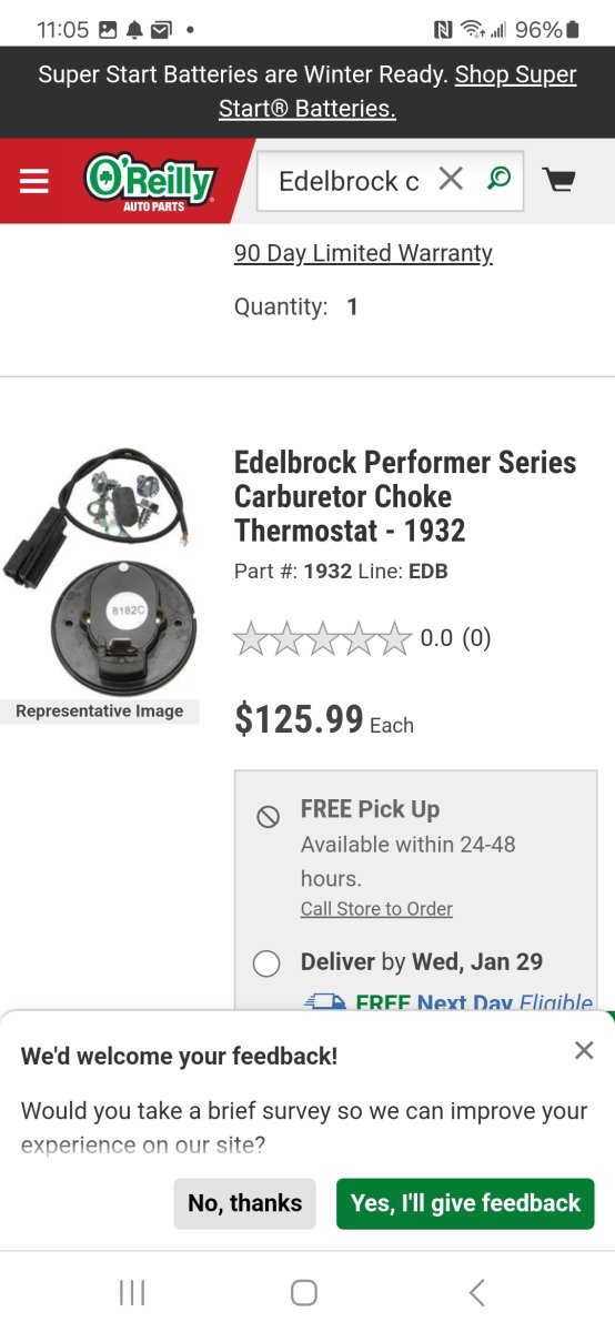

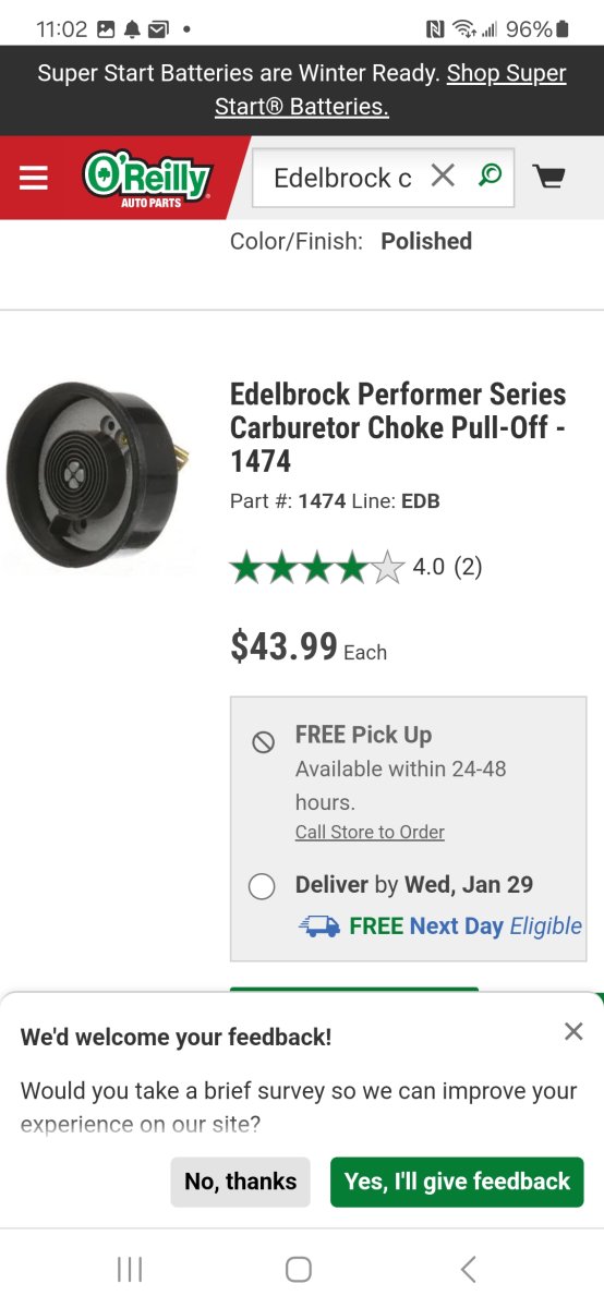

This... is not a choke pull off. That... is an electric choke thermostat.
A choke pull off is a vacuum over mechanical device that "pulls" the choke open a bit once it sees engine vacuum. This allows the engine to get air past the choke plate to run.

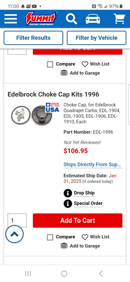

Edelbrock calls what I replaced the choke cap. Summit, jegs and orielly call it the choke pull off.
I don't really care what it identifies as as long as it does its job.
Goodness... they're all over the place. Nothing new i suppose... but the problem for me is to read what you type... all i can do is scratch my head and wonder WTF you're talking about.

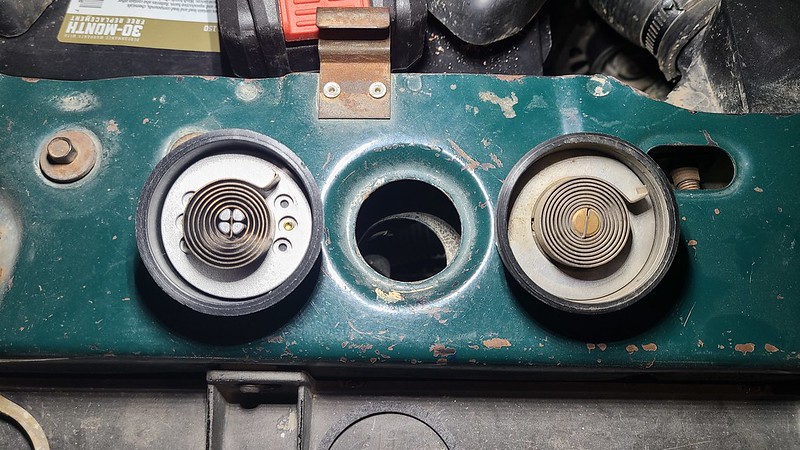

Mine is the middle one, it has two connectors on it. Not sure what the other ones are for (Edelbrock Quadrajet?!)
It is a mess, the vacuum thing you refer to I found to be called a "Choke Unloader" which seems to be a carryover term from Carter AFB days.
My Edelbrock manual barely mentioned it and only had one crappy picture.

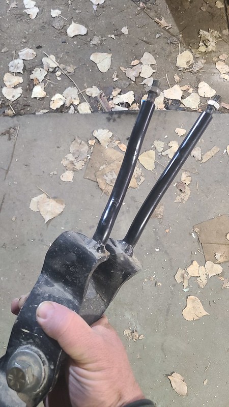

On the Kentucky trip I was getting a very annoying rattle from my 4wd levers at about 2500rpm and higher. Which means it was constant at interstate speeds. I found about halfway out there a half deflated empty pop bottle crammed between them just right would keep the rattle at bay until it would eventually shift and kick out.
So tonight I delved into silencing that noise.
In 2hi my levers are like this:
They can just barely touch, you can see where the paint is worn down to bare metal:
So I touched up the left/forward lever with the angle grinder so no matter what they can't touch.
That's funny. I have the same problem with my stock transfer case shifter. And the same temporary solution. I'm going to try to tighten up the rubber bushing in mine.
I did get it put back together last night, no more noise.
So I got that scratched off the list.
