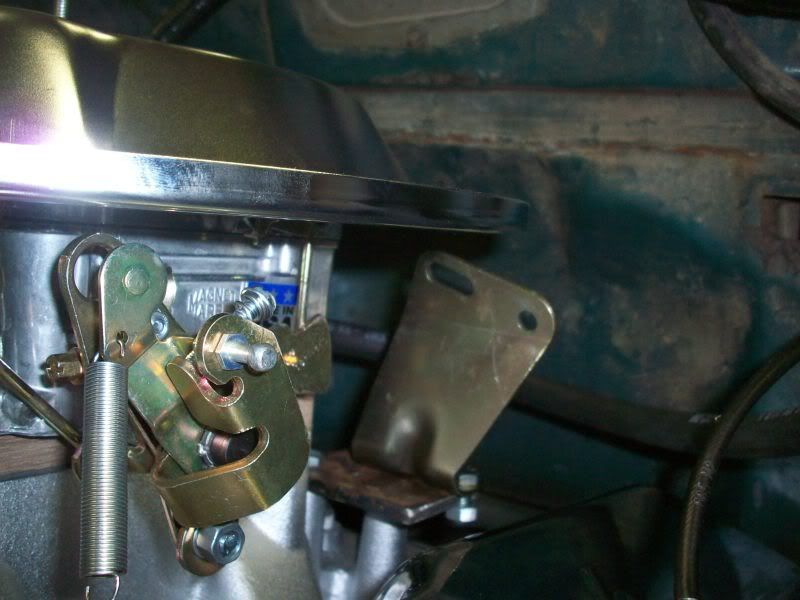

Trying to get the throttle hooked up now.
My stock cable works and clips on how it is supposed to, but the stock bracket that bolted on the back of the upper intake manifold is nowhere close to fitting anything.
So I ordered the regular Edelbrock cable bracket (part #1490)... of course no instructions included and I can't find a pic of how it mounts anywhere on the net. Dunno if I have to cut my stock bracket and bolt the part where the cables mount on the top of this thing or what is supposed to happen. :icon_confused:
http://www.summitracing.com/parts/EDL-1490/
It isn't pretty but is functional. Getting tired of this aftermarket crap with no or crappy directions.
I did find a tidbit in my linkage set instructions that mentioned that this bracket is intended to relocate the factory linkage and that bending or cutting the factory bracket may be required. Ok fine, I can handle that.
Stock bracket:
85 Ranger getting some teeth...
So I made a bracket to hold the thing straight, then I smooshed and trimmed my stock bracket and found some pretty serious clearance problems... plain and simple it wouldn't clear the air filter housing:
Ok so they were full of crap on that idea, the '80 F-350 service truck at work and my '78 302 had the same style of holder (I only have pics of the 302 one, I can't find it anywhere) with the slot and hole so it wouldn't work for even the factory 302 setup. Edelbrock carb, Edelbrock bracket, Edelbrock aircleaner, Weiand intake, maybe something is different with that.
So I got creative with the die grinder. It isn't pretty but will work for now. Going to continue research and see if anything else will work better but I haven't found much really yet.
The cable isn't straight, but I did that to try to relieve some of the pressure on the cable. Down the road I think I will probably need a different cable/holder setup but this will be good enough to see how it runs and get me around for awhile.
Look for an accellerator cable bracket off an early 70's 302. Should bolt right on and line up perfectly.
