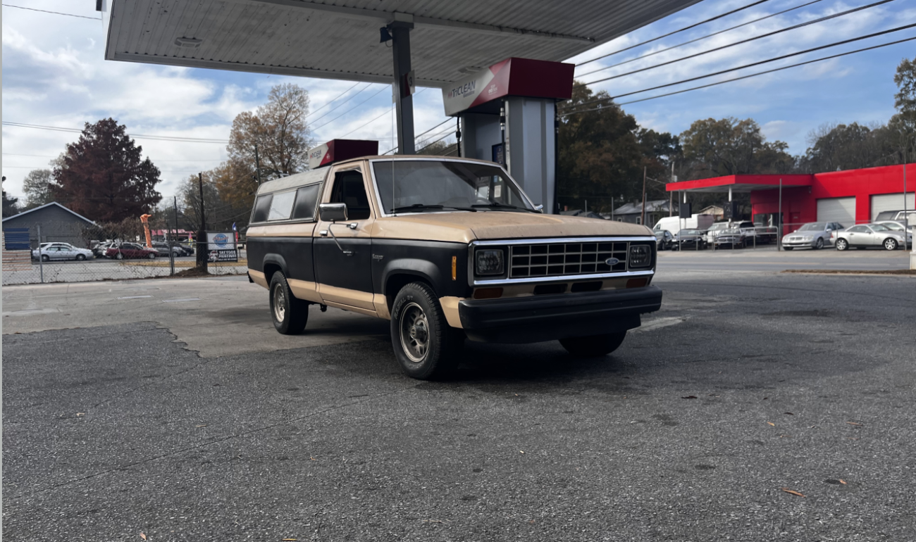

After a 5 year hiatus of mental and fiscal stability, I made the decision to harm myself with another project
Carb'd 6cyl, RWD, Manual.
This and a 300SL - Practically identical
Mostly unmodified aside from the brown paint but I love the way it looks.
The junkyard gods were also kind enough to bless me with a Duraspark system that will be going on shortly.
There's a laundry list of small issues that need fixing:
First carbureted vehicle I've owned and what a way to start... idle is high and full of misfires.
Fuel tank wont accept more than a shot glass of 87 at a time so I'm guessing that's a kinked or collapsed filler neck.
All the window rubber is rotted. Door cards are trashed. Pretty sure it needs a clutch and throwout bearing.
and all the instrument gauges are dead.
It's good to be back. Bring it on.
