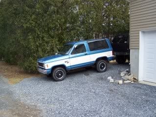

Ive had this truck for a long time, the run down 84 broncoII carb 2.8 4spd w/ od manual, manual hubs and tcase, 165k miles bought it from the orig owner....
the game plans..
Solid axle swap.....most likely a jeep dana 30 since a wagony d44 is soo hard to come by.. no coils for me leaf springs, custom brackets built by me, shackle in the back, just dont know wat type of springs yet(jeep or yota?).. 8.8" rear, 33x12.5r15 pro comps,4-5" lift
but what should i do about the engine... i need to be reiable, the tranny shifts great very lil slop...should swap in something else, or just dura spark and put a bigger 2bbl carb and replace the gaskets
at the end it needs to be daily drivable, cruise at 75-80mph down the highway, and wheelin every weekend....oh yea im most likely gonna sell my ranger when its completely done
