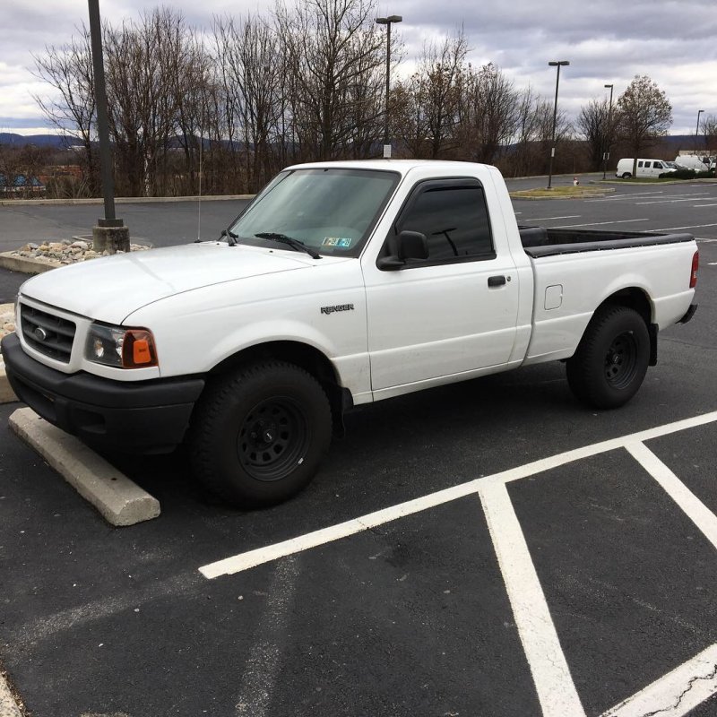

So I've been out of the ranger game for the last 7 years. My last one was an 86 Ranger with dream beams and a flip kit, and I loved that truck, but I sold it when I joined the Air Force. fast forward 6 years later, I'm out of the Air Force, and traded my 2001 Dodge Dakota quad cab for a 2003 Ford Ranger. I immediately knew I would be doing several things to make it my own haha. first picture is the day I got the truck, stock except for rim/tires, tint and headlights.

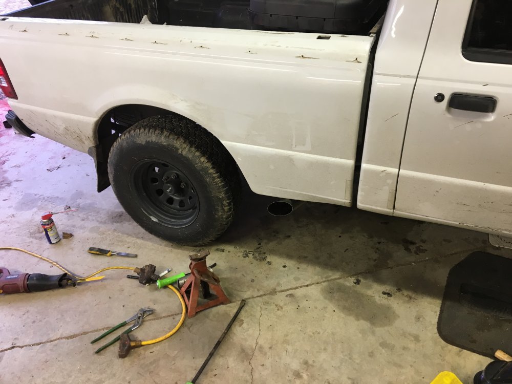

First thing I did was hack off the stock muffler and tailpipe and did a side pipe with the resonator as the muffler

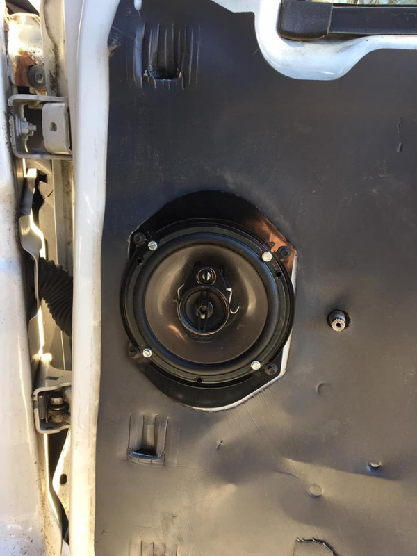

Then I replaced the factory speakers with some 6.5 pioneer speakers, using adapters for the mounting and plugs, so no splicing whatsoever

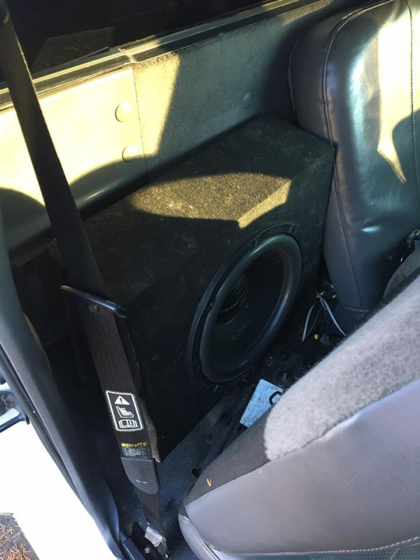

Threw in a single 12 in a slim truck box I had laying around with a 1200 watt amp on the passenger side so I don't lose any legroom!

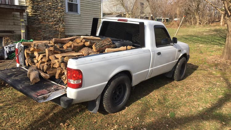

Used it for hauling some firewood a few times, it did pretty decent for a 2wd 2.3 5-speed truck

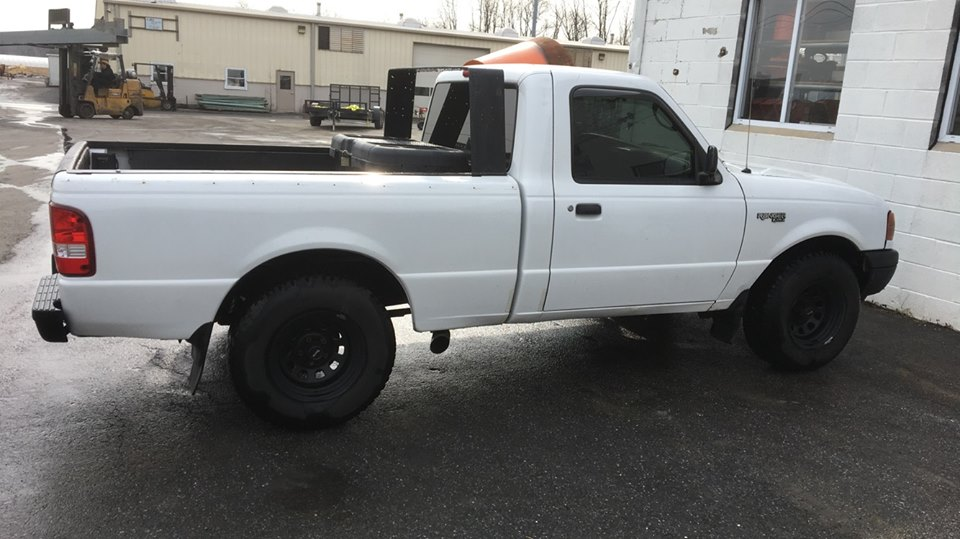

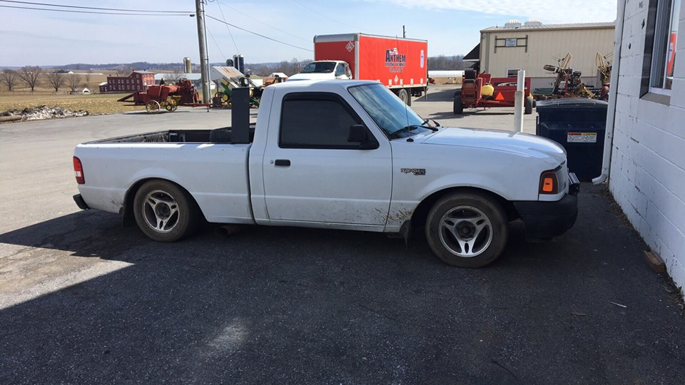

It stayed like this for a few weeks, only adding my headache rack that I got from a company fleet truck in the area, and mounted some LED's to it and my front bumper.

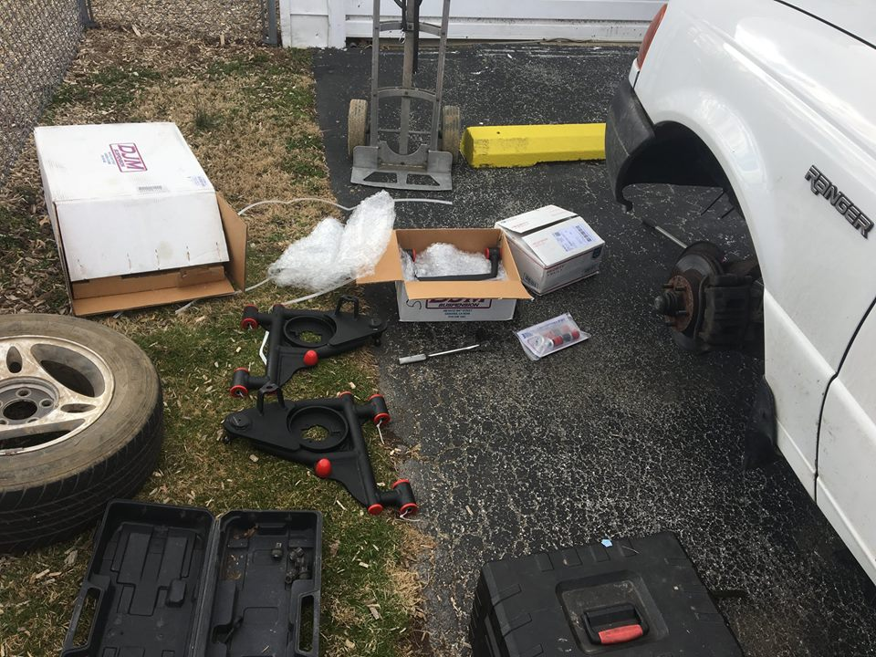

But then I started ordering some parts :) I originally bought 3 inch drop springs and a flip kit and drop shocks, but discovered the drop was too much
for stock control arms, and even with camber bolts it was way off. That and my lower control arm was resting quite firmly on the bumpstops making for a harsh ride.
25939
When I originally put in the DJM control arms, I used my 3 inch drop springs I had bought prior. but that made them bottom out bad as well, so the next pic's stance was only that low for a day or two.
25940
Then I took out the 3 inch drop springs, and put the stock spings back in, but those made it sit way to high and it was so tight I almost had no bounce to the suspension at all.
25941

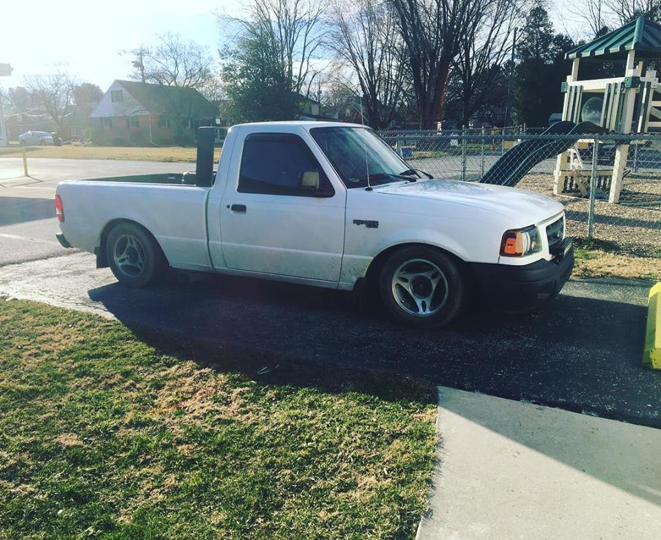

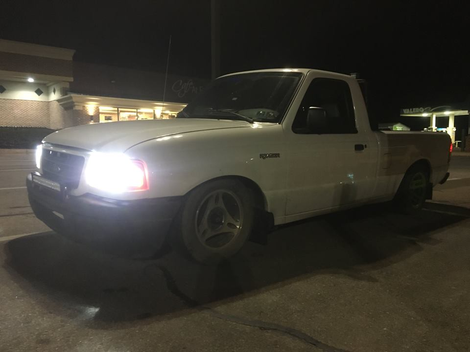

After figuring out the drop springs were too low, and the stock springs were too high, I decided to just cut one coil off each stock spring. That seem to do the truck nicely, as now it was dropped where I wanted it, with no bottoming out and actually had some suspension travel.

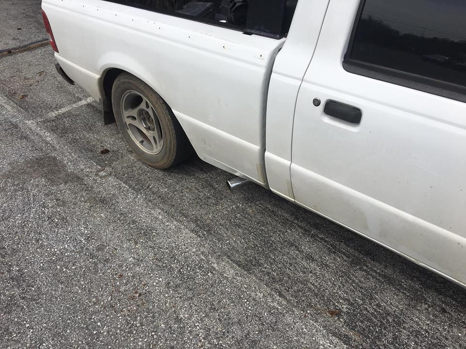

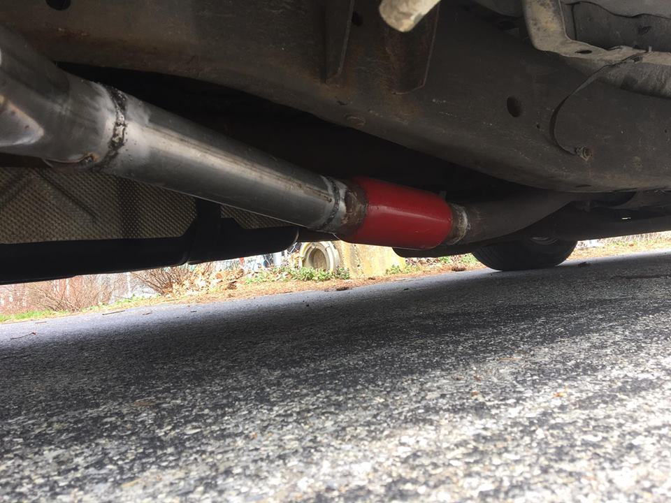

Now most recently i've bought some new tires, and plan on putting those on my black rims that came with the truck, because obviously the 235/75R15's were way too big. The mustang rims are only temporary because that's all I had to fit for now. Still waiting on the tires to come in but they should be here in a few days. In the meantime I changed my exhaust again, because the factory flex flange was getting quite wiggly.
Still comes out in the same area, just changed the tip
25943

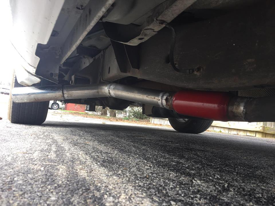

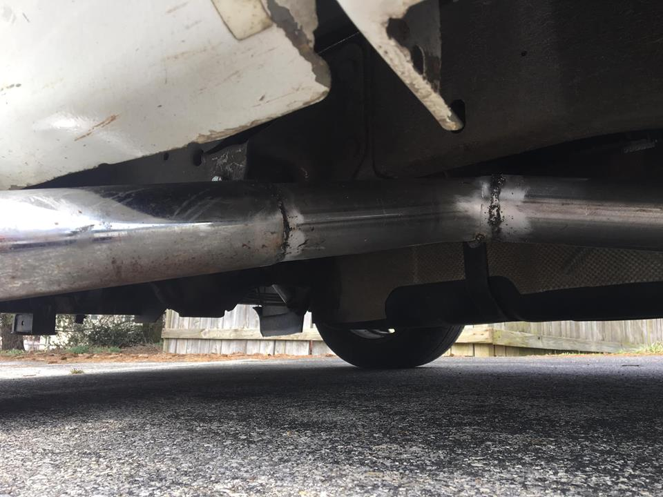

Since I cut off the flange and resonator, I added a short glasspack the same size as the resonator was, which worked out well. Also found out that the piping before the factory flange was 2.5 inches, so I used some 2.5 inch pipe I had laying around to fab up the rest of the sidepipe and it seems to work pretty well, and doesn't hang down near as low as it did.
25944
25945
Welding isn't perfect but its getting better. I don't think it's too bad for a harbor freight welder and some mig wire lol Zero leaks too.

And I can still use the truck as a truck lol Although the rear has maybe 1/2 inch of travel even with pancake bumpstops, so I think a c-notch is in my future lol. Stay tuned for more updates, new tires/rims should be on soon followed by a notch for the rear

Quick update, I got my new rims and tires on and mounted, installed my c-notch in the rear and have been loving this thing so far. I do need to do some more dremeling on the front lower control on mount on the rear mount, as the DJM LCA's hit there before they hit the bumpstops, which I found odd. Not sure if it is because my ranger was wrecked and fixed at one point, but still an annoyance.
