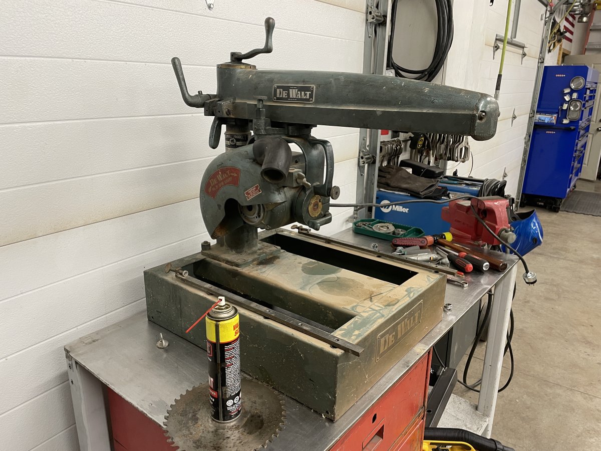

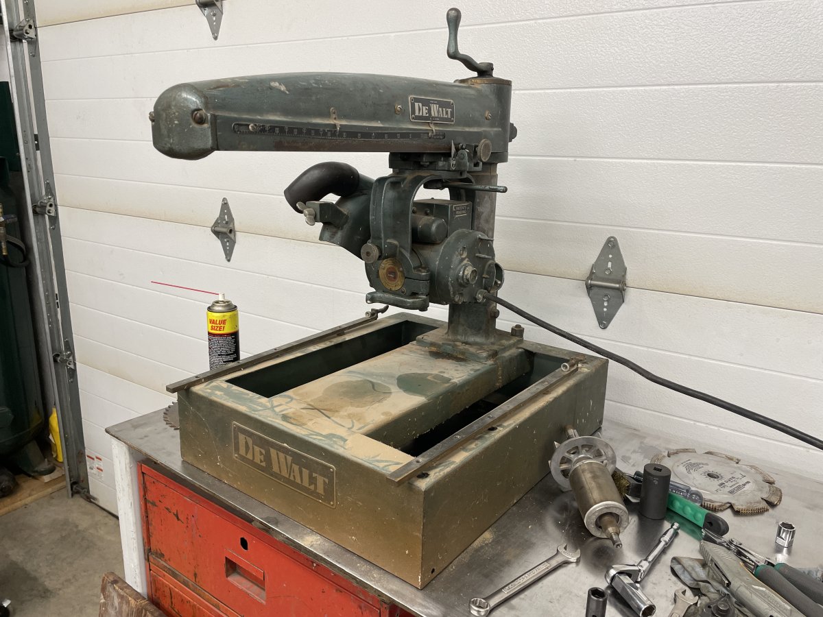

No shortage of projects, the rest of the afternoon was spent taking apart an ancient DeWalt radial arm saw from the 40's that I won at an auction for $1.26... needs a couple bearings which are now on order.

Pic of deWalt ras. I have one from early 50's waiting for refurb.
Will definitely post a few - it's a model MB. Motor needed both bearings replaced so it's in a bunch of pieces at the moment, and I need to build a table for it. The one that was on it is awful chewed up and missing the fence. I suppose I should rig up something to test it with before I spend a bunch of time building a table.
I was never real interested in radial arm saws until I got this one. I think it will fit right in with some of my other vintage equipment.

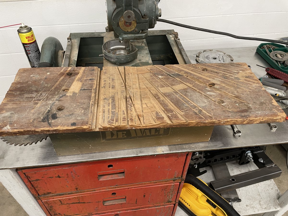

This is the junk table I need to replace, I'm glad to have it for a bolt pattern!

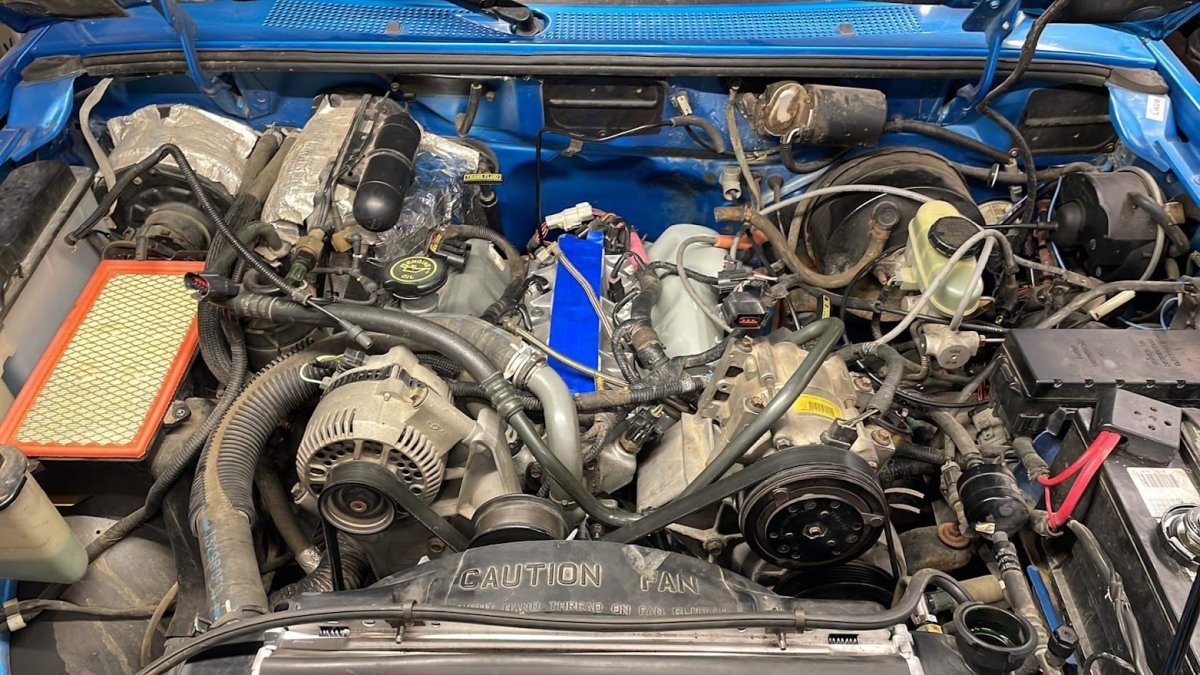

And just to keep this thread on track, here's a couple pics while I patiently wait for injectors.

They have a bad rap. You need to use a blade with a negative tooth rake to help prevent the saw from grabbing uncontrollably. Lots of people didn't know, or were too cheap to use those type blades, so got hurt. Any saw is wanting blood. It's your job to prevent it.

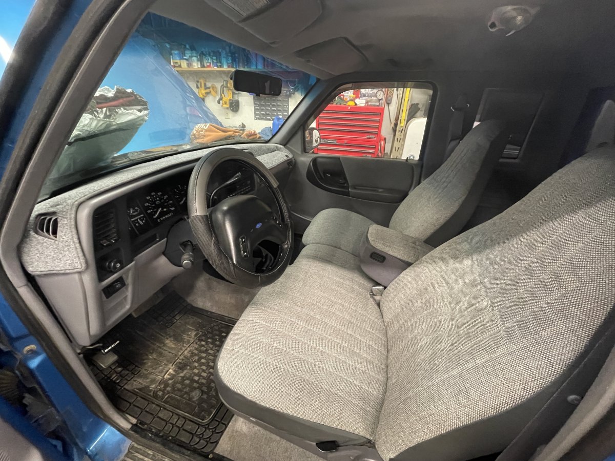

Seat covers and dash cover installed:

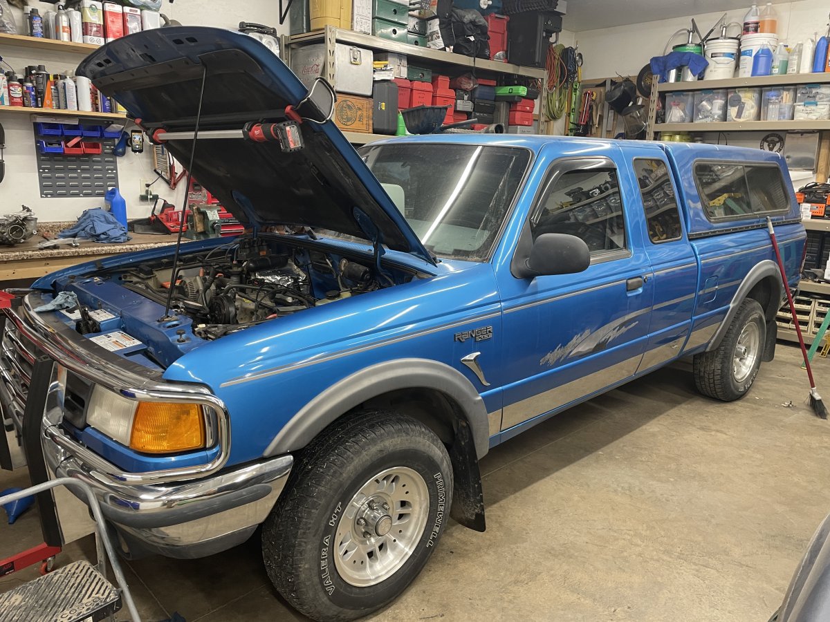

Well here it is, in all its glory...finally out of the shop and on the road.
