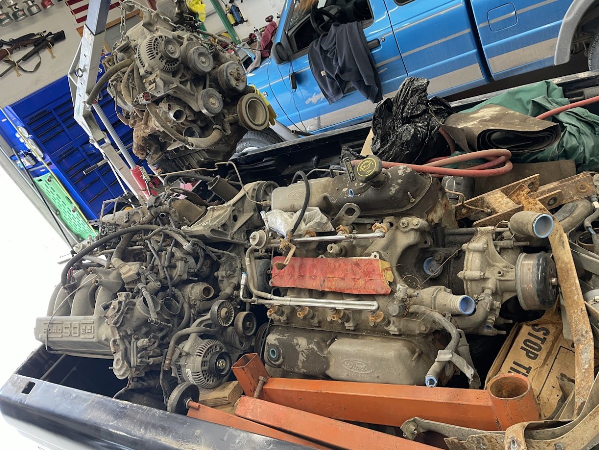

Here's some proof that you can haul two 351W's, a 4.0 and a whole lot of junk in a short box Ranger pickup box trailer - it's a real treat every time I need to get something out of here.
Some collect coins . . . some collect baseball cards . . . .
. . and some collect Ford engines.
Well every time that I think I might have enough junk, my common sense takes over and I remind myself that I need more.

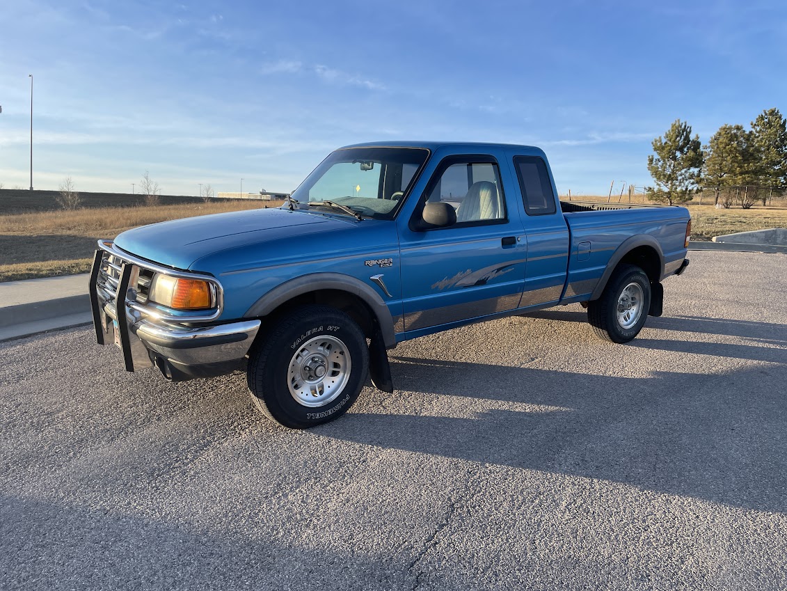

Sometime I will tear into the original engine and see what's up. I'm not in a big rush now. Drove the truck to work today & washed it this evening, cleaned up pretty nice.
Your ranger is turning into a good looking truck. I like the progress that has been done.
Thanks, just wait till I get a 5 speed, manual t-case, 3.73's or 4.10's, about a 3" lift, 31's, different wheels, headache rack with some lights & a tool box... My wallet is already hurting lol

This truck needed tires pretty bad, the rears were at about 15% and the fronts were better but weather checked enough that I don't want to run them on a daily driver. I was a bit nervous about how 31's and 3.27 gears would interact but it's actually not terrible. Probably just speed up my 3.73 swap a bit. 31's were the ultimate goal on this truck and these tires are pretty old so I figured I'd burn them off rather than buying a new set.
