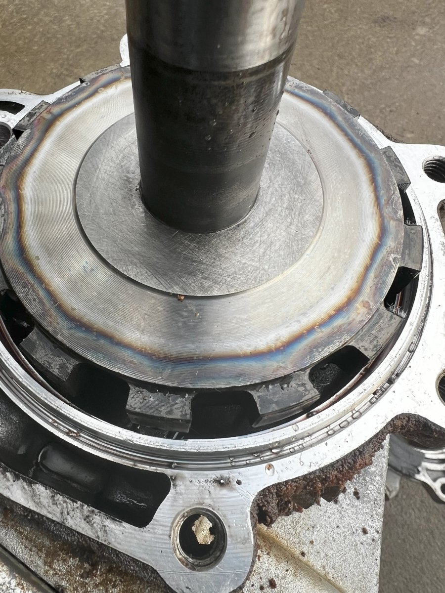

Ok guys...it's been a minute but I've finally gotten around to dropping the transmission yesterday and got the case cleaned up so that I can get started on tearing it down. I don't have time tonight to really start on it, but I did remove the extension housing because something looked odd to me. It's obvious that this transmission has had some heat issues in the past that more than likely contributed to it's failure. I won't be able to tear down the transmission until this weekend but I wanted to ask....is the bluing on the planetary gear an issue going forward, or is it just an indicator of previous overheating and nothing to worry about as long as the rebuild is done correctly?
Thanks!
  • 5R55E - DIY Rebuild?
the sharp difference between colors indicates a fast action, not prolonged overheating.
thats induction heat treating.
grab a couple different sharp tools and scratch both areas. you will find the dark area is harder.
it's normal.
this is where hard parts get to be a pia.
