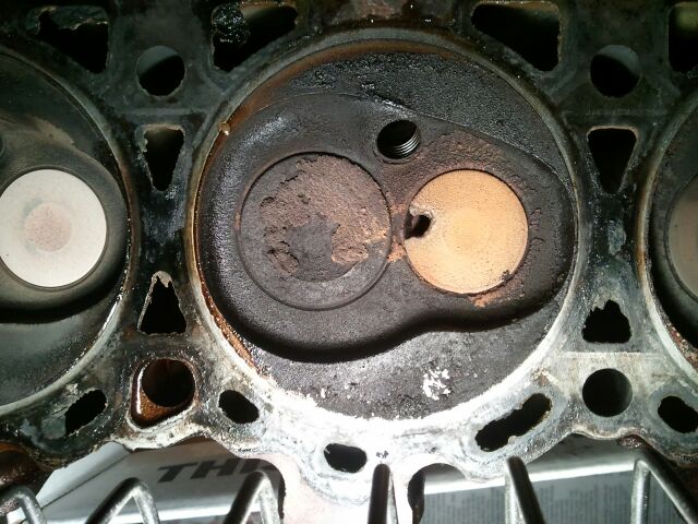

problem confirmed
pulled right head, exhaust valve burnt as expected. thinking of just replacing valve & seal... have heard different opinions on levels of fixes, wouldn't mind more input before reassembly. one valve & seal? one valve & all seals? full valve job? informed views welcomed.
burnt exhaust #5
Just burnt #4 on my 3.0 and by the time i bought valves, seals and had a machine shop go over the headit would be almost double the cost of a re-man head. i paid $150.78 for a reman head with valves, springs, and seals... ready to install!
new heads coming, getting new rockers/pushrods from delta. will monitor bottom end closely... pics & stories to come
