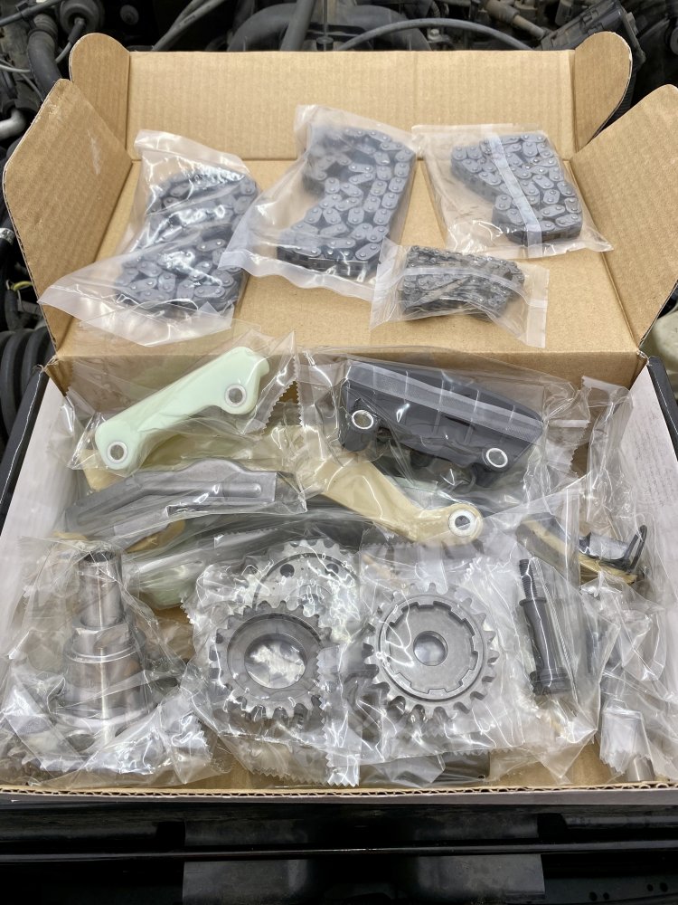

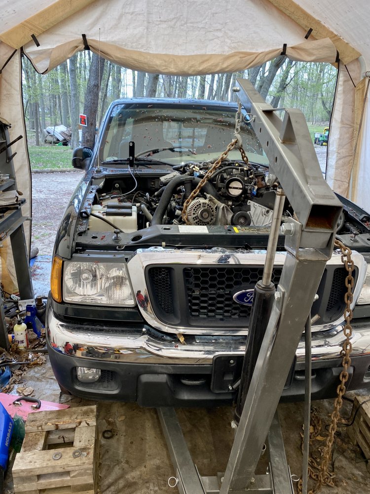

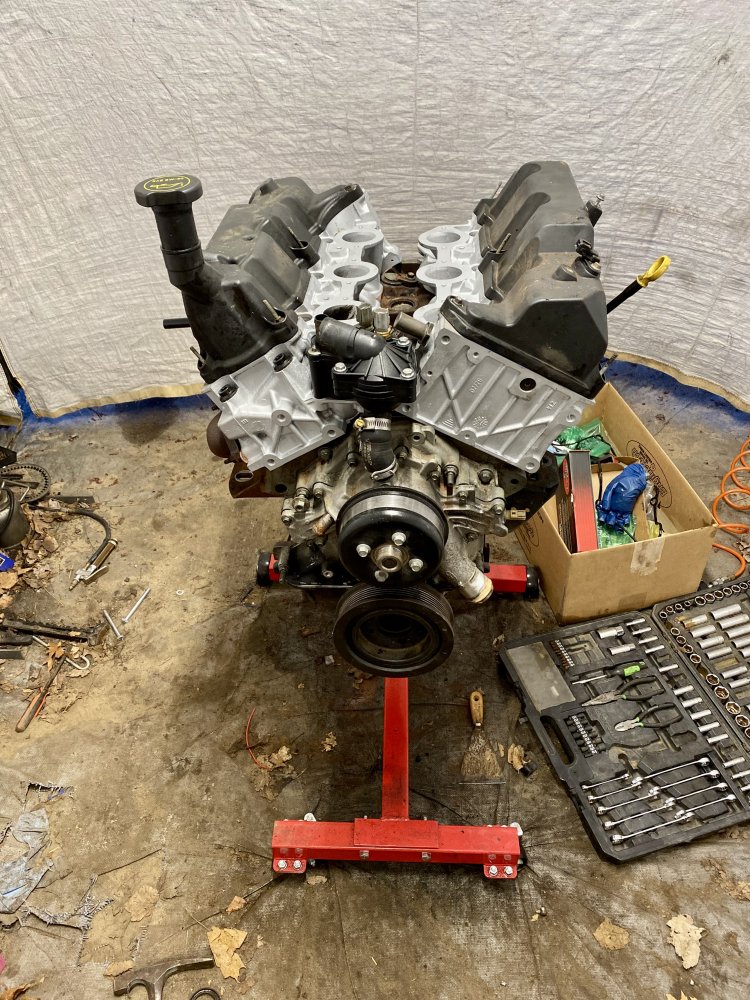

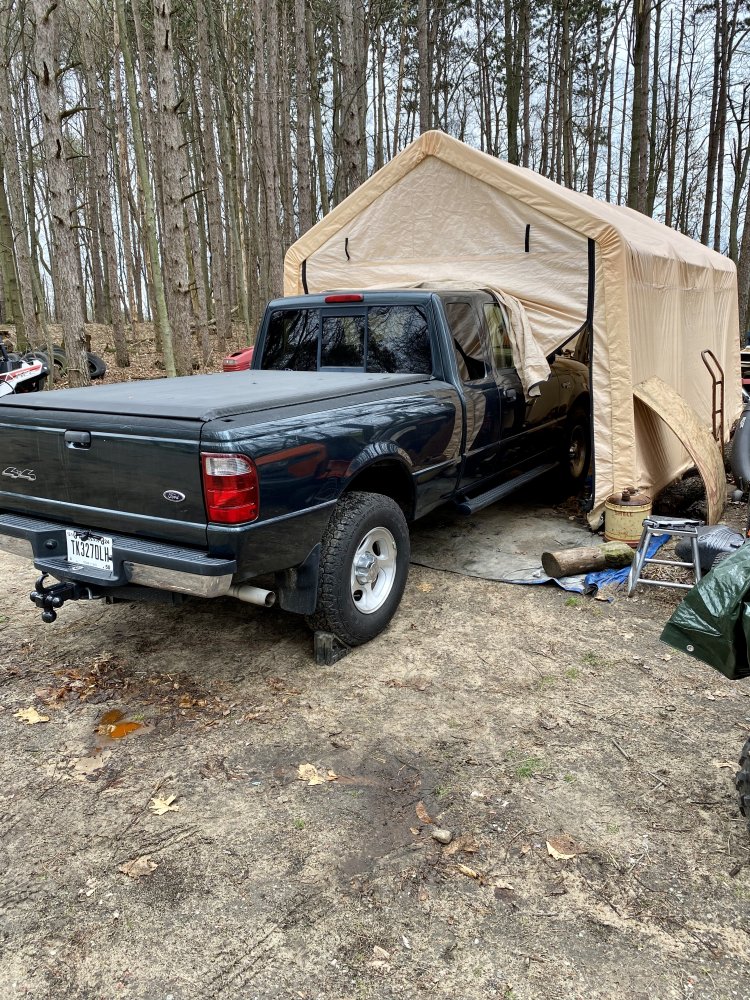

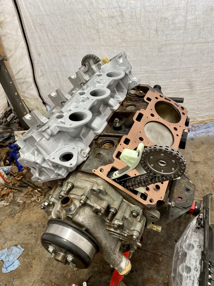

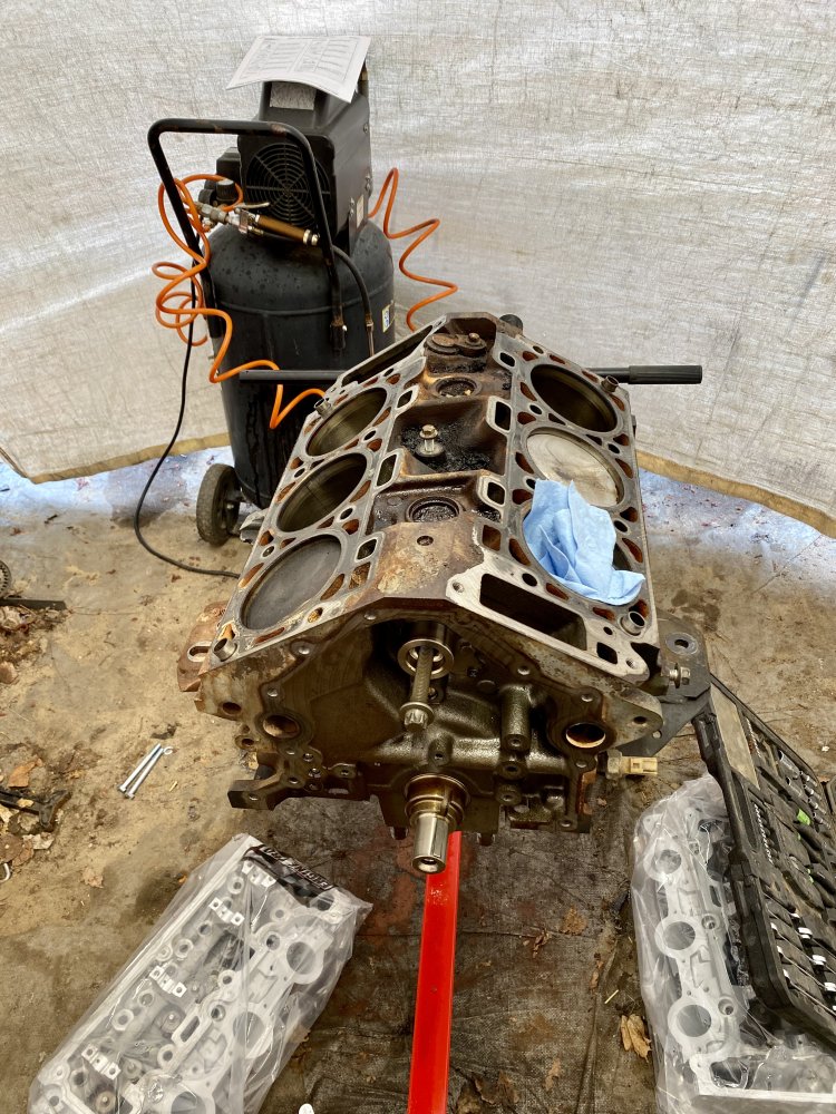

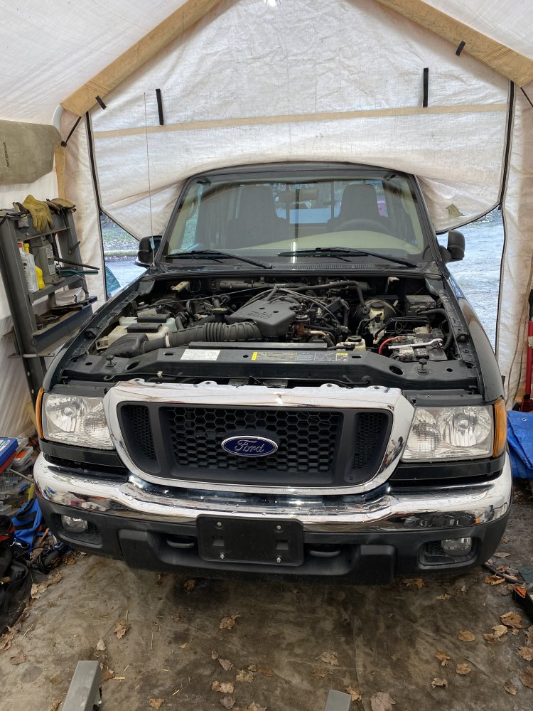

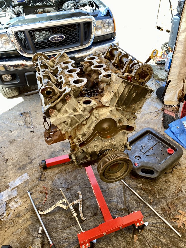

Here goes another one in Indiana! I went down to Tennessee to pick up a 2004 ranger with the 4.0L that had a blown head gasket at 81,000 miles and not a speck of rust. Got this green beauty for a cool $1000. But I only bought it because I was the proud owner of a 1998 mercury mountaineer with a 5.0L (got it from Michigan for $200) and I’ve been waiting to swap it into the perfect donor. Now that I have the two trucks, it’s time to get to work. I already pulled the engine out of the Ranger did the head gaskets on it, had the heads worked, resealed the whole engine with new gaskets, did a new set of timing chains and tensioners and put it back in the truck just to make sure it was a good motor to sell, now it’s time to pull the entire powerplant out of the Ranger and get it sold for project support! Check out the pics, you can see my process.

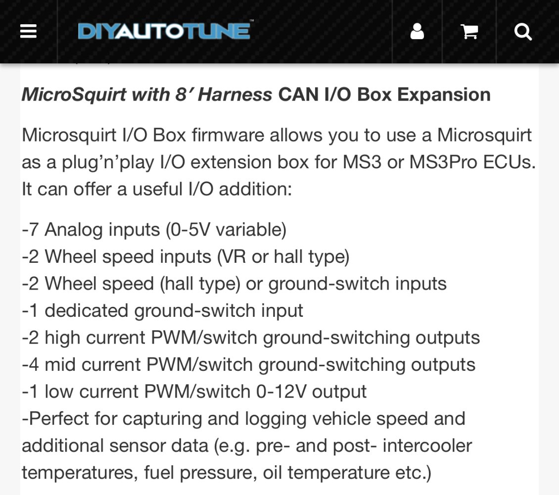

Microsquirt...
Not sure Microsquirt would help as the instrument cluster relies on the engine computer for a lot of its display data in 2004-2011
So basically a dead dash without the factory PCM(engine computer)

You think this would have capability?

No
Microsquirt and other EFI units run just the fuel system and sometimes spark
The issue on the 2004-2011 Rangers is the Digital Cluster interface, also digital Module interfaces
Running the engine is the easy part, its the digital interface with the rest of the vehicle thats the hard part in 2004-2011 Rangers
2003 and earlier Rangers were analog, vehicle systems and engine computer had very little communications
And if you stick with an automatic trans you also need a controller for that if you don't use factory PCM for that model trans
