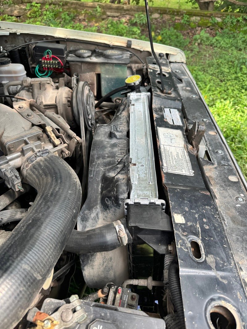

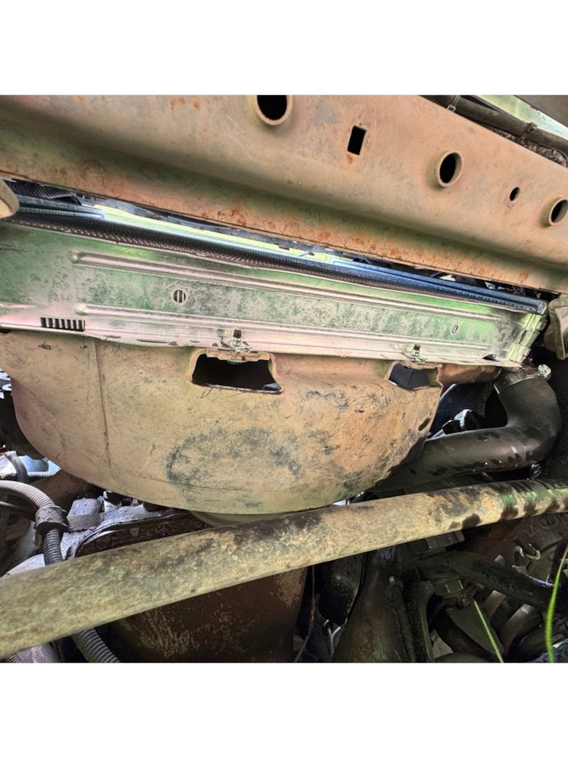

Final update here:
Pretty much a direct bolt on install with the parts mentioned above. Upper radiator hose is pretty dang close to my alternator, but clears. Lower hose was a piece of cake.
Flushed the system today and immediately tested it in gridlocked highway traffic, it was 103°F in Colorado today and the truck did not even creep above the midway point on the stock gauge.
I spent a couple hours with a pair of tweezers getting the fins on both sides of the radiator nice and straight, and was shocked to see how much thicker it actually is than stock… the stock radiator looks pathetic compared to this.
Pressure tested and not seeing any leaks, successful install and honestly the only work I have done on this truck so far which has been easy!

Upgraded my radiator to an auto explorer unit today.
Only modification was using bolts to secure the bottom of the fan shroud to the radiator (previously the shroud slid into clips, which no longer lined up).
Pretty pleased with how it came out.
with that radiator....you don't even need the shroud
With that radiator on a 2.9, you might not even need the fan. LOL
