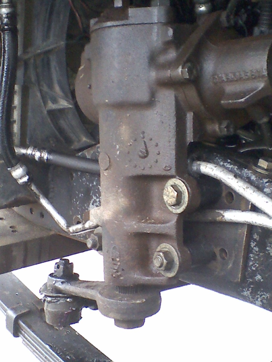

one of my rbvs is equipped with a 6.x gm diesel from a humvee application...so its big block in size. this directly demands the box be relocated. initially i had a saginaw slung low and forward as typical for a big block swap, which works with the factory ttb as well...but not as the inside rail jeep box ....but i elected to use a g30 radiator after heating up the unit with my standard sbf swap radiator which required the real estate the saginaw box was using.
so i went to this fullsize 79 type ford bronco/f150 4x4 setup. works perfect. the spacers are modified ford f-150 97-2004 style standard steering box spacers to set the box in the correct position.. you need to make a insert plate of course for the inside but that is what it takes.
