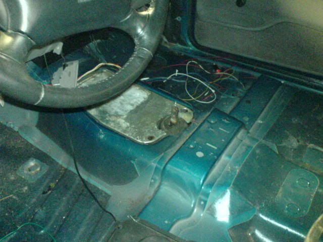

Found the pats mod Y'all saved my life in that one got the motor out looking for a m5od now I would go with the t5 but I don't want to maby cut my floor any one around nc have a trans and fly wheel
Here is the massive cut needed when running a Mustang T5: :)
