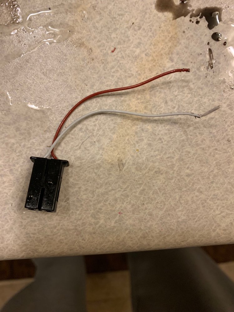

TLDR: What does the 2 wire connector in the picture go to and how much will it suck to reconnect it??

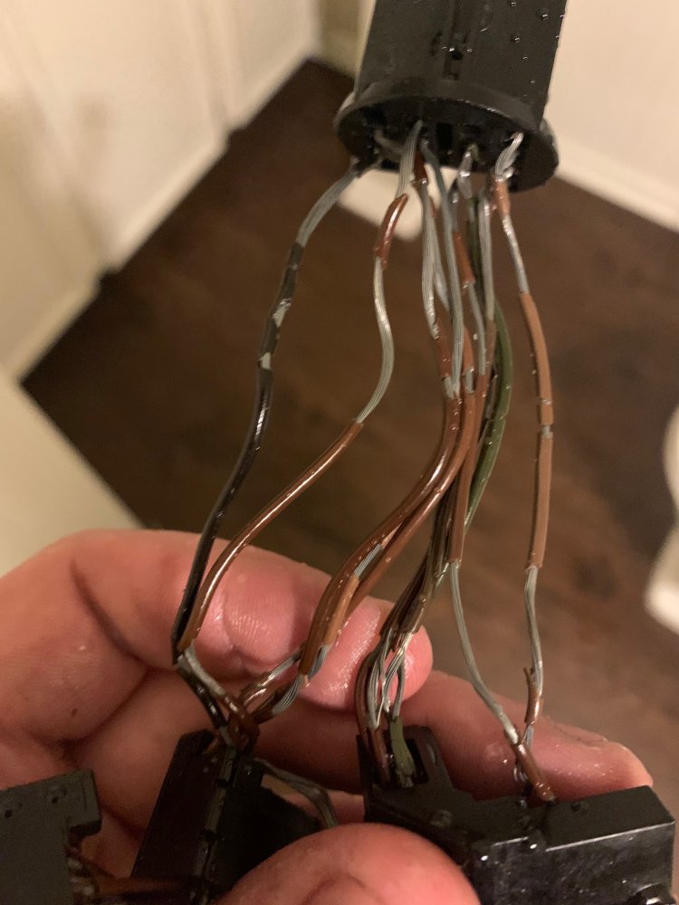

I have a 150K+ miles 1996 Ford Ranger, Automatic and I've had issues with the transmission. I only paid $1000 for the whole truck so a rebuild kinda ruins my investment costs. I am trying to see if I can solve it on my own. I dropped the pan with plans to replace the solenoids (It's throwing a TCC Error Code P0743) and I found my wiring harness was stripped almost completely bare (see pictures). I am hoping this is what is causing my transmission issues (slipping going into 3rd, and recently just dies when I put it in gear) but more so it's a cheap part to fix and I always start with the cheap stuff.
My problem here is not the hardness, that's a $35 part and it's already ordered, the problem is the tiny 2 wire connector that connects in the same ring as the solenoid harness. (Picture attached) The damn thing had 2 wires going off into some hole behind everything and I can't figure out what the hell it went to. I REALLY don't want to start tearing the valve body out and ripping my transmission apart just to learn it controls something stupid.
Please let me know if you know what this connector is for and how much of a pain it'll be to reconnect. It's hard to tell in the picture but the colors are a dark red or dark orange and solid white.
Did you cut those wires? And are you asking how hard it will be to reconnect them to the other cut ends? Without seeing the ends you need to connect them to and how much wire you have to work with, it’s pretty hard to tell.
The best repair, other than complete replacement, would be to strip them back, twist together, solder and cover with heat shrink. But if the other ends are cut short, that will be difficult, to say the least.
Concerning what that connector goes to, I’m sure it isn’t “something stupid”. They don’t tend to put frivolous nonsense inside transmissions.

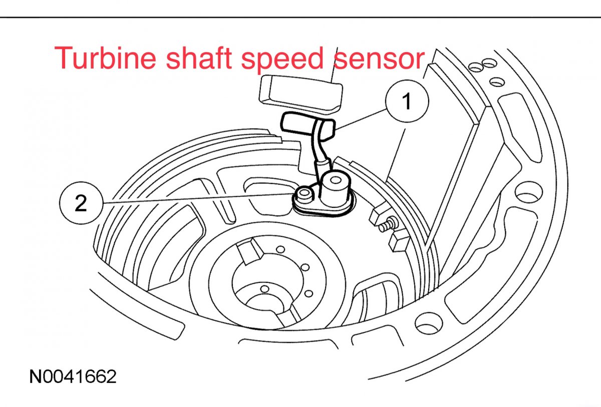

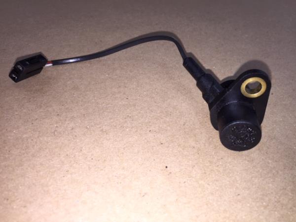

Mystery plug it for the turbine shaft speed sensor. Unfortunately the transmission has to come out and be partially disassembled to replace. Transmission will not function properly without it. Wish I had better news for you.
Brad
