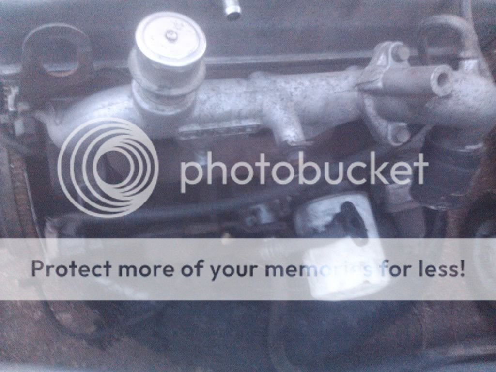

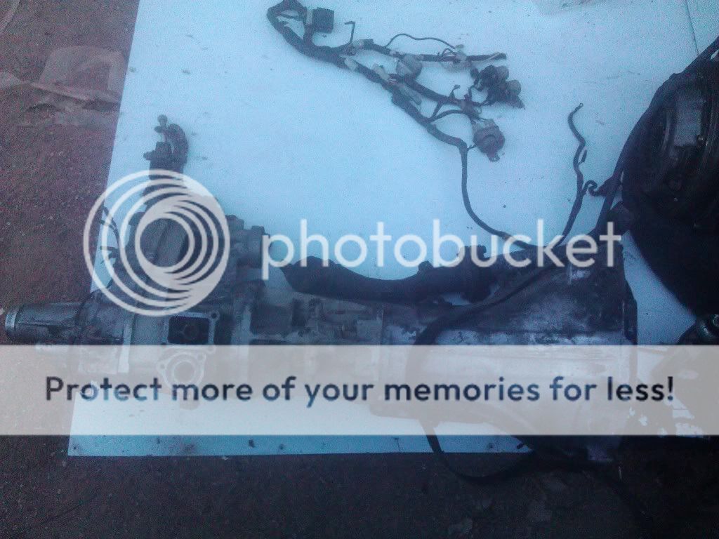

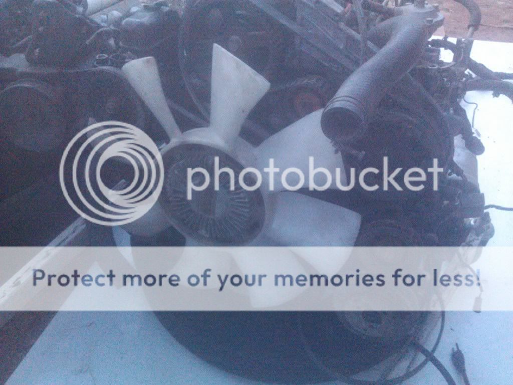

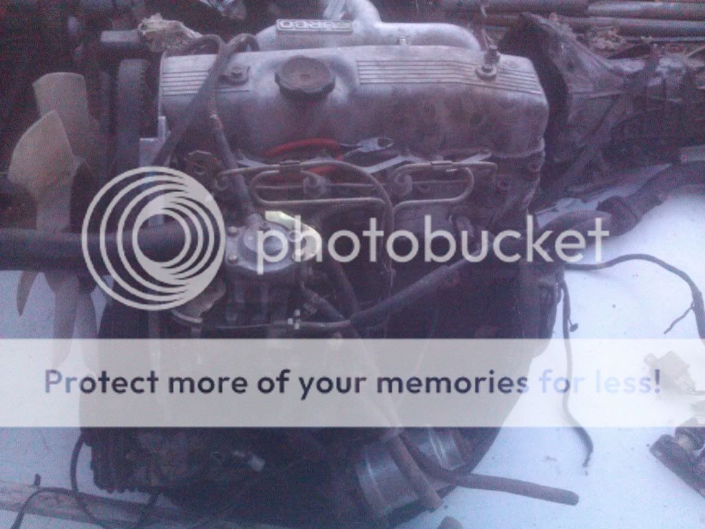

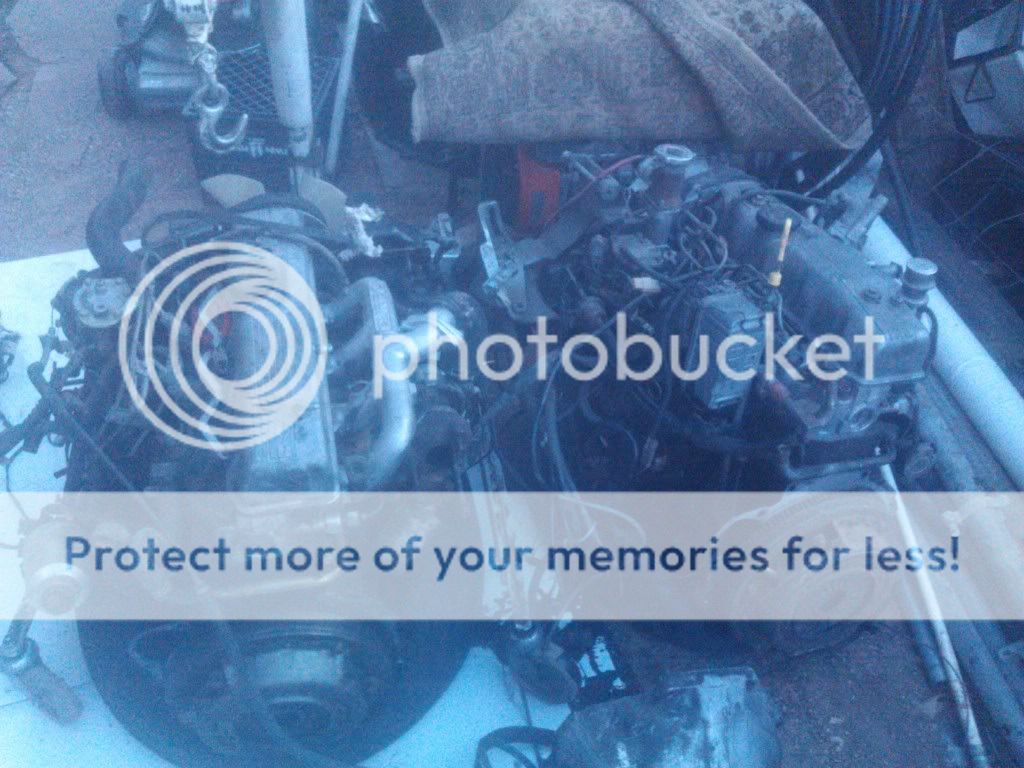

well i wound up getting the both of them. :thefinger::yahoo: one (left) came from a ram 50 and runs but dont sound good haha has welded rocker arms and 2 rods hahaha and the other (right) out of a ranger runs perfect maybe new crank bearrings things like that before it goes in... then theres the fm145, transfer case, harness x2, and a box of random goodies for um got a bad ass inner cooler too but didnt get a pic

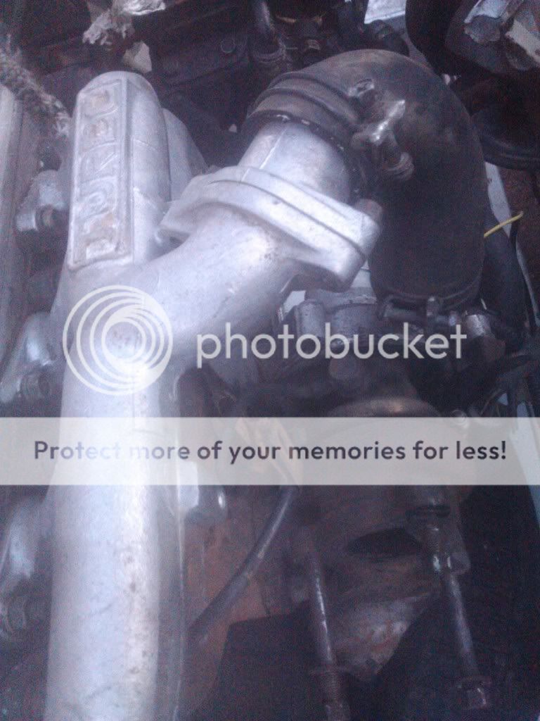

Intake on the ranger (top) one is a little different than the ram one... but it is supposed to be turboed also...

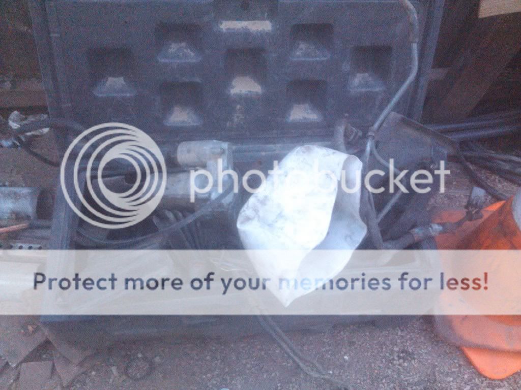

Also the ram one has a much different fuel pump/ filter setup from the ranger one
(Ram)

starters, shifters, pully covers, more wiring, ect. ect.

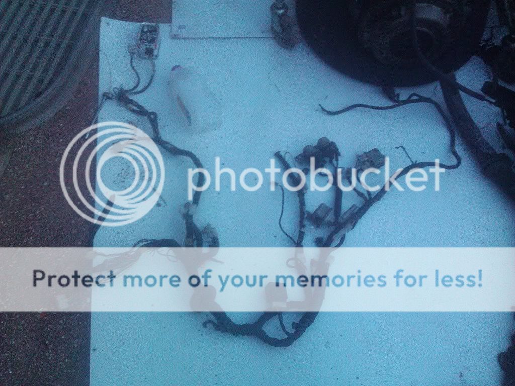

Harness... have 2 of um.

They both also have the motor mounts on them.
