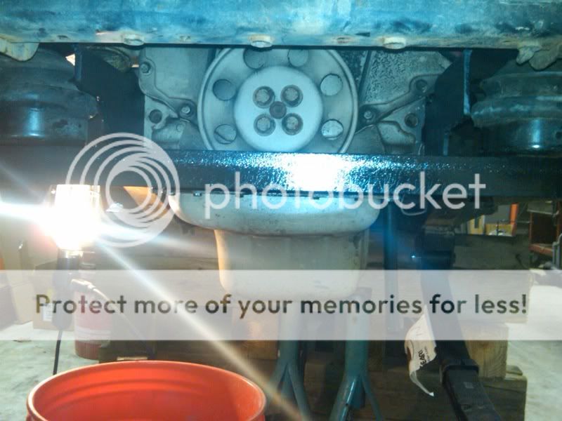

new motor mount brackets & isolators.

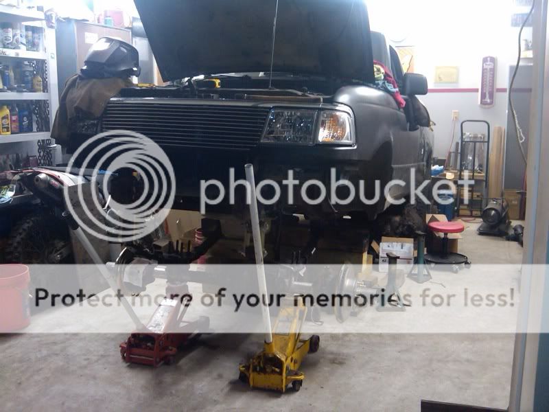

Ride height- Head lights are at chest level....

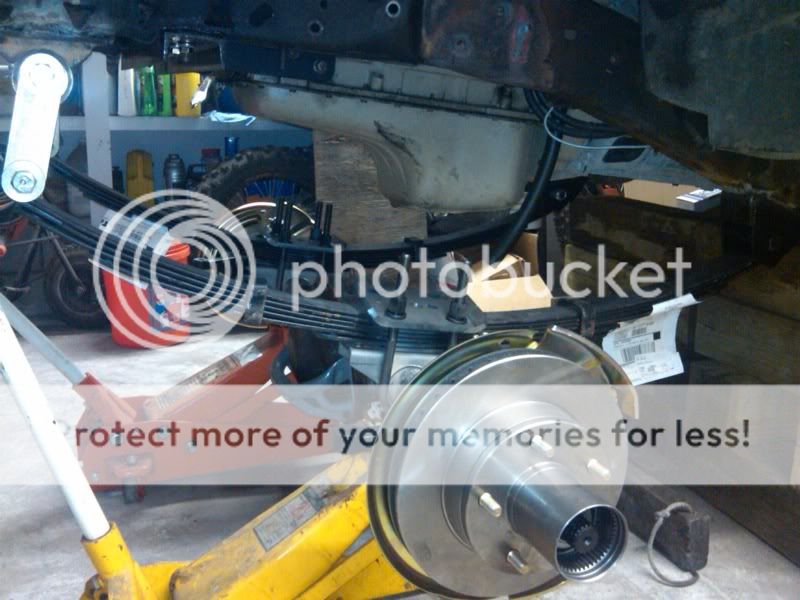

yes im missing a U-bolt, wasnt big enough to fit over the diff
ordered new radiator get a little better flow, and have to make a new t-stat housing bc the old one that points down leads right into my motor mount bracket. next step is removal of stock gas tank and get the t-case mocked in place to ensure front pinion is set before final welding the perches and spring mounts.
still not sure what im going to do for track bar...as you can see in the pic its way to much room under there height vs. width to fit one. probably do a coil over style shock and have them valved a little stiffer, maybe that will work?
