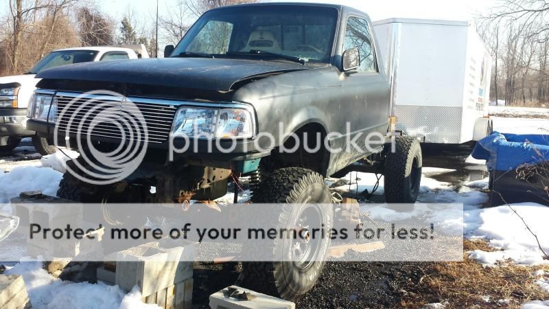

4BT '94 Ranger & EB D44 SAS (no56k)
I have the pump turned up a little at the moment, once the suspension is done and I have it back I have an HE341 laying around to go on it. Just need to pick up a new lift pump and some 50hp injectors. But that will be after my powerstroke gets new injectors, O rings or cups just started to leak oil :annoyed:
Can I get a parts list please?, bought a 91 just to do this swap!
well I know I need a 4bt, but is there a best year range for the engine? also what size lift is best to clear the oil pan from the diff?, what about the tranny, im hearing a lot about the m5od? is that the best option to go with?, any help is appreciated thx
Anyone you can get for a decent price in good shape, they stopped making them in 04/05 I think. I had an M5 and it did fine at stock/pump mods only, but while its at the shop getting the suspension work done I am having a ZF-5 put in. (more power in future) As for oil pan, a lot of guys just notch out the pan to clear the diff then add it in somewhere else to make up the difference.

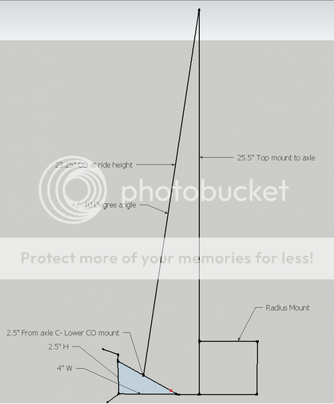

Well after a long ass time, the front is mocked up. Just need to measure out the ride length height and figure out where the bottom coil over mount is going to end up. I am thinking of running plate from the C on an angle down like 4" into the axle tube and mount it closer to the C with tabs...Hoping that would leave room for a track bar mount. This would put the coil overs 0 degree F/B and about 10 degrees kicked out. opinions?!

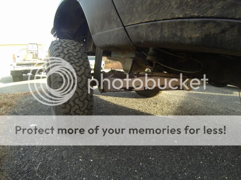

As for the rear it is set in place just need a few gussets and final welds.

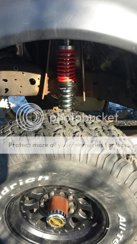

The never ending project...... its back on all 4! Need to adjust the rates, not sure if the springs needs to be replaced or not. Really not happy with FOA, I charged the shocks and came back to the truck about 2 weeks later and found a puddle of oil on my floor! Shaft seal is shot.

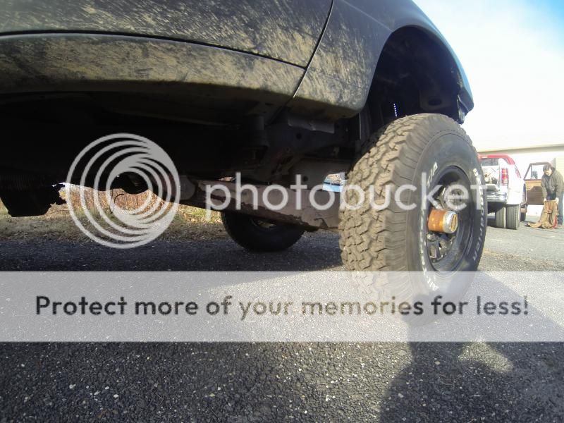

King Pin D60 - GM 14 Bolt.
Going to need to swap out the gearing for something a little more diesel friendly. Bought them fully rebuilt with 5.38s
So out with the old, pictured above...and in with the new!
Also swapping in a ZF-5 and a 203/205 doubler.
