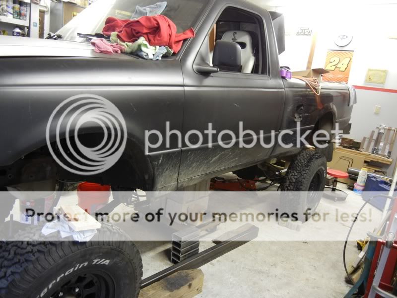

4BT '94 Ranger & EB D44 SAS (no56k)

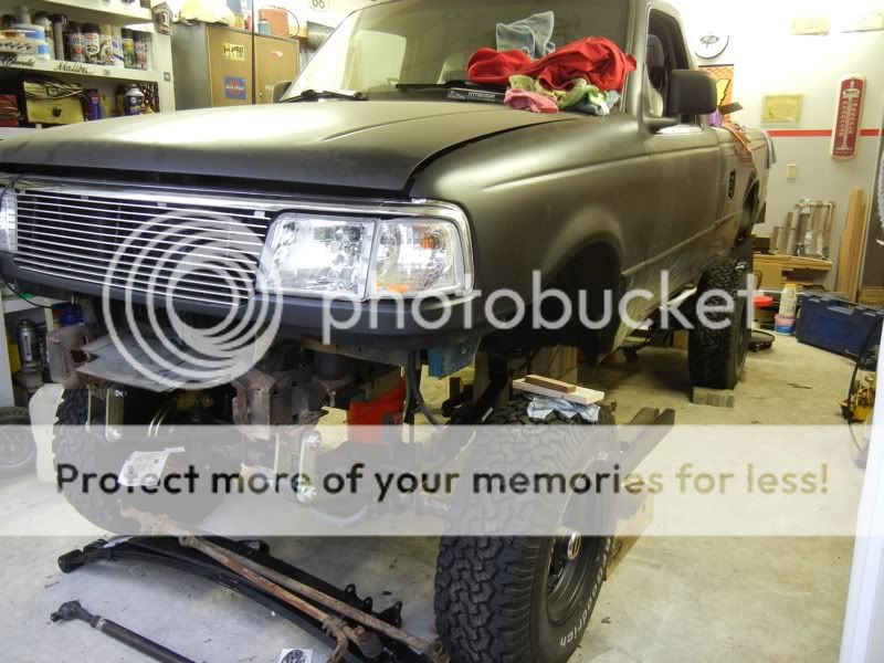

Ride height- Head lights are at chest level....

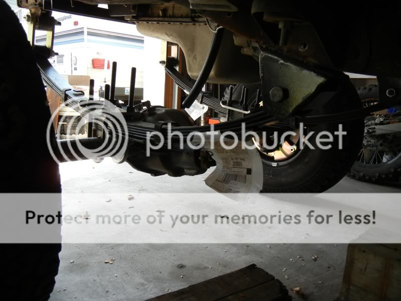

yes im missing a U-bolt, wasnt big enough to fit over the diff

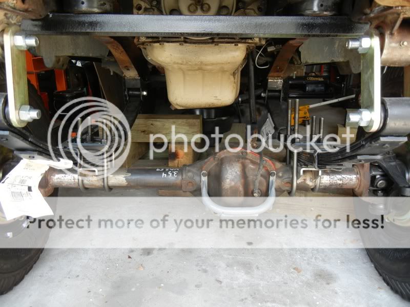

ordered new radiator get a little better flow, and have to make a new t-stat housing bc the old one that points down leads right into my motor mount bracket. next step is removal of stock gas tank and get the t-case mocked in place to ensure front pinion is set before final welding the perches and spring mounts.

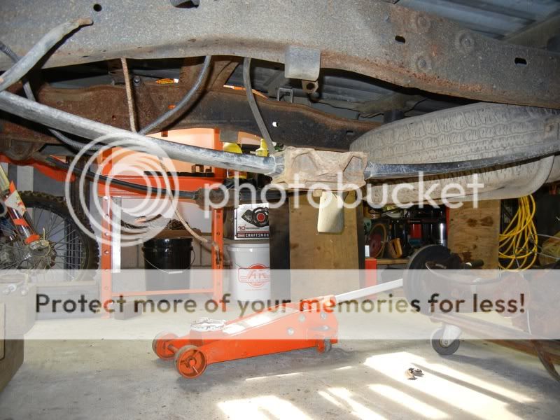

still not sure what im going to do for track bar...as you can see in the pic its way to much room under there height vs. width to fit one. probably do a coil over style shock and have them valved a little stiffer, maybe that will work?

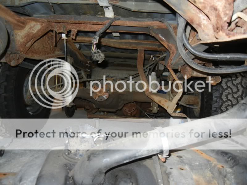

i was going with coilovers, but the company i was going to purchase from had a warehouse fire and everything was lost...soo thats when i decided to go leaf. as for the reamer, i havent had a chance to get the front axle out to ream them out :sad: only thing that has changed since beginning of march is the rear is all out. and the front is all tacked in sitting on tires.
more pics of to where i am at;

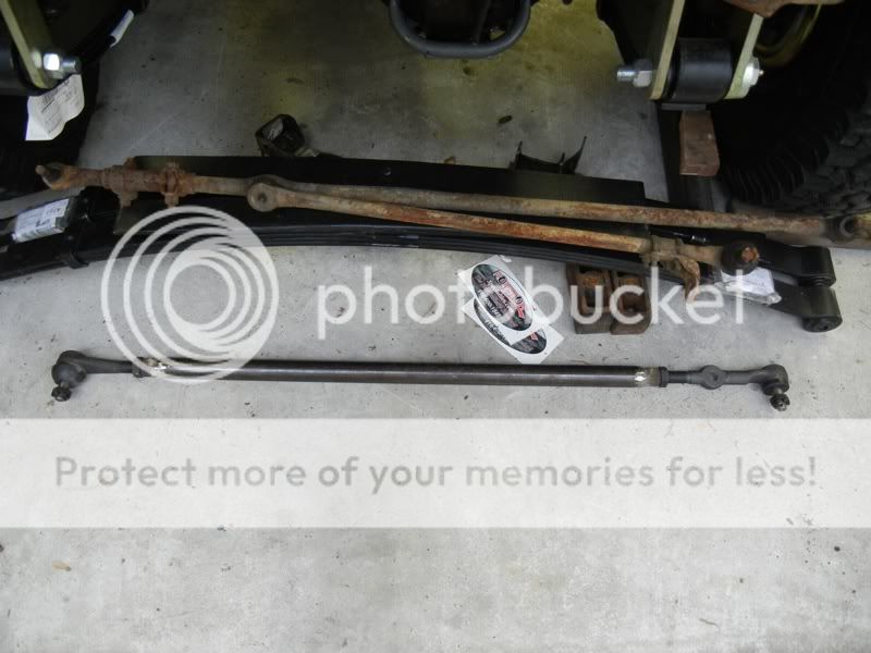

got the GM 1 ton TRE and got 1 made up
old next to new

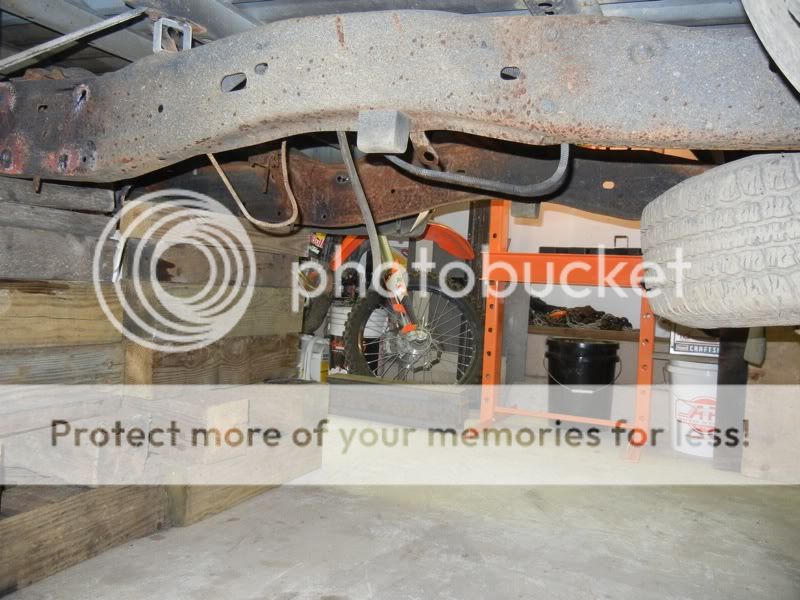

this will be ride height

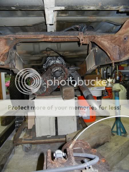

t-case blocked to its almost final position

going to cut the brackets for rear springs this week, axle is currently just sitting in place. Along with that i will have the 2 crossmembers for the t-case cut and hopefully welded in this week, so i can finally mount the t-case. using 2"x4" 3/16" rect. tube for the crossmembers, and same for the 2 existing crossmembers down near the rear axle. also going to box the frame fully.

What is HP rating on that 4bt?
What transmission did you use?
Is that a 205 t case?
105 or 120 depending on pump
M5R2 '97 f150
yes ford divorced style
So you used a 2wd f150 trans then?
Yes he did. His truck started life as a 2wd.
yea, i could of swapped but i bought the trans new n got a good deal on it. then found the tcase out in pa for reasonable price so i snagged it instead of running a married setup. trying to get the thing mounted by end of the week, just hoping work stays calm n it actually happens....been saying it for 3 weeks now lol
